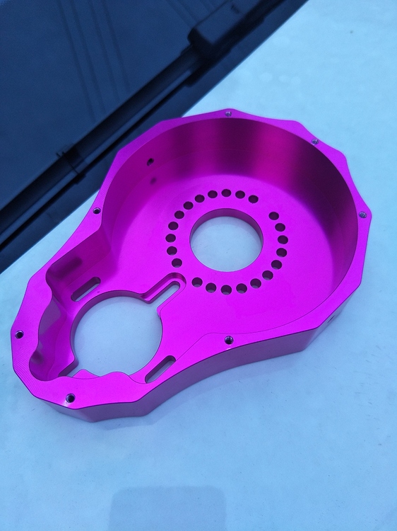

I think they do fit the moon drives, but they would be inside the gear drive enclosure.
TBH I’m not entirely sure how the moon drive assembles.
Also, the moon drives have holes and not slots, making aesthetic alignment difficult.
The drives could be out of alignment by as much as 15 degrees.
I’ll dry fit mine and see how it would need to assemble.
Im thinking an extra mm or so washer on the axle could help with that though no?
Thanks homie :+1::pray:
possibly.
the pitch of the M8 thread is 1.25, so every degree turned equates to a 0.0035mm shim. a 0.0525mm shim equate to 15 degrees of spin.
So, thinking about the indexing faces inside the hanger relative to this problem shows that I need to return to six faces instead of five.
360/6=60, nice number
vs
360/5=72, yucky number
Most hole patterns in motor mounts are base12 instead of base10. If you choose to use the axle indexes to align the plates then since the hole patterns in the axles are symmetric about the long axis of the axle it makes sense that the indexes follow that same pattern.
Thanks for making me think about this.
Not even gonna lie, that was a high thought I had. If it works than that’d be awesome.

Just a comment, don’t go with 304 stainless, it will break, the yield strength is way to low even with temper and heat treatment for this use, for structural parts go 17-4, if you want to make a frying pan go 304 :grin:
