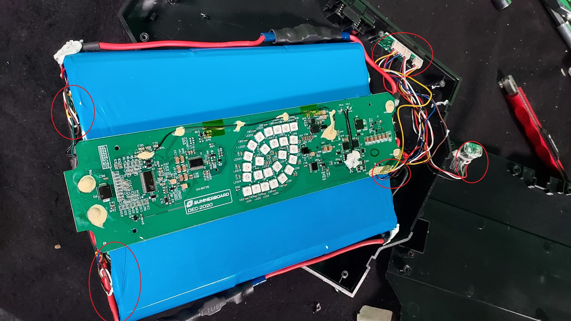

I also have a SBX wit faulty battery here. bought is used…
Now I like to repair it in a easy way.
Your solution, to use 2 Lipos and cut them into the case is just cool as f*ck!!!
:+1:
Maybe this will be my evening project today :slight_smile:
Do you have any tips what I should take care of? Or is it just as straightforward as it looks?
Did you remove all the original pcb electronics in the battery case?
Only connected the battery to the mains?
Or do I need to shorten any of those wires? (red circles in the image)
thx
Not trying to answer but I am pretty sure all the battery PCBs and wiring goes in the trash (or keep like me the hoarder of old parts)

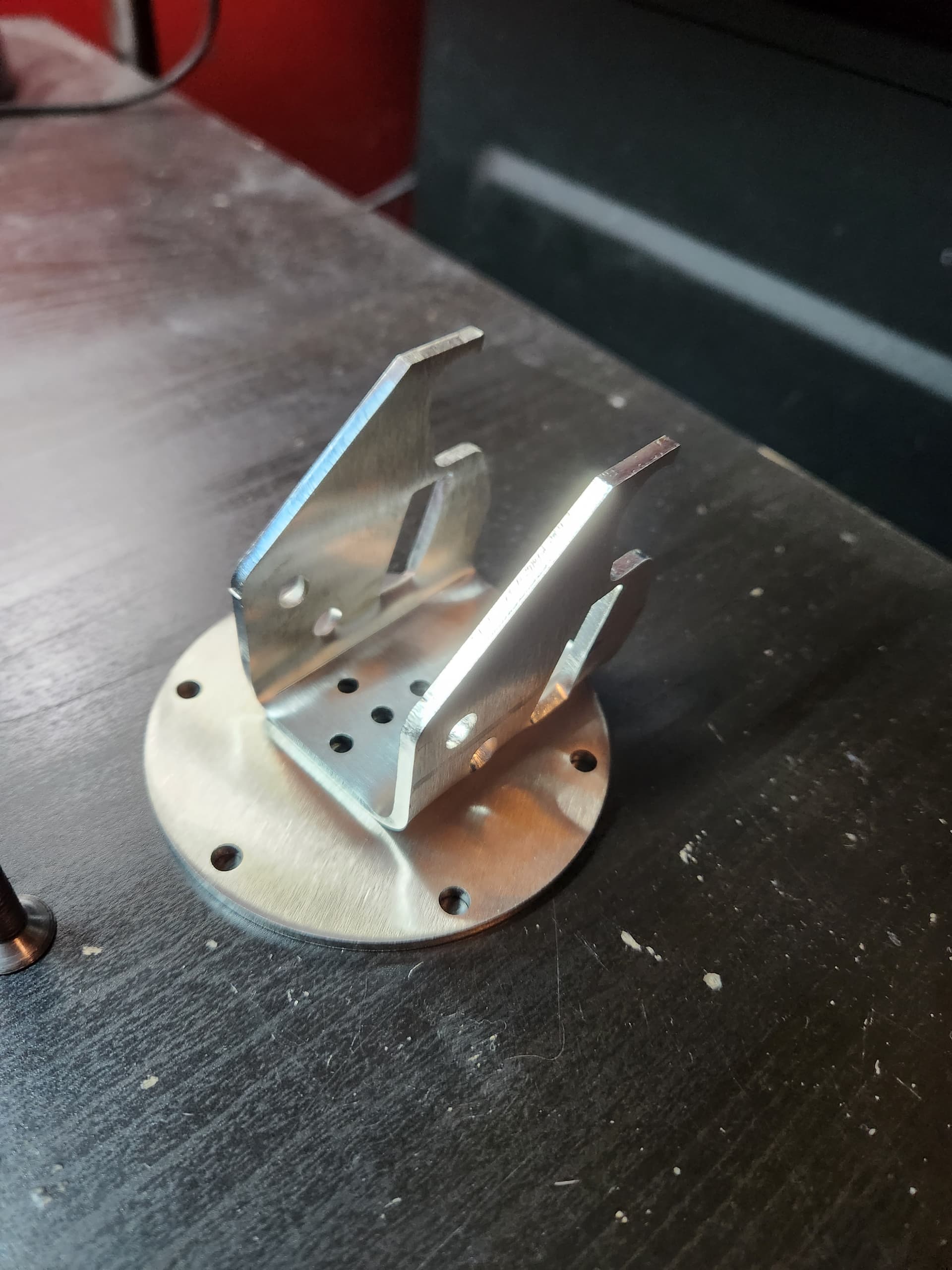

I was curious to know how much it costed him to CNC them. I am designing my own replacement for the V2 casters as a test to see how practical it is to use sendcutsend as a manufacturer service.
The Fork will be made from 3.1mm sheet of 316 stainless and bend into shape.
Disk will be aluminum or plastic and it will be screwed onto the fork with gub screws.
The bearing spacer could possibly be 3d printed for cheap.
the long Spacer that goes through the bearing will either be 3d printed or made from aluminum.
The bottom washer will be leftover from the V2.
The hole assembly will be screwed together with one long screw. I am still debating on if Ill used a nut or make the fork threaded.
I just got my first parts today and they look nice! they were there’s some dimensions that are wrong so I need to make some slight offsets(needed to hammer them together since tolerances were to tight). Major problem was that I somehow fucked up on the instructions and the entire model ended up wider by like 7mm with made it unusable. Not bad for $41 tho.
If this works then Ill open source the CAD for it so others can use it to fix their V2’s. Then Ill design one for the SBX with the stock slipring and baseplate so people can add larger motors and different wheels/gearing. Then Ill look into getting my own custom sliprings build that Ill use with the Otherbord M1 caster. Hopefully at the end of this Ill have a fully customizable ecaster that will work with almost any combo of gearing/motors/wheels. This is gonna be fun. I’m excided.

Yep just remove all and connect to the main connector of the battery case.
