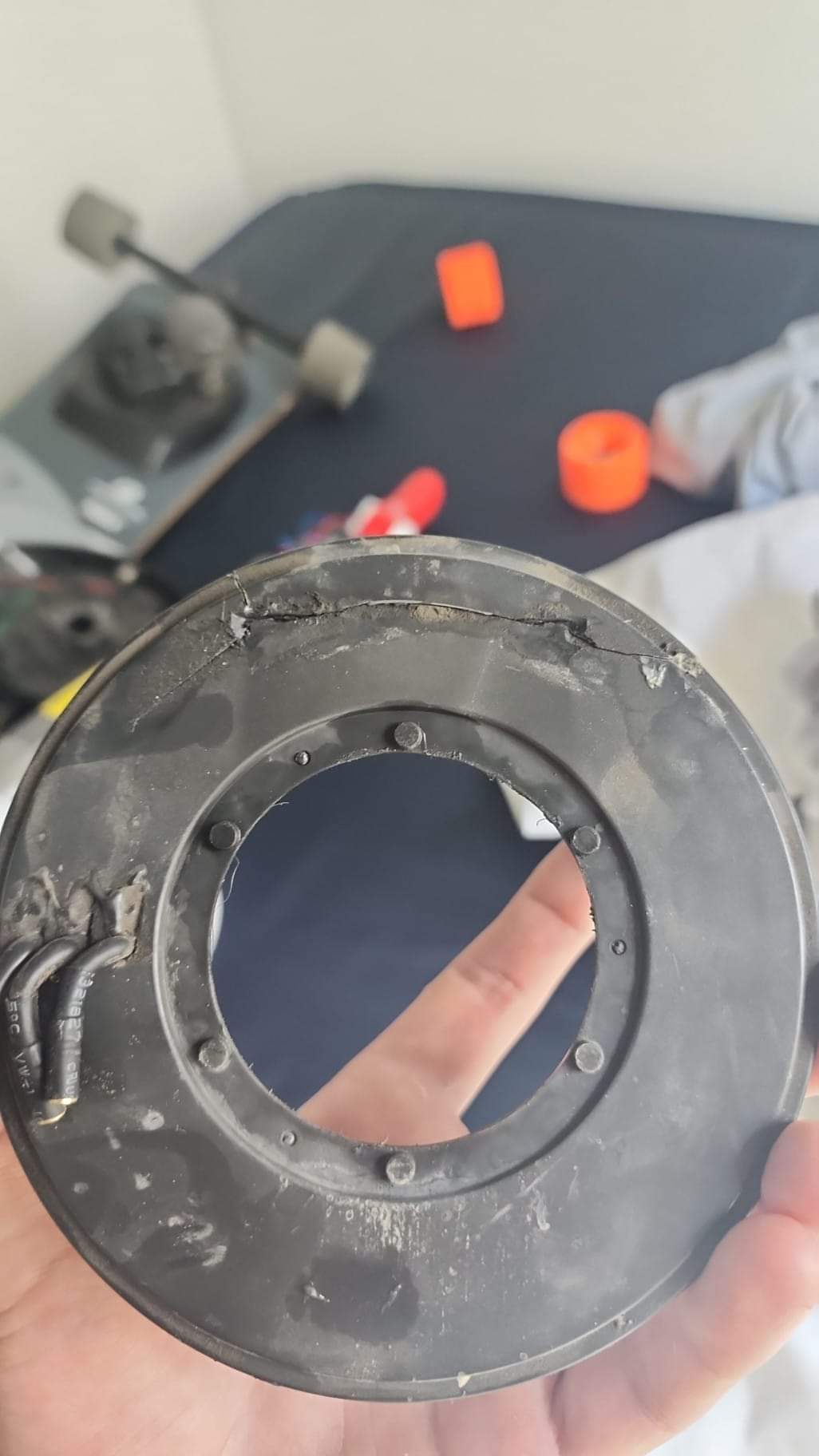

I was going to try to epoxy it today, as its been a month after paying them and ive yet to get any sort of shipping confirmation. I looked deeper into my summerboard base after i saw someone having a similar problem on fb, but they broke their base too. Seems that my base also broke… i dont even want to think about how much money im gonna give Aaron for this…
old price was $30 a pair for the plastic castor bases I think so prob more now.
Not that they will sell me any.
Yeah you have to constantly ask them but they will send them eventually.
I got them to sell me new base and ubrackets.

Got them to send me 2 new bases, and and 2 extra disc.
Basically by the end of fixing the summerboard, ill have a working and broken pair of discs and bases.
Im thinking it might be possible to develop a different bearing system, and epoxy the disc. This might make it so i could make new casters. I have access to a CNC, but i might just try to print out the bearing housing with PETG. Id also need to create some new brackets. Has anyone played around with the casters to your knowledge?
