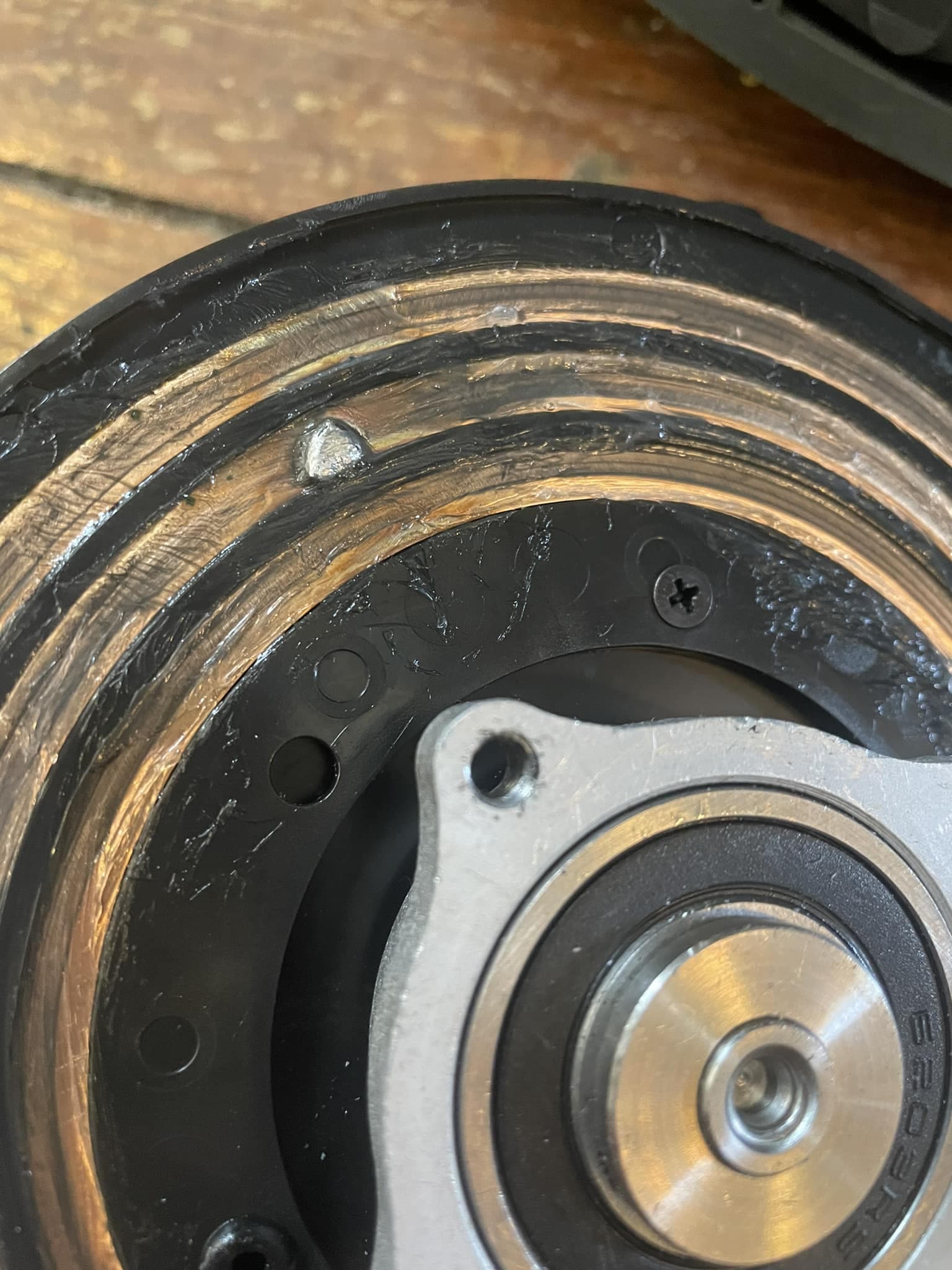

Person found this on first service.
I asked if this blob was from the motor wires soldered on the other side or what.
Also note the seemingly permanently installed bearing.

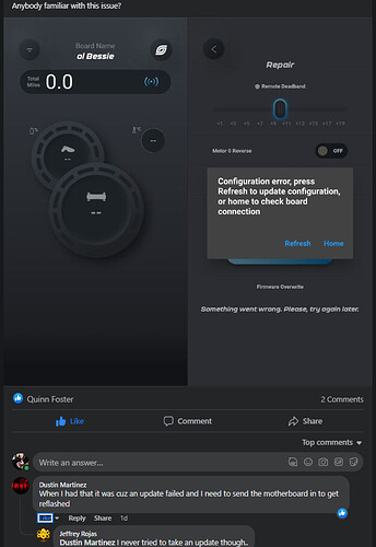

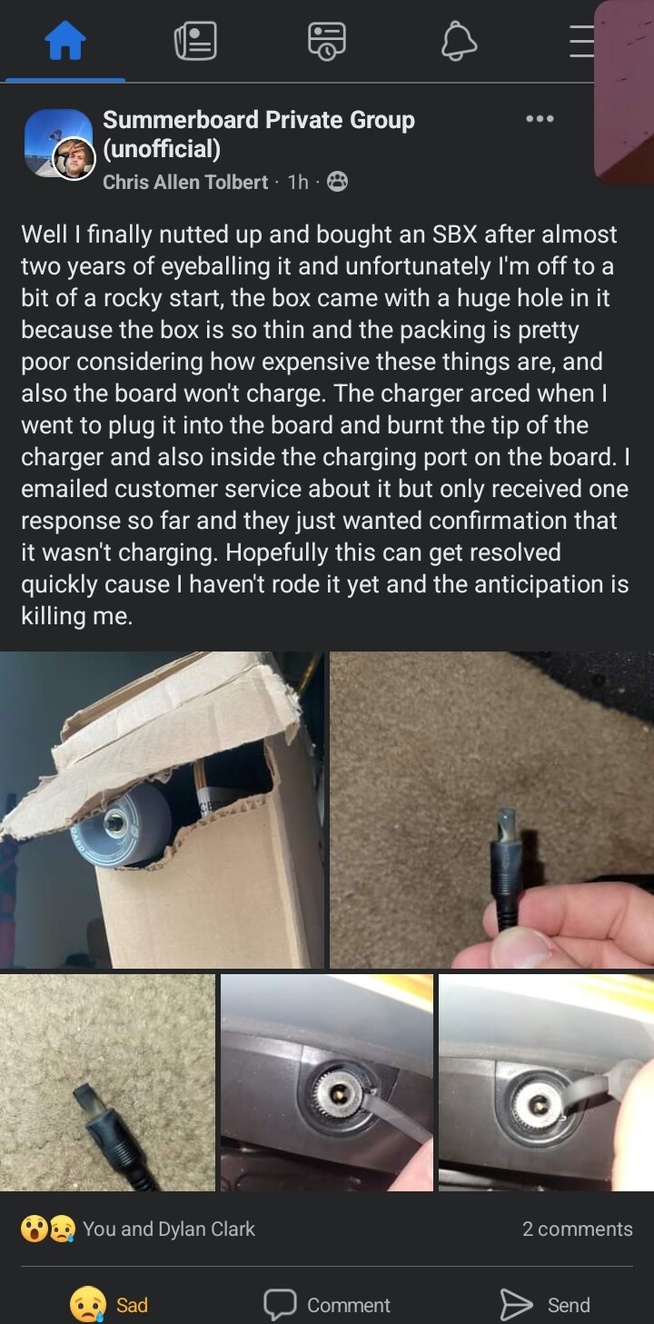

I’ve got a brand new battery but my board won’t power on & when it’s plugged in the charger light turns off. Planning to check the resistance on the power switch wires and charging port tonight. Has anyone else had this issue? Input appreciated

I just had that issue. I had to replace the motherboard at a cost of $317, and a month of pestering them to send it to me.
Fast forward another 3 weeks and my board won’t respond to the power button and only turns on when plugged in. Survey says bad BMS, but if that is the case then they sent me a bad battery as a spare because the problem is still there with the “brand new” battery.
