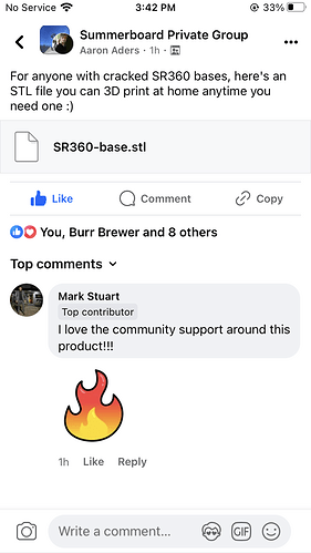

Wow!!! That’s great. Unfortunately the model is not really fit for printing in a decent orientation though. I asked him for a .step file lets see if he shares that too. Would be really cool!
I also tried Solidworks’ mesh to solid converter and that just crashed out the software :laughing:
And Fusion threw an error too in the ā€œusableā€ conversion type. I can make a solid by converting each triangle into a face, but then the software runs out of computation time for many features and keeps throwing errors
edit: aaron just said print it with supports and it’s gonna be fine, accuracy / decent finish is not needed there

Also the caster is still held together by superglue. I’ll eventually get to printing a replacement from the stl.
