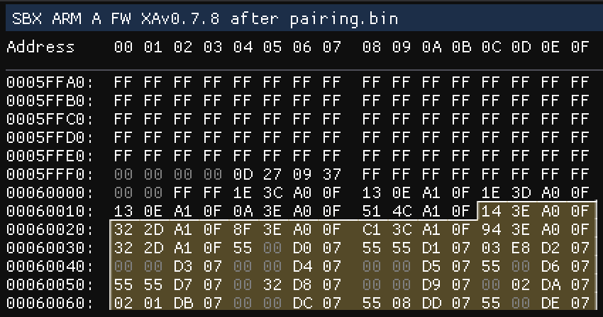

Based on the symptoms, I would think this means that your EEPROM has corrupted. Possibly voltage loss? Even in VESCTools itself I don’t see a way to erase the EEPROM and factory reset it.
If this were my board I would try to manually erase the EEPROM with an STLink.
http://amazon.com/st-link-v2/s?k=st-link+v2
GitHub - stlink-org/stlink: Open source STM32 MCU programming toolset
#Dump your entire STM32 contents
st-flash read dump.bin 0x8000000 0x100000
#Use a Hex Editor to write data 0xFF (erased) to addresses 0x60000 to 0x67FFF
#Flash erased EEPROM back onto STM32
st-flash write dump_w_eeprom_erased.bin 0x8000000
Just for reference this is why my EEPROM contents looks like:
Unfortunately I don’t know of an easier potential solution other than going in with an ST-Link.

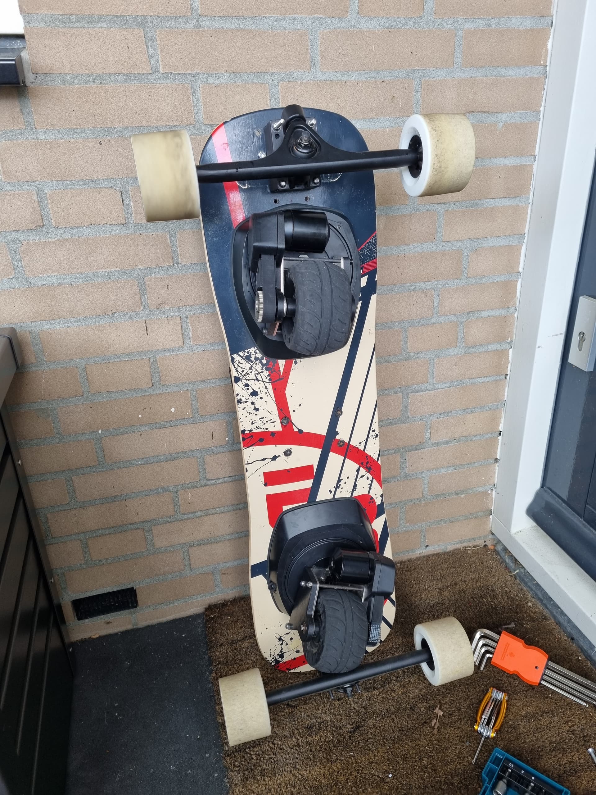

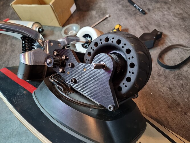

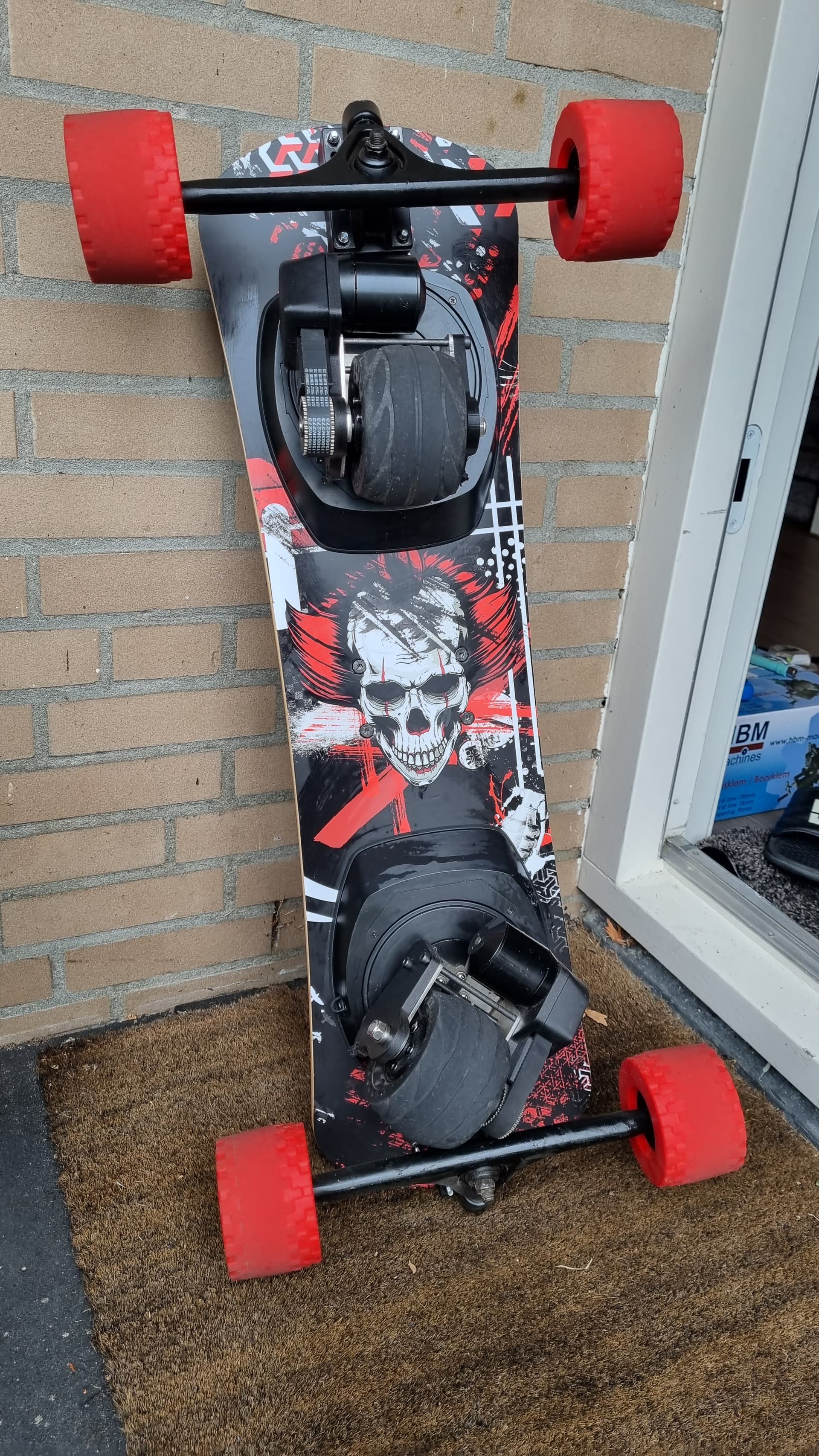

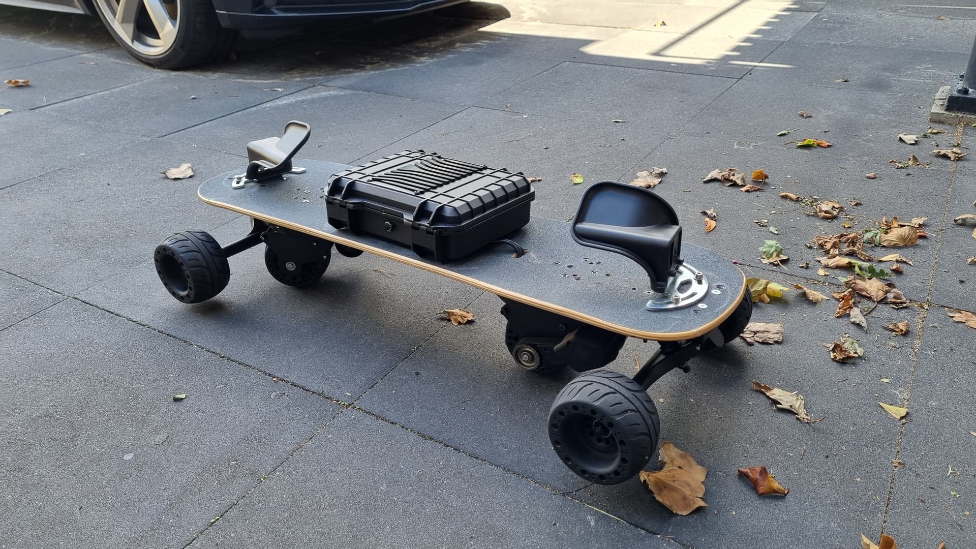

I’m working on a lowrider casterbase for my SB-XL (summerboard/ e-freebord with big wheels). For the ones that don’t know my build:

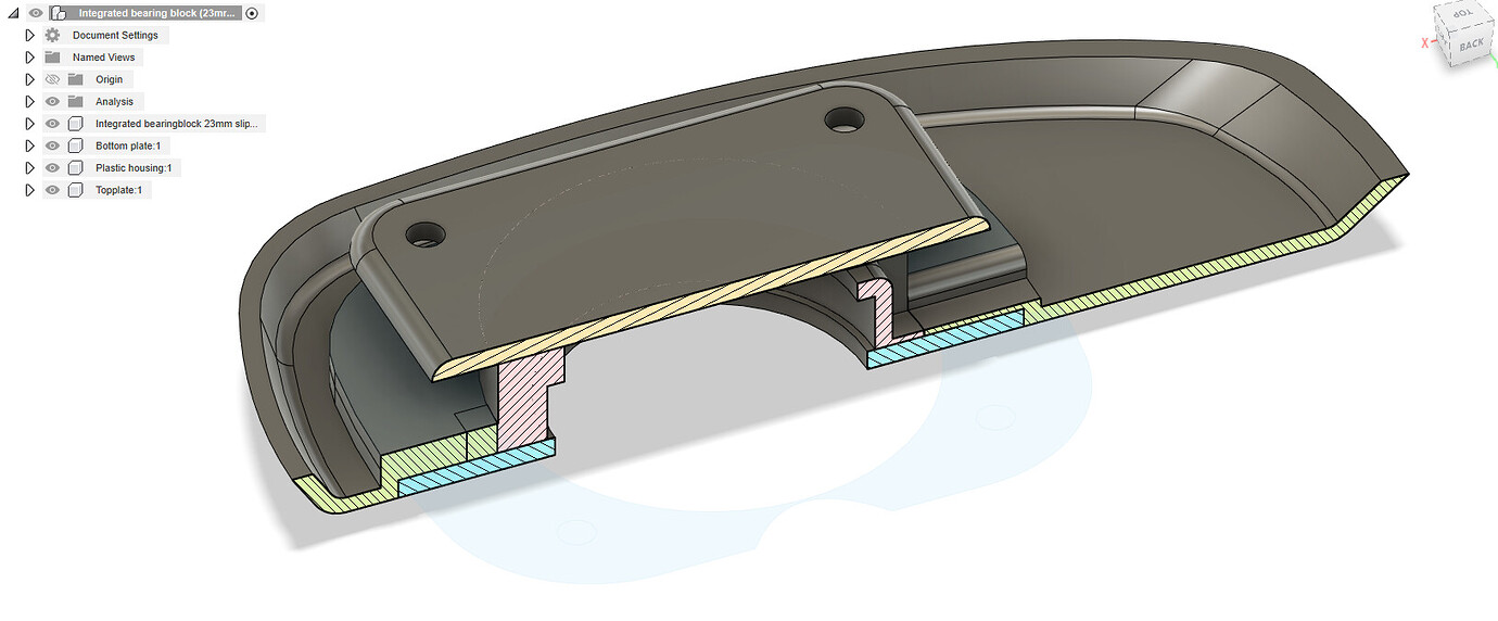

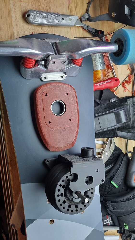

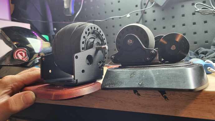

My last setup rides very well however I would like to get the center of gravity as low as possible in combination with the big wheels. To make this possible I’m designing a new casterbase to replace the SR360 that I’m using.

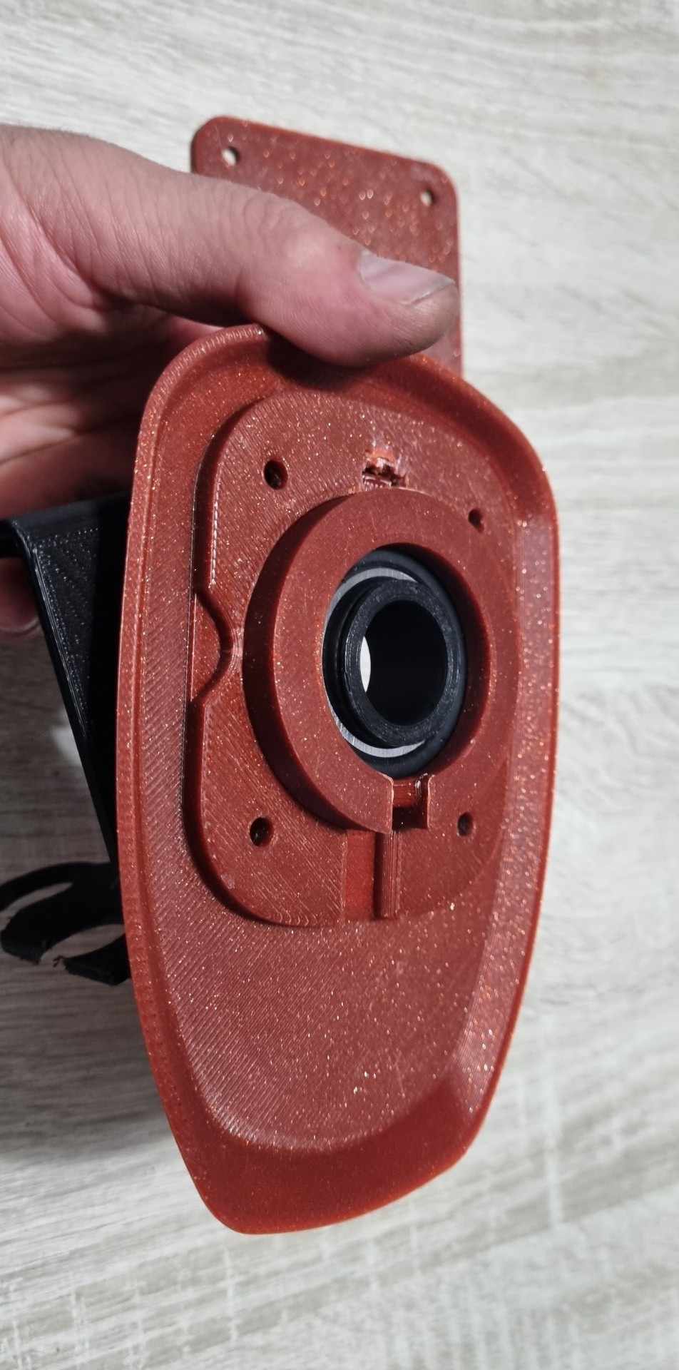

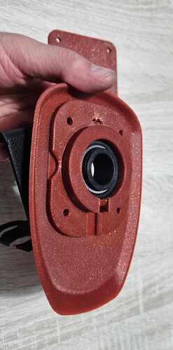

First print of the design to toy around with:
If I get it to work the riding height will be pretty much the same as a normal SBX.
The idea is to integrate the bearingblock in the deck of the board to save space.

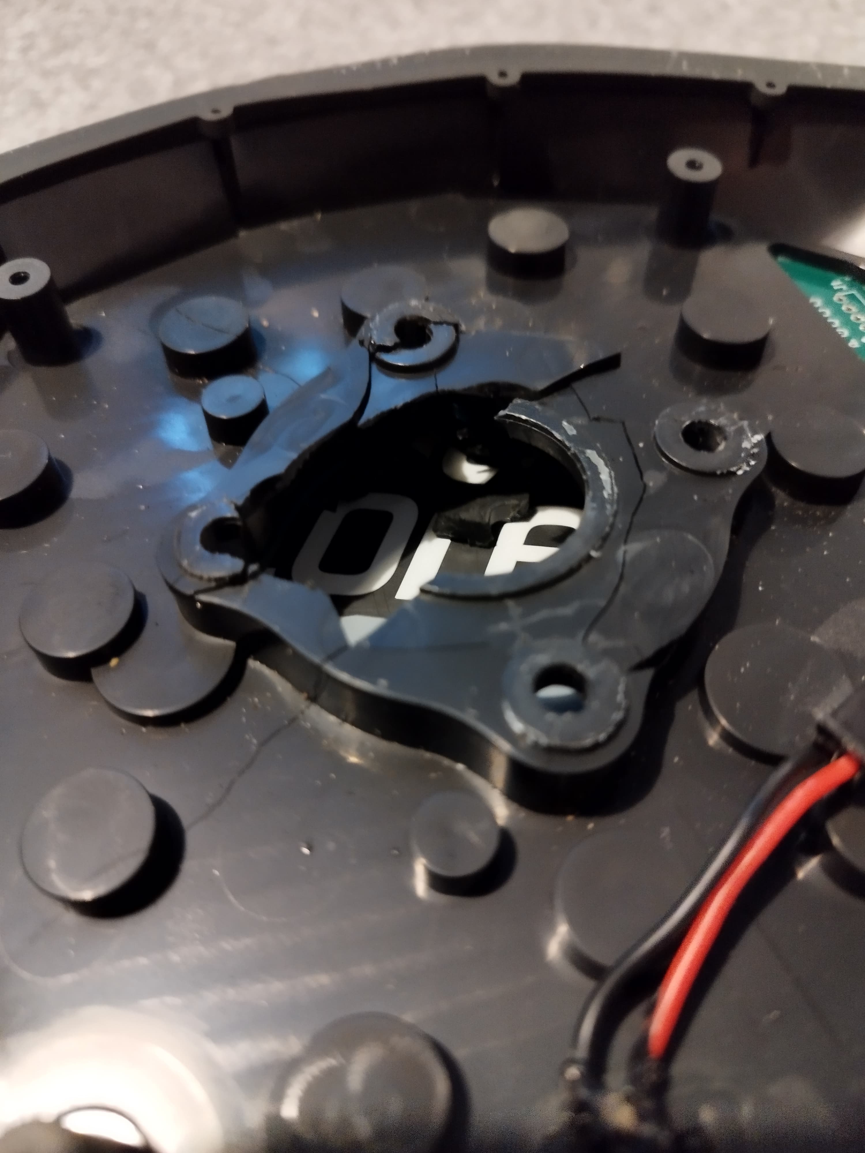

I just bought a used summerboard and while doing maintenance on it I noticed that the caster’s plastic base is badly cracked.
Does anyone have a .stl or (preferably) .step model for that? Maybe @Fosterqc you have a model?
Also does anyone know what bearings the caster wheel’s axle uses? I will need new ones soon and I don’t want to disassemble it just to check if it’s not necessary
Same as edge wheels. Just make sure to get bearing with a double sided seal. Single sealed bearing die fast.
Thanks, that’s perfect!
Hi, sorry that I can’t help you with that… I saw people fixing the broken base with epoxy and claming it was better after that. Coolest would be to DIY… other option is to contact summerboard and order new ones. They are not super expensive. Hope you get it fixed! :muscle::blush:
For now I just superglued all the pieces back together and reassembled it. I had a ride today like this and it seems to hold so far, but I don’t expect it to hold up long term.
I will DIY the replacements for sure. Ordering wouldn’t be ideal because shipping and taxes to the EU would be expensive for sure. I have the skills to 3d model and print a replacement part, but it’s a lot of work so I would wait until the weather becomes completely unusable before disassembling it for modeling. But if someone already has a file I would be grateful if I could skip all that design work

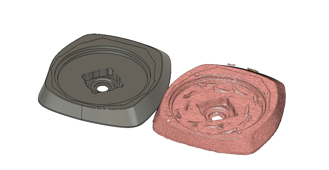

getting a good scan is it own kind of difficult trust me.
First attempt at scanning/modeling it. Ill likely try this again in the future. This model is basically a blind reconstruct from the scan. I didn’t doublecheck dimensions on anything. If you want to mess around with it or use it as a reference then feel free.
SBX Caster Shell v7.f3d (1.4 MB)
