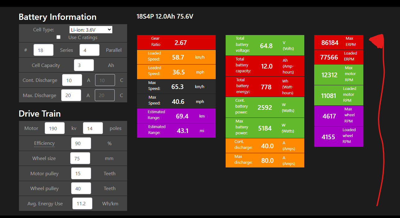

Well actually I forgot the SBX uses like ~190KV motors pretty sure.
So see here if you tried to max out the Stormcore at 18S or like 75V
Red arrow points to possibly dangerous number, almost 90K ERPM is a lot of trust to have.
honestly from looking at these guesswork numbers I think the sbx has higher than 190KV motors. Surely less than 220KV tho.
