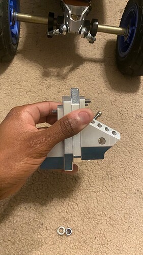

Brackets that allow for small changes in wheelbase would be ideal. Reversing the baseplate is too complicated. I want a bracket with multiple sets of holes that allow for about an 1.5" of adjustment on each side. The brackets that IdeaTB make are a good example of this.
I have been thinking about making the enclosure and the area where the trucks mount one piece. This is very similar to the carbon deck/enclosures out on the market today. The deck would mount on top, hand over the edges of the enclosure and would not be a critical structural component.
I would like the deck to be flat with the ability to take wings for those who want concave. May also have two different length decks to fit different people. A shorter deck can be combined with the adjustable brackets to make a shorter board. The other option is to make a shorter version but that could get pricey. My hope is an adjustable wheelbase between 39-42".
An adjustable angle foot ramp in the rear would be nice too. I am thinking about having a pivot at the base of the ramp and a way to get 3-4 different ramp angles.
The way i did my custom split angle brackets might be interesting to you then. Two adjustment options, bracket mounting position for wheelbase length, and truck mounting position for wheelbase length and ride height, a bit. These have something like 35-40mm of wheelbase adjustment each? Wouldnt be too difficult to combine these with an open carbon tub design for the enclosure and then a deck over top.
