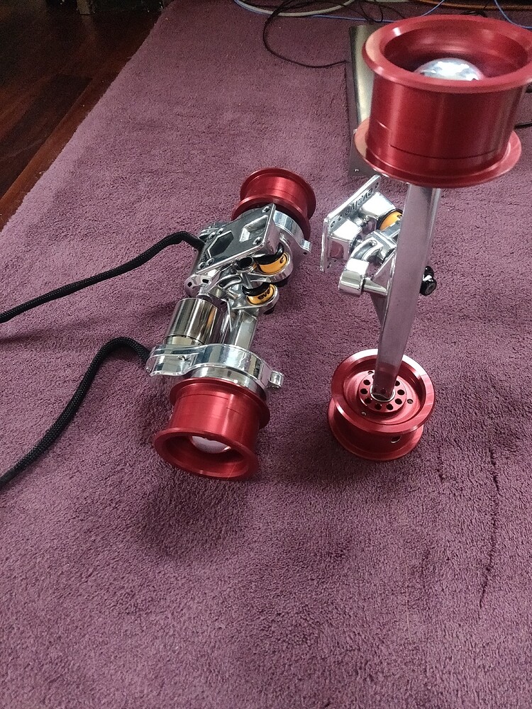

Ah oke. Could you make a pic for me of your board I am curious to see what the clearance is. Its hard to imagine it if you see the dimensions :slight_smile:. I like the clearance I currently have with the 218 trucks and I think getting more ground clearance would make it unstable.
The clearance depends on the deck and the wheels you are using. The trucks are nothing special and like any other DKP truck.

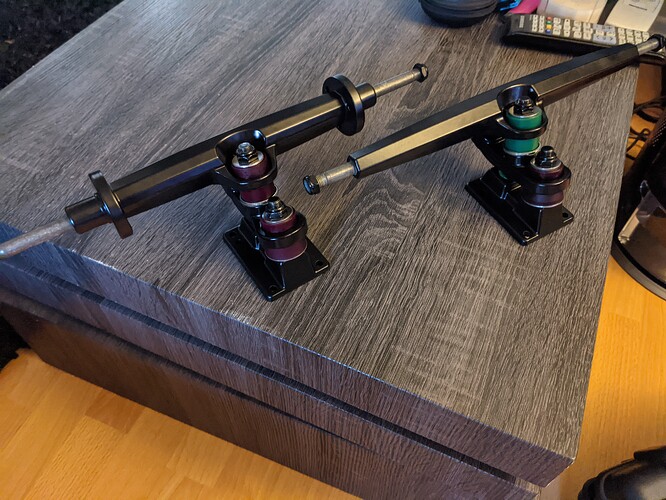

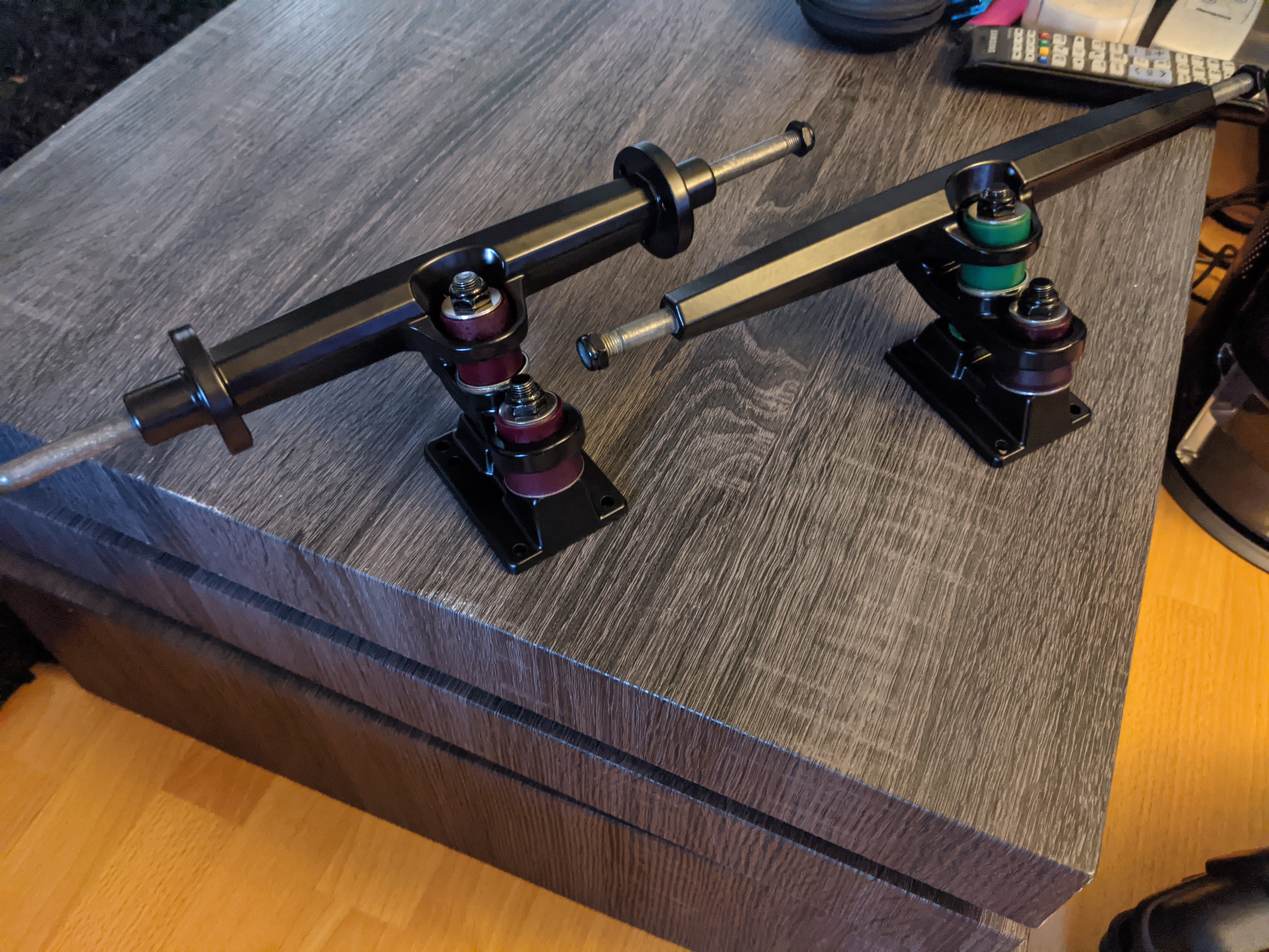

Finished a build using OP’s link to Flipsky DKP 13.75" trucks. Replaced the bushings and pivot cups with the Riptide DKP truck set. Turns real nice and is a great ride but at speeds around 30/mph and above you tend to get speed wobbles. I’m still experimenting around with tightening the trucks and I may get harder bushings, but overall I would recommend getting RKP trucks or something else for boards where you want more stability, especially at higher speeds. Happy with my build result but my next board build will not have DKP trucks lol.
Which kit version fits the trucks? What duro did you get and what do you weigh?
I used the Double Kingpin Bushing box for Evolve boards and it seems to fit perfectly. I chose 90/93 for my setup and it handles really well, but I’m thinking something stiffer might be better for me so I can push higher speeds more confidently. I weigh about 175lbs. Any recommendations? Love your stuff btw.
Can you post pictures of the front and back bushing stacks?

One change we found with the Onsra that worked really well was changing the front truck bottom Green KranK 90a to a 93a. PM me your address and I will send you one to try
Wow, thank you! I’ll make sure to update with my results once I give it a shot. Appreciate the help!
Update: After swapping out the barrel bushing on the front truck to a 93a and applying some tightening, ride stability at all speeds has greatly increased. Even with the stiffer trucks, the board still has good maneuverability and even at higher speeds I feel confident making agile moves to dodge all those fun hazards on the road.
