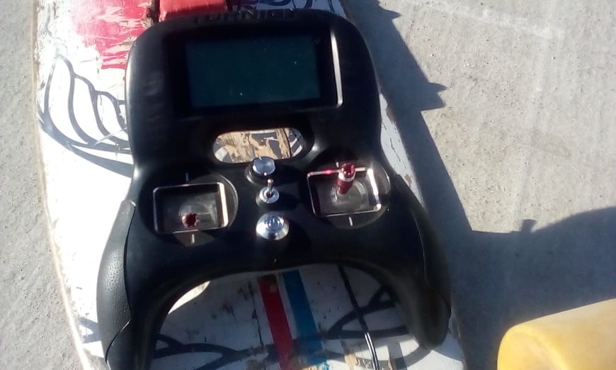

So in November 2021 with the help of the tools of my friend i began building, the GT2E did’nt work anymore, water damage presumably, dumb as i am threw it out… a few days/weeks later i realize i have a Turningy Evolution from Flysky which should bind to the flysky reciever, it did.

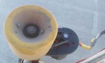

Do not have any pictures of the original setup unfortunately, motor worked good about 50km, amazingly strong, could pull 2 ppl up to 30kmh on flat, more top speed than i ever dared to go, 53km/h according to the calc 15/46 gearing, but i bet it was faster, I’ve bombed hills in 60 but i never dared to go full speed with this motor… Shorted pretty soon though, combination of bad wiring in the motor together with vibrations.
Happened when starting so luckely no fall from the failure, it just jerked a little and then a puff of smoke, unplugged everything and esc was fine, bought a new motor

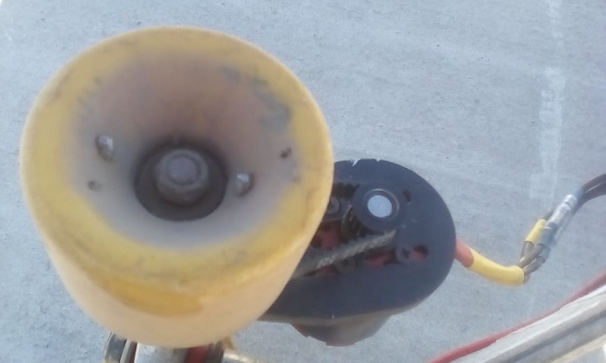

https://www.banggood.com/N5065-320KV-1820W-Outrunner-Brushless-Motor-For-Electric-Scooter-Skate-Board-DIY-Kit-p-1270024.html?rmmds=myorder&cur_warehouse=ES
Had to buy a new pulley, different bore, found this with one week delivery but it meant downgrading to 10mm belt, at least it got me riding again
link
https://www.banggood.com/Electric-Skateboard-Accessories-Belt-Motor-Bracket-Pulley-For-7270MM-Wheel-p-1104585.html?rmmds=myorder&cur_warehouse=CN

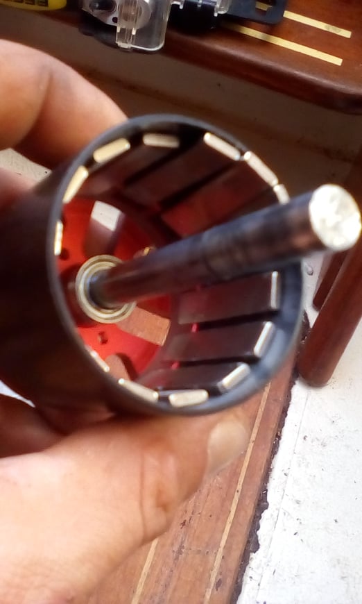

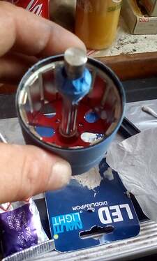

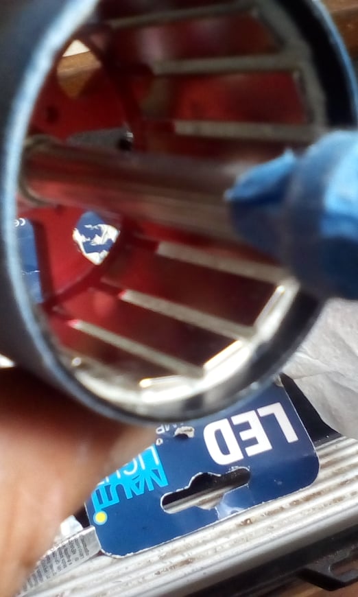

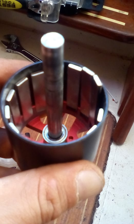

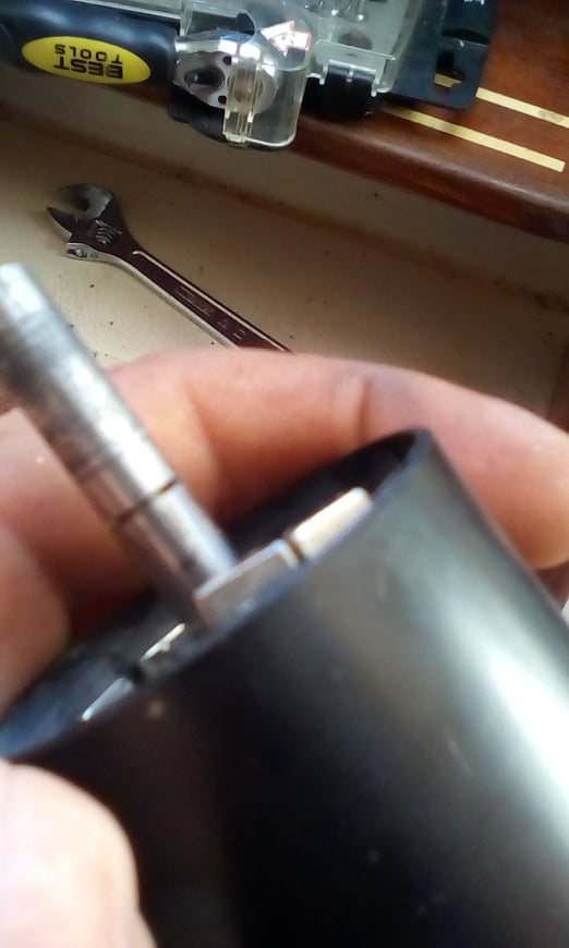

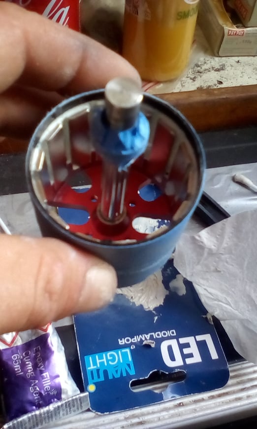

Took about 20km then this happened:
Thanks to having found the forum by then and seen @Lee_Wright’s video on battle hardening i slapped some sweet 2 part epoxy filler (Hempel’s for boats) in there and she was up and running again the next day!
Also managed to rip one of the cells wide open on a cut away pole so no shes rockin 5s!

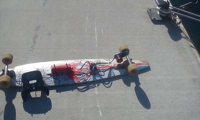

So here we are today in all her splender and glory!
Anyways thats me, right now, any questions feel free!
