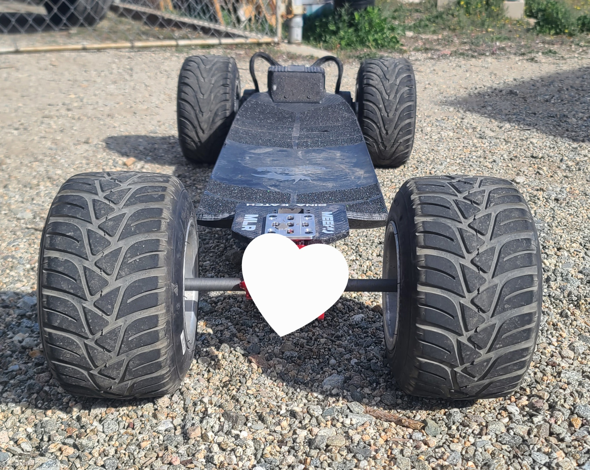

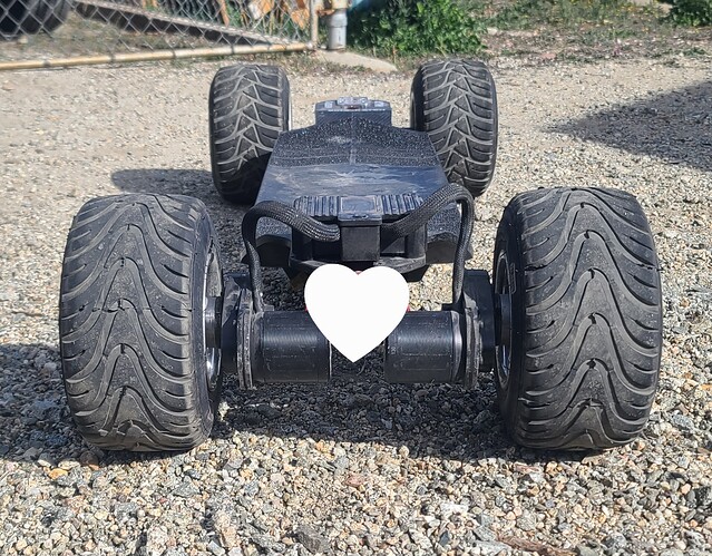

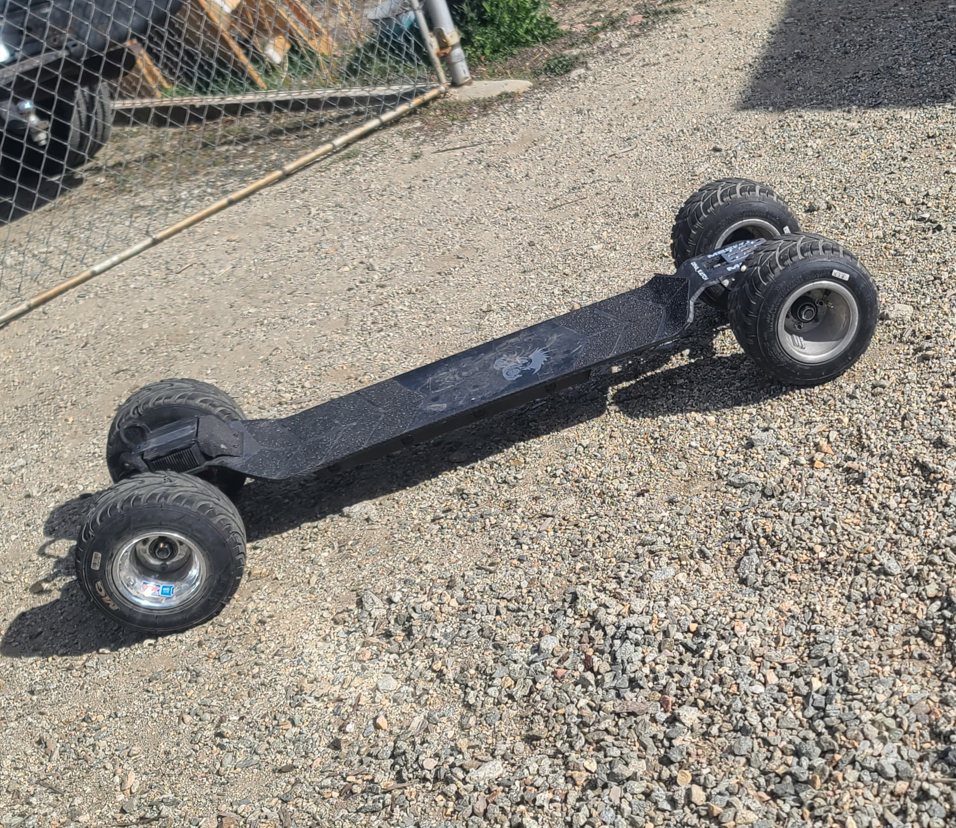

We built a Big wheel MLR and Put the new SRB trucks on track last night at I2S. We started out with full turn adjustments and sent 8 riders out to make laps. We took @RedBeardTorgo and made 30 seconds of steering adjustmens to the front and rear truck removing 14 deg from the front and 10deg out of the rear.
We then had the 8 riders make laps on the 30 second truck angle adjustments.
Attributes:
For use on -Flat to 35deg nounting surfaces
On road or off road. (Trussed hanger center support section)
Hanger center positioned to the end of the baseplate mounting surface for reduced wheel bite.
Run motors inboard or outboard.
Adjust thrust angle
Sets steering angle in seconds
Bushing changeout in under 5 minuites
All hanger attatchments set on keyway. (Threaded hanger gone)

looks interesting, did you make any changes to the drivetrain or is the stock ratio being used atm? How’s the acceleration post swap, or is the main focus with this setup to be a testbed for the truck functionality?
I saw in your last post about the new trucks that the new gen would be foregoing the threaded hangers we’ve seen on previous three links but it seems these are still using threaded hangers, is that because these are using some variant of the larger threaded hangers we’ve seen on the big wheel boards? Or is this purely just a part of the prototyping where it was easier to source a threaded hanger than an unthreaded, will this be a variant that you hope to eventually bring fully to market (either selling under SRB or through Meepo directly)?
Looking back at the post I noticed you mentioned this new “spherical adjustable truck” is this potentially something along the lines of what we saw the SE1 using on the skateboardselectric trucks?

Will be installing the new spherical trucks on an SKP Ionic and have it available for hotlaps courtesy of Lajolla E-Bike and Skate as well as the big wheel CST board.
CST adjustable Precesion set at full turn.
MLR deck Big Wheel, stock electronics and drives
44" wheelbase
At I2sAZ with @dskate
Adjust from Street carve to track race setup in seconds.
