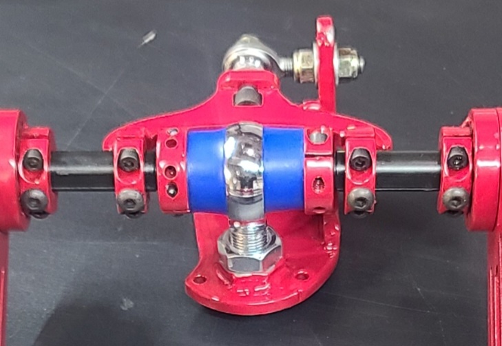

Hi Moe, congratulations for this new CST. I’m a huge fan of the 3-links truck and my SuperSpine. It’s the only build that made me feel like the first time I rode an electic skateboard/mountainboard 10 years ago.
On this new CST, is there any key system that prevent the motor mount to spin on the axle? It would be my only complaint with your 3-links truck, although it’s not a big deal.
A lot of red loctite will solve 99% of your problems. Not the greatest thing on the planet, but if it works it works haha
Hanger is fully keyed. Bushings adjusters are threaded and split clamped. Wishbone and motor plate mounts are pinned to the keyway.
Bushing change takes a few minuites.
