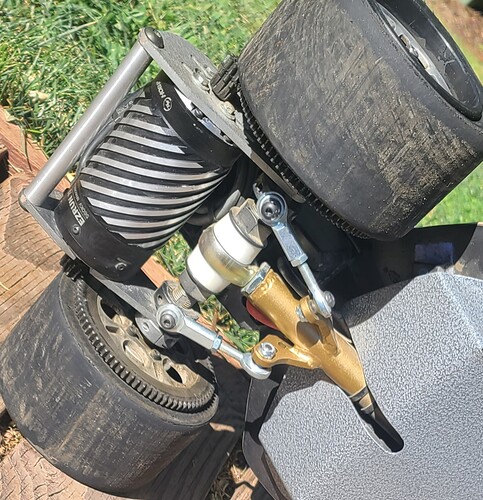

Any possibility of selling a longer motor mount, or producing a motor mount clamp with threaded holes to allow for people to design their own mounts? I’m wanting to run a motor mount out the back, instead of tucked under and the stock length would probably have motors interfering with those tie rods.
You can easily run motors out the back, especially on the rear as the radius rods are at a low angle. Ive done two setups with 3-links, both with motors running out the back.
My current board: (will be 4wd soon)
Previous board:
How much clearance did you have from motor can to radius arm, and what angle of radius arm is that at? Im potentially running 7490 size motors, so a fair bit thicker than most.
Radius rods connected to middle position of baseplate. Motor clearance to radius rods pretty much whatever u make it. The mounts can be rotated to whatever position u want. Depending on tyre size, u should be fine. If going 150mm or smaller u may have issues with ground clearance (if using larger motors).
