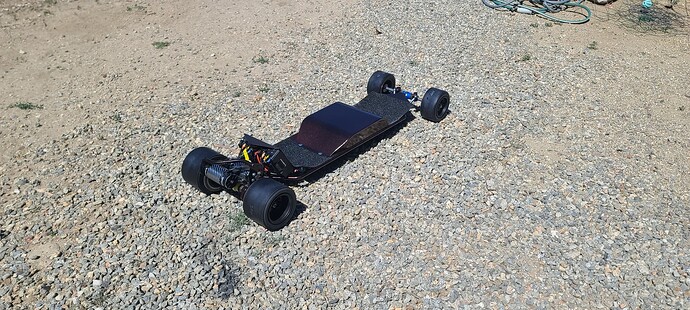

Is there any hope of the 67t spurs returning in the future? I’ve been dailying open gears since october but the lower ground to gear clearance with the 78t’s concerns me
Try some SR125’s on there! I bet they’d feel awesome on such a setup
Is your setup that close to the ground? I’d actually prefer the 78t since it has more ratio than the 67t.
I’ve had rotten luck when it comes to flats lately, in particular some have left me in the position of needing to ride back for miles on a flat tire, the reason I like the 67t’s is because they’re smaller than normal pneumatic hubs so there’s little to no chance they hit the ground, on the other hand with the 78’s being distinctly bigger they have a much higher chance of touching. I also debated going back to 6 inch tires and seeing how close the 78’s are when using 150mm brp’s makes me nervous.
I know what you mean though, 78t definitely offers some more flexibility when it comes to ratio, especially if you’re going with inrunners, being able to avoid using like 10 or 11t pinions just to gear down top speed makes a lot of sense
I’ll let you know if I decide to switch to 78T, cause I’m currently running 4wd with 67T and ik Stan is very interested in 67T as well.

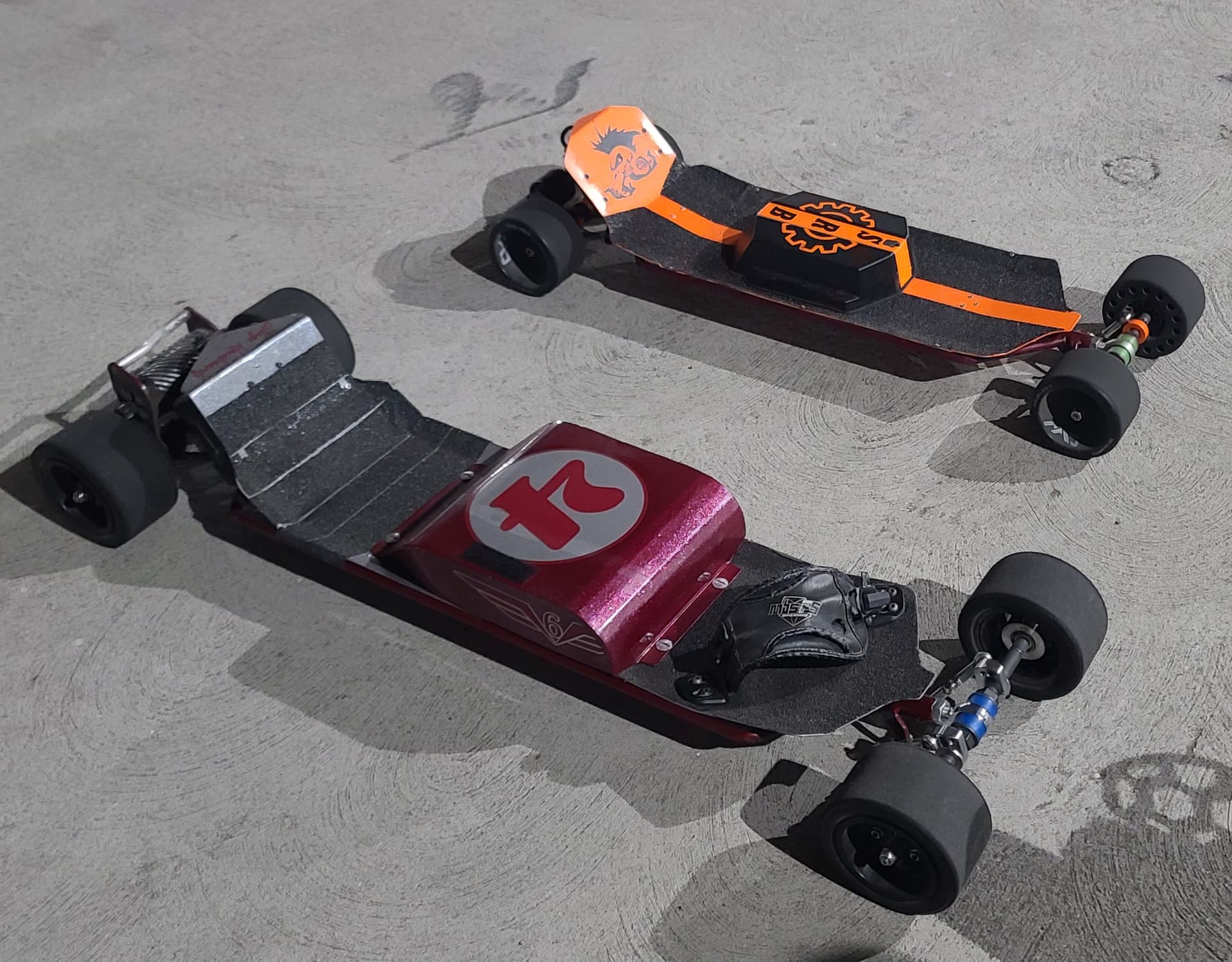

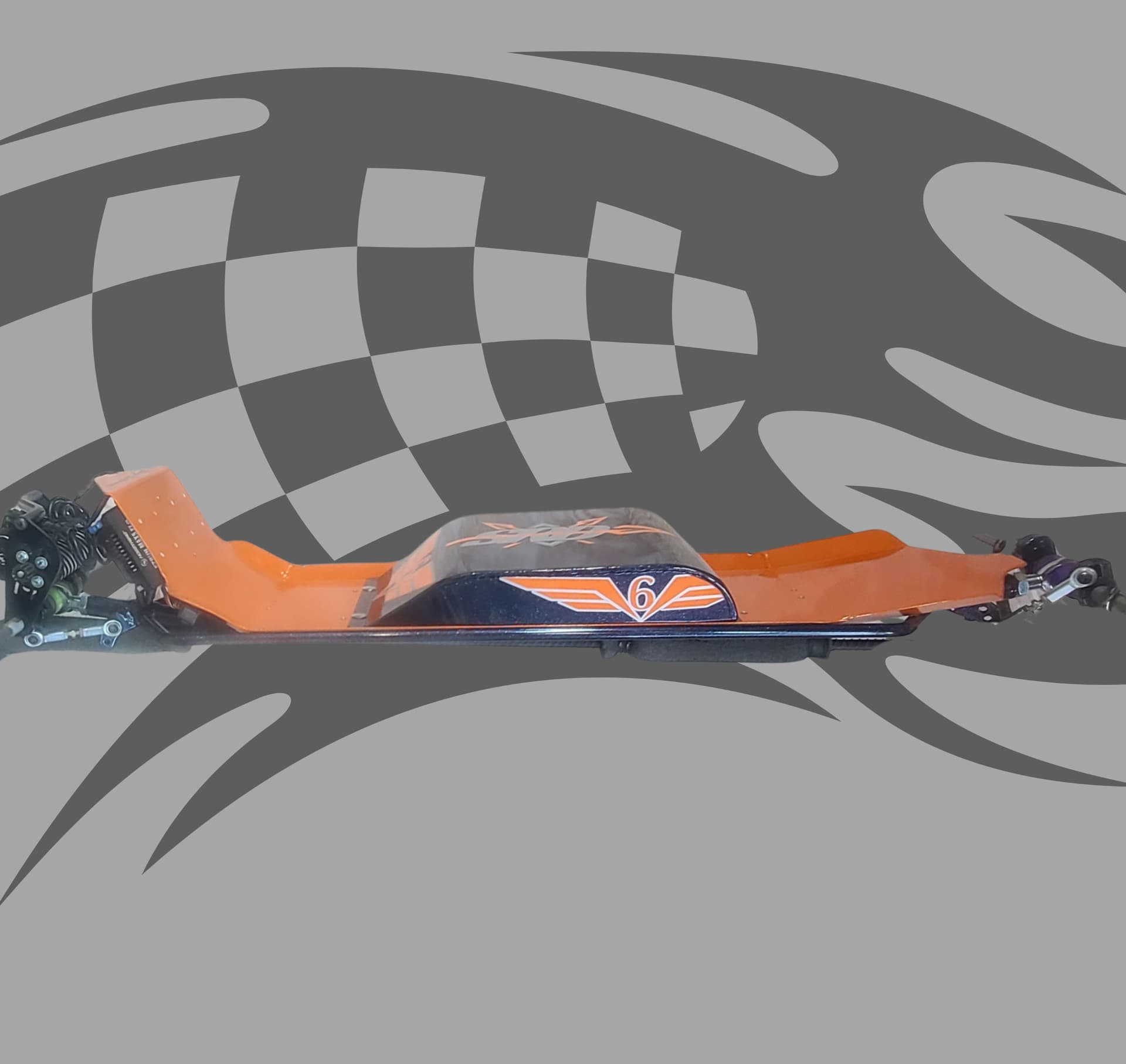

These boards are low power low grip. Geared to promote Youth and Weight divisions for both entry level and advanced level riders. Spec class brings shoulder to shoulder racing without the risks or costs of open class boards. Use aero tuck, drafting and momentum to set up a pass.
By weight, I assume you mean rider weight? Having to split up the field a bunch, or end up with people with massively different acceleration potentials, seems like a pretty big obstacle to trying to do spec racing on skateboards.
I like how you put more degrees in the front truck to give a tighter turn radius and angled the frame back for more wheel clearance. :thinking:
Oh. Looks like you also moved the radius rod mounts up to give more road clearance.
:sunglasses:
