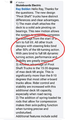

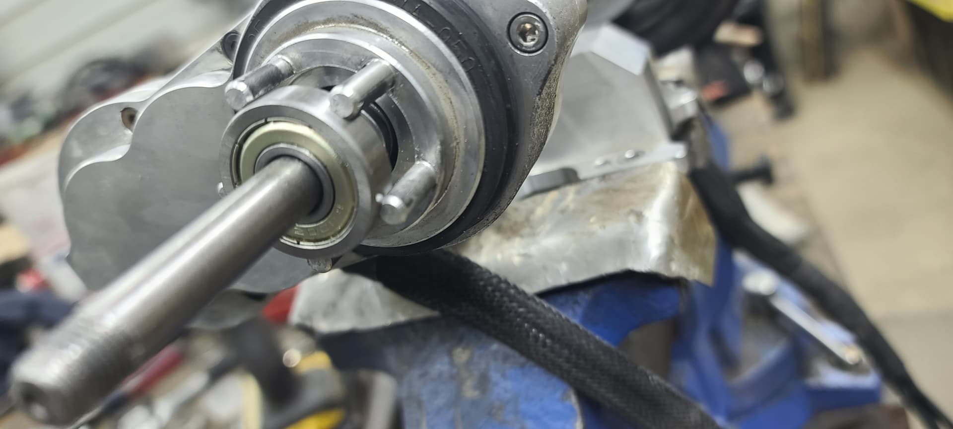

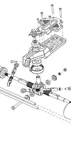

These are sliiiightly different than 3-links. Instead of using a heim joint as the pivot for the hanger, they use a roller bearing to yaw the hanger and a pin similar to channel trucks to roll the hanger.
However, pitch of the hanger is prevented by the pin, whereas 3-links can pitch freely. I’m not sure what this translates to in real riding feel, but I believe it would eliminate the return-to-center effect when on the throttle that 3-links are known for.

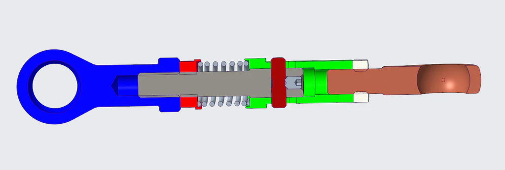

edit: the links are also spring loaded and free to vary their length?? I have no idea how that could possibly be predictable…

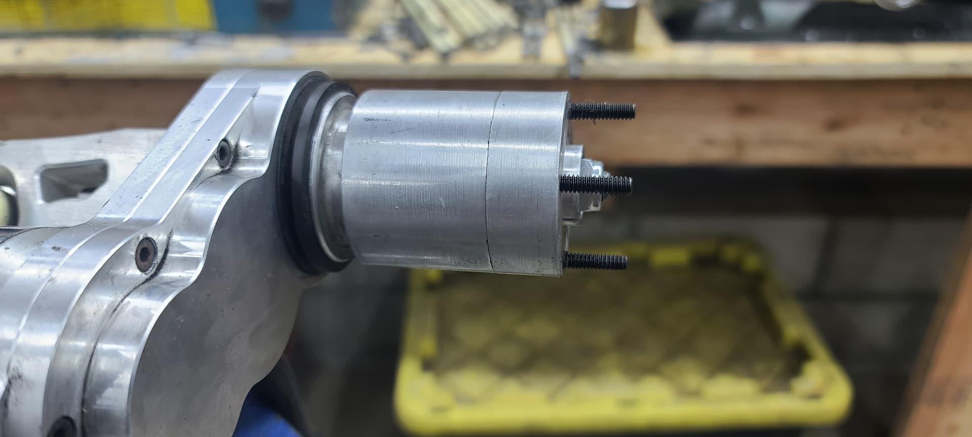

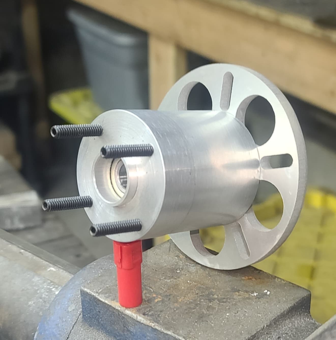

These guys bought a set of DH trucks from us in 2022.
To their credit their design is unique to itself. They took time to follow a thought process to its end.

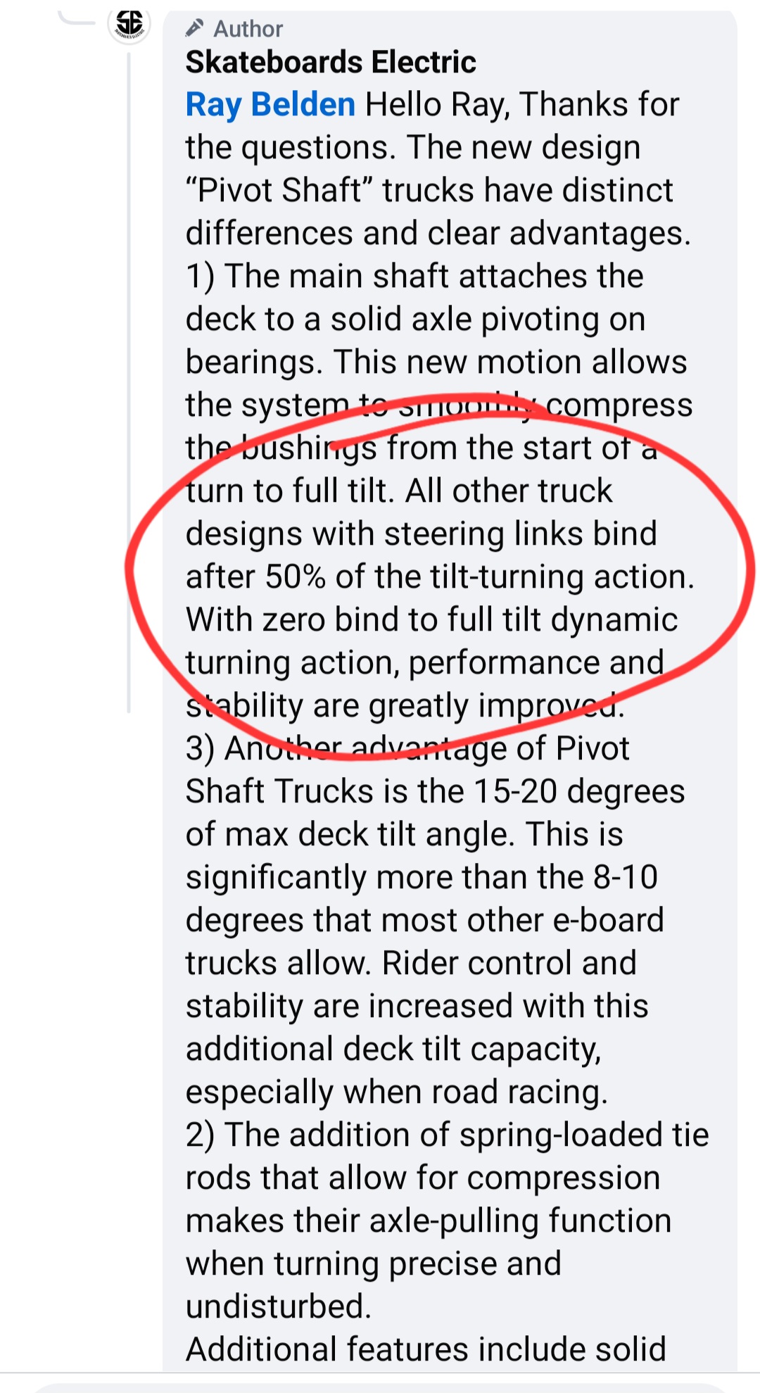

The 3-link design is a 100% mechanical controll that confines the hanger to a precesion yaw, roll, and pitch movement at the hanger pivot center. Without roll pitch or yaw the function will bind.
With a pivot pin the hanger can only make a pitch movement.
(A pivot pin in a critical fulcrum area will likely create weak point for the hanger)
The carrier torrington bearing used on their kingpin allows for hanger Yaw. (We used torrington bearings as spindle support in auto racing. A constant maintenance item.)
Whats missing is hanger Roll
To keep from binding Without hanger Roll, as you tilt and steer the radius rod lengths would need to lengthen as steering angle increases. Their answer is sprung radius rods.
My personal opinion is this is brilliant stupidity.
