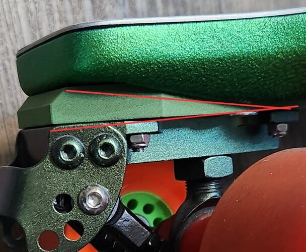

Heya @MoeStooge, i built a set up awhile back using the DH 3 link trucks. Its turning radius is not as good as what im used to, coming from the esk8 long hangar 3 links. Any tips on tuning the rod location?

How close is your wheel bite on the front truck?
Also, from The picture it looks like dewedging riser pads.
It appears the rear is dewedged to bar posotion flat.
Putting in a non wedged front riser pad will increase bar angle and steering. Same with the rear.
Flipping the rear wedge 180deg will have the biggest impact on turn radius and liven it up. I would start with the rear and report.
The risers are the same thickness throughout, just to give clearance to the deck, they’re not wedges :stuck_out_tongue_winking_eye:
What do you think of the rod placement? Currently im using the red bushing in front, and white bushings on the rear.
I’m having not so great turning radius, yet the board’s rebound is bad, it feels very ‘soft’
Removing the riser pads and increasing the ride height of the truck will increase your bar angle and steering.ratio
3 full turns out of the baseplate will do a lot for bar angle

Should i do it for both front and back?
The back will give you the most gains. I would start there
What about the linkage rods? Should I adjust them?
Set your ride height and adjust to 90deg if needed
