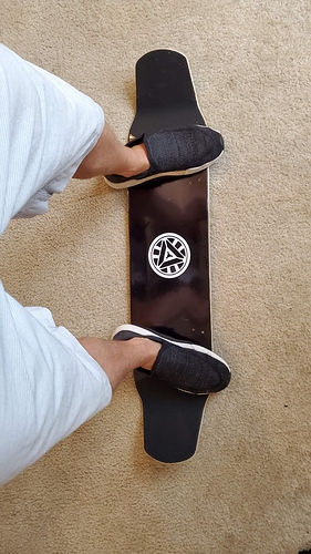

Is there enough space on the deck to really carve without the bindings?
Go show 'em that 4 wheels are better!
Haven’t gotten to try it with the bindings yet. I was using f1 bindings loosely on it and had no trouble carving but I’m also 5’10"
I’m wondering if it will be good for me for now!
But I’m 6’2” and 240!
What size shoe do you wear? How much foot space do you have
10.5
I used to hate how narrow it was because it made my feet hurt for the first week or 2. Now I like it. I can monkey grip the edge of the board with my toes through my shoes and my heels rest right on the edge of the deck so I can really utilize the bindings. It’s growing on me as a deck. I like how poppy it is. No trampa or traditional mbs deck but I’m hoping my new dw2 will be similar firmness.
I think I’ll be fine then!
