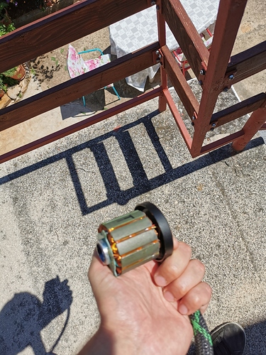

Stator and rotor scraping at one motor side only??
So at a certain rpm, I get that crazy wrrrt motor sound and after some small rpm range it goes away
This started happening on the first warmer days this year and the magnets are holding up really well as I have had this issue for 2 months and I finally now opened up the motor.
Magnets are battle hardened so idk how they menaged to go to shit…
This is literally my 5th or 6th Maytech gone to shit after less than 1000km…
Cant even imagine how often others break
Any ideas what could help?
Filing the stator a bit maybe?
No dirt on the magnets? Hard to see on the picture
Usually metallic particles build up inside the motors and start scraping, specially it your board has them close to the ground
No dirt, motors and closed and clean only a bit of dust was there, I will file down the stator and try again

I wouldn’t do that, this will short the lamination together and can greatly increase the loses on the motor

You could sand with a fine sand paper parallel to the laminations
The stator is made in layers insulated from one anotherto reduce the induced current loop, Eddie current loses, when you file them there is a big chance they are connected again

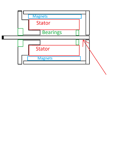

The can is supported by the shaft, but only at one end. Basically it’s one big lever, so any undue force (hard drop, impact, big rocks, whatever) can bend the shaft, or the bore in the can that the shaft is pressed into. Have a look at this picture, lovingly drawn in MSPaint.
The only place the can and magnets are supported is at the red arrow. So if the shaft is bent near the red arrow, or the hole the shaft is pressed into is wobbled out, then the can will not run true.
You can also see that a very tiny bend or deviation there, can result in a significant deviation at the far end of the can.
It’s an inherent design flaw in most of the motors we use, since they are descended from motors designed for RC airplanes, where they don’t see these kinds of lateral forces.
The only motors that are immune from this weakness are inrunners, or outrunners with a third bearing to support the can’s other end such as Hobbyking Sk3 and SK8, and a few others that don’t spring readily to mind.

Anyways the sound got much better after i filed down around the whole motor

Like I mentioned earlier, it’s a design flaw with pretty much all esk8 outrunner motors, with a couple notable exceptions that I mentioned, like the SK3 and SK8 and a couple others I don’t remember.
ALL other outrunner esk8 motors have this weakness. Torqueboards, APS, Maytech, Flipsky, all of them.
6374 and 6380 tend to have more problems than 6355s, because the cans are longer, and thus more leverage.
Motors with 10mm or 12mm shafts tend to be much better than ones with 8mm shafts because the
thicker shafts are stiffer and more resistant to getting bent.
But even a 6355 with a 12mm shaft is not 100% immune.
