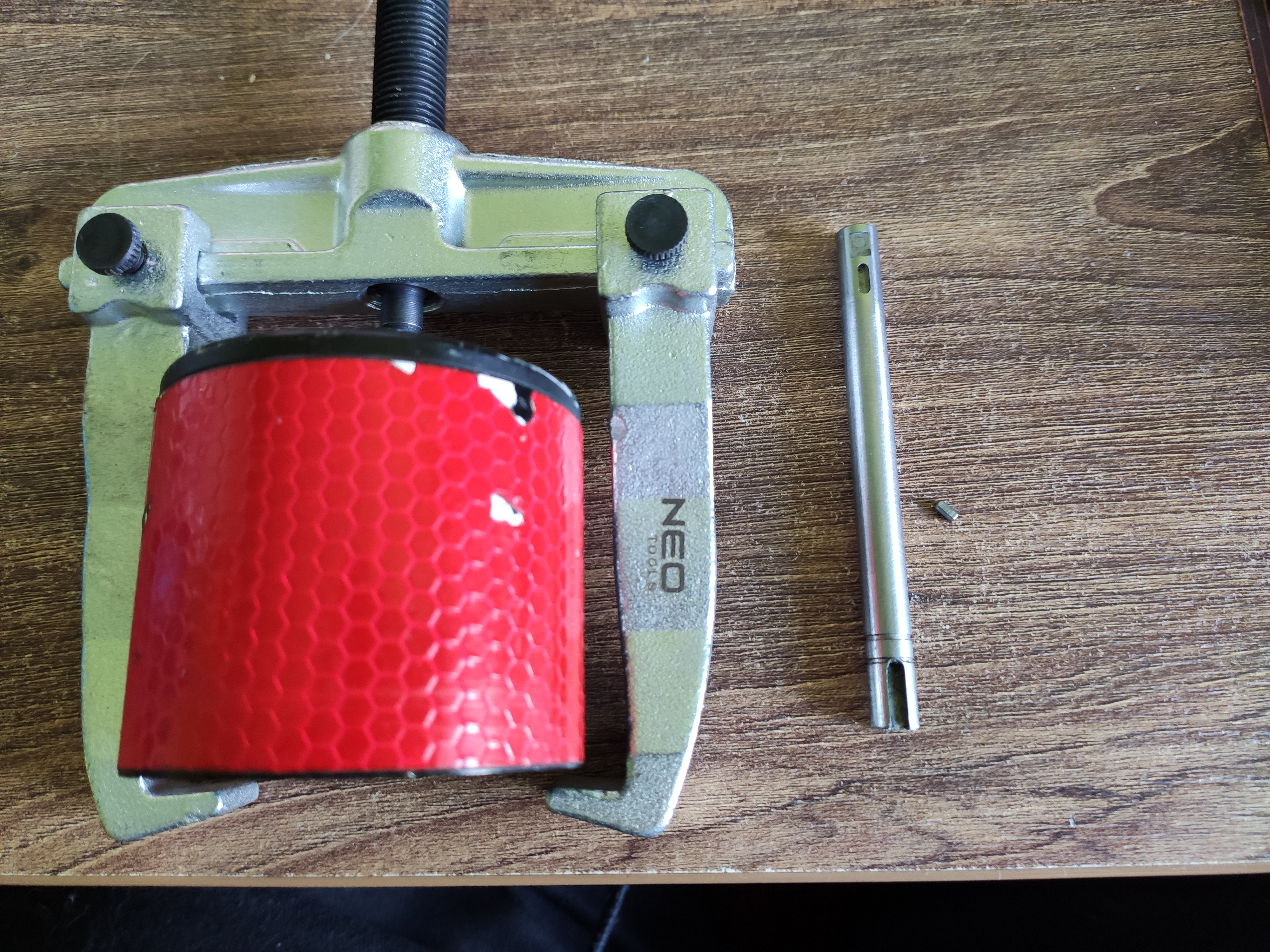

Stator and rotor scraping at one motor side only??

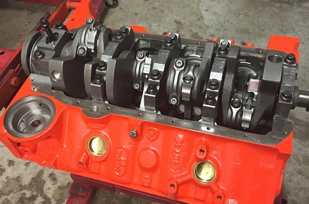

Nice…4 bolt main steel caps looks to be a Sbc. Is this yours?
nah just a random internet pik… I prefer aluminum blocks

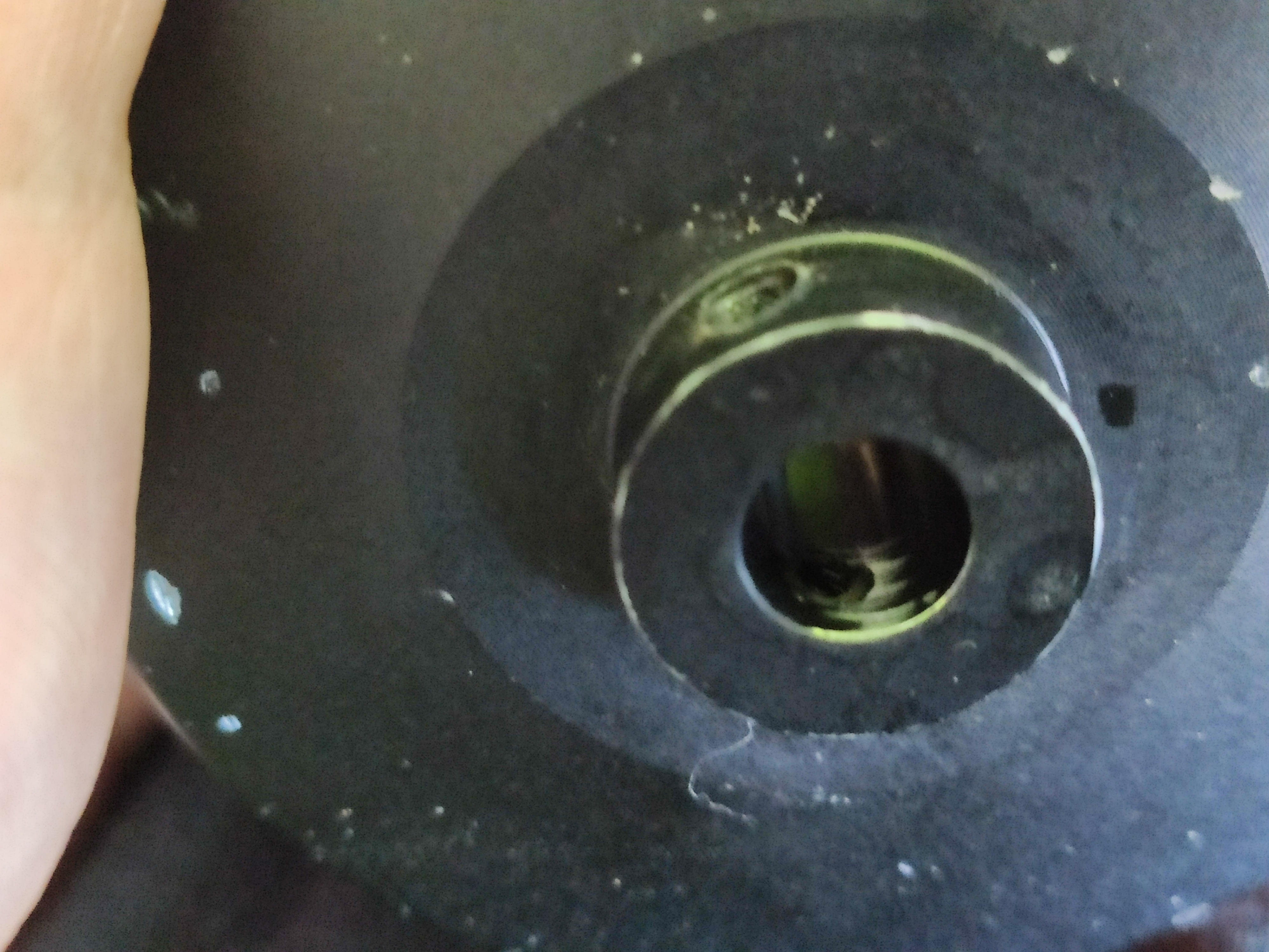

I had a similar noise with 170kv 6374s maytechs… I had a bitch of a time diagnosing, new shaft and bearings… the magnets broke loose and i couldn’t tell until i removed the plastic retaining ring. I have a can with 3 magnets that came unseated…planning on resetting with carbon fiber epoxy/resin…
In the same boat. First I thought the shaft was bent.
Removing it was extremely easy, NO HEAT, finger force(no tools) only using a bearing puller/press:
No glue at all on the shaft…
And of course it has shifted during use and killed the front bearing.
Changed the bearings now to NSK bearings and will re-seat the shaft, will see how it lives afterwards.
