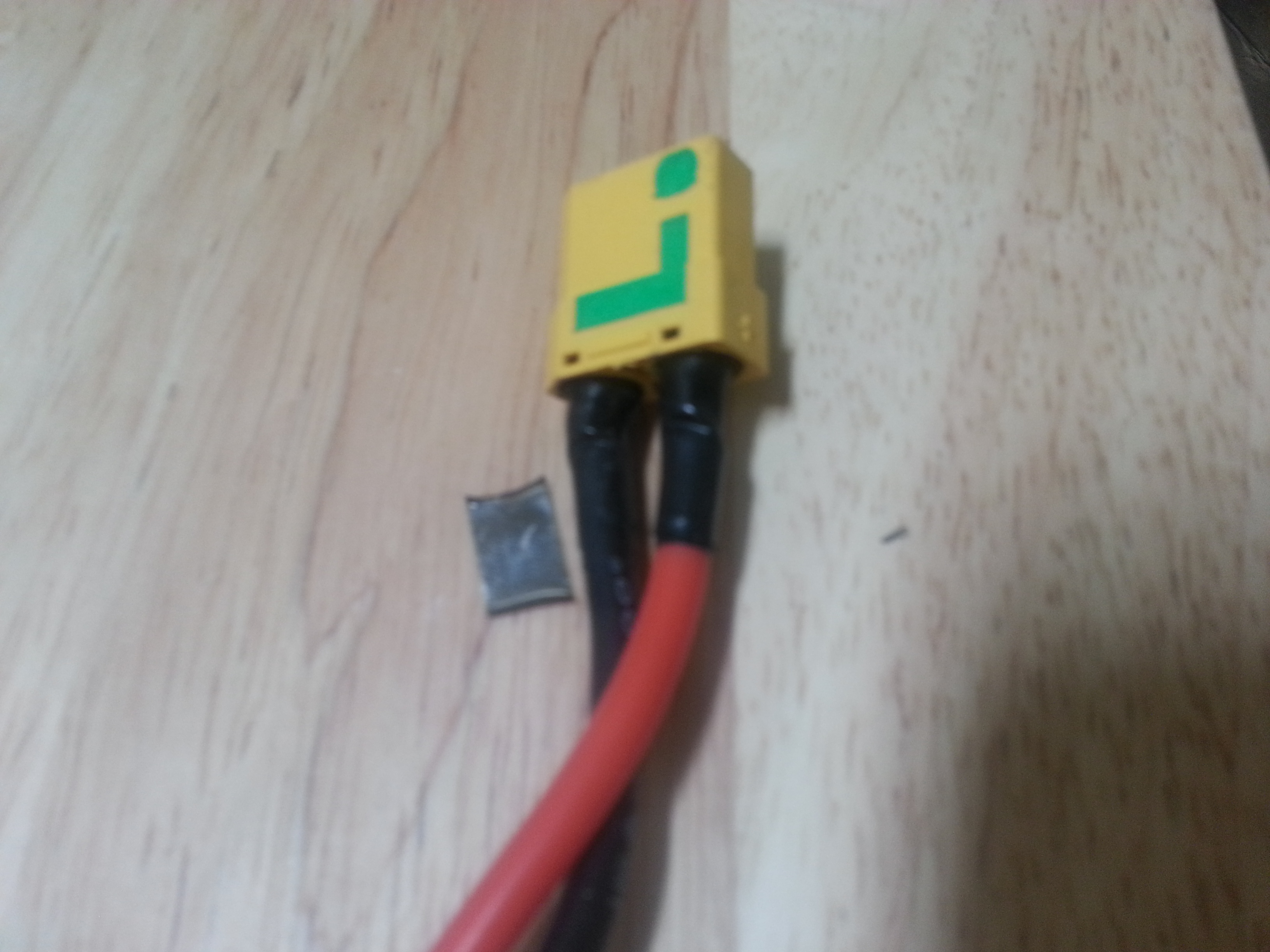

as I discovered today :thinking: when my Flipsky blew up after 3 rides a while back, it left a black char on the esc. I though that was the extent of the damage.
since I’m waiting for my go-foc dv6 to come in, I decided to hook up my 12s6p battery-pack to the balance charger and put it into storage mode, kept getting error!
discovered part of the “wide” nickle strip was blown out at the end where the wire connects to the xt90 :flushed: :scream: :joy:
the missing strip, maybe like 4mm across just vaporized!

i have 5 copper wires along the strip connecting to the next strip in series, i made sure not to bottleneck current flow.
the strip blew up at the junction connecting the 12awg wire to the strip and the xt90 connector. i’m wondering if maybe it was some kick-back current?
obviously not wide enough :joy:, i believe it is 0.15mm thick.
Lol yeah that’s not wide.

Unless you are soldering directly to the cells, the nickel is most certainly carrying all the amps.
exactly, current will take the path of least resistance more, but it will flow through nickle strip just fine.
I agree, but the flow is split between the cells in the p groups. It’s the series connections where all the amps flow together. I know that’s over simplified, but that’s why we can get away with single nickel strips on the p groups and want to beef up the ampacity for the series wiring. Not an expert by any means but that’s the theory afaik.
