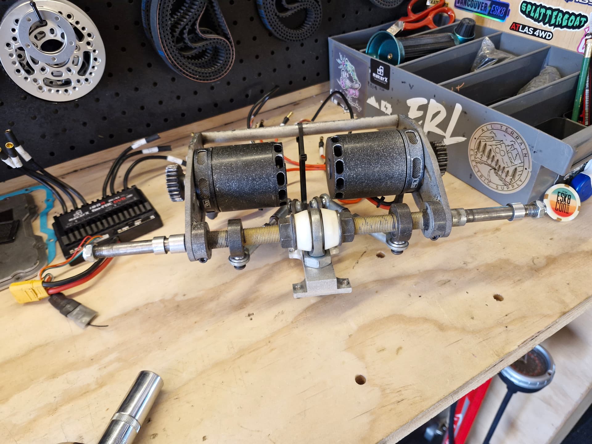

First thing I started with was disconnecting all the electronics, followed by removing the trucks. In hindsight I should’ve completely stripped the drivetrain while it was mounted on a deck, but I initially had the intention of doing as little work as possible to get it up and running and back on the race track. Little did I know that the trucks would be arranged in a completely different setup on the new chassis :sweat_smile:
Continuing on with my naive thinking that I’d just simply be installing the trucks to the chassis and be done with it, I decided to slap on this awesome grip design by @Jaws. I stuck with my classic #3 as its been good to me. Hoping chassis number #33 will be double good
Next was binding placement - the rear binding has stirred up some controversy but it felt good to me :man_shrugging:
Trucks went on next, pretty straightforward to install. Decided to put some red loctite on the main thread as I’ve heard of some people’s loosening out over time
Next was the ESC box at the rear. By chance, my standard top mounted boxes fit almost perfectly, just needed some minor adjustments to the power cable opening to fit across the chassis spine.
Making adjustments to the rod angle geometry to suit the new chassis was overall a pretty straightforward process, thanks to countless hours of working on the trucks on the previous setup. this all went together pretty smoothly. It goes against recommendations from most, but I’ve kept the widest track width settings from my previous set-up rather than going narrower. So far it’s felt rock solid and stable.

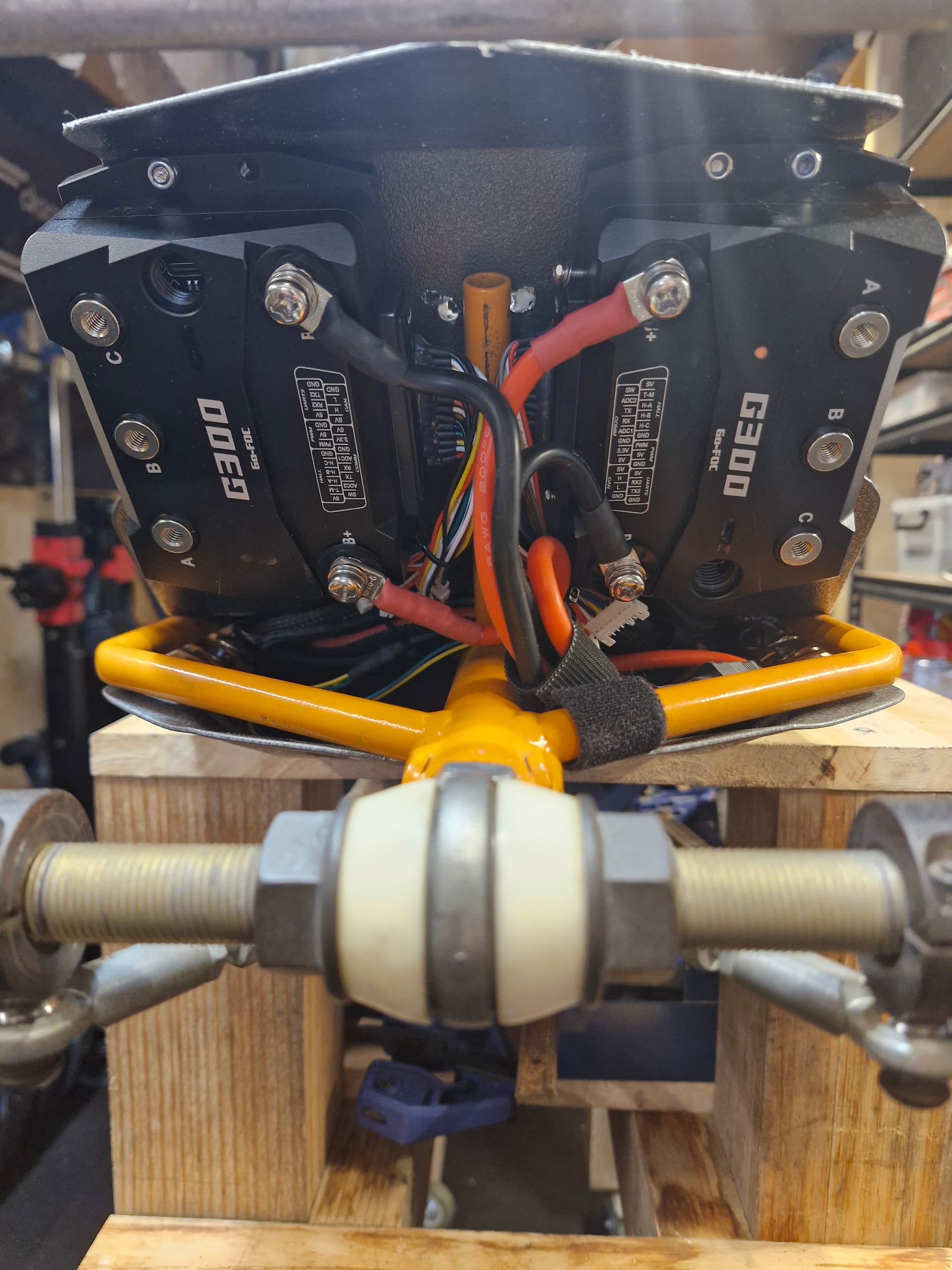

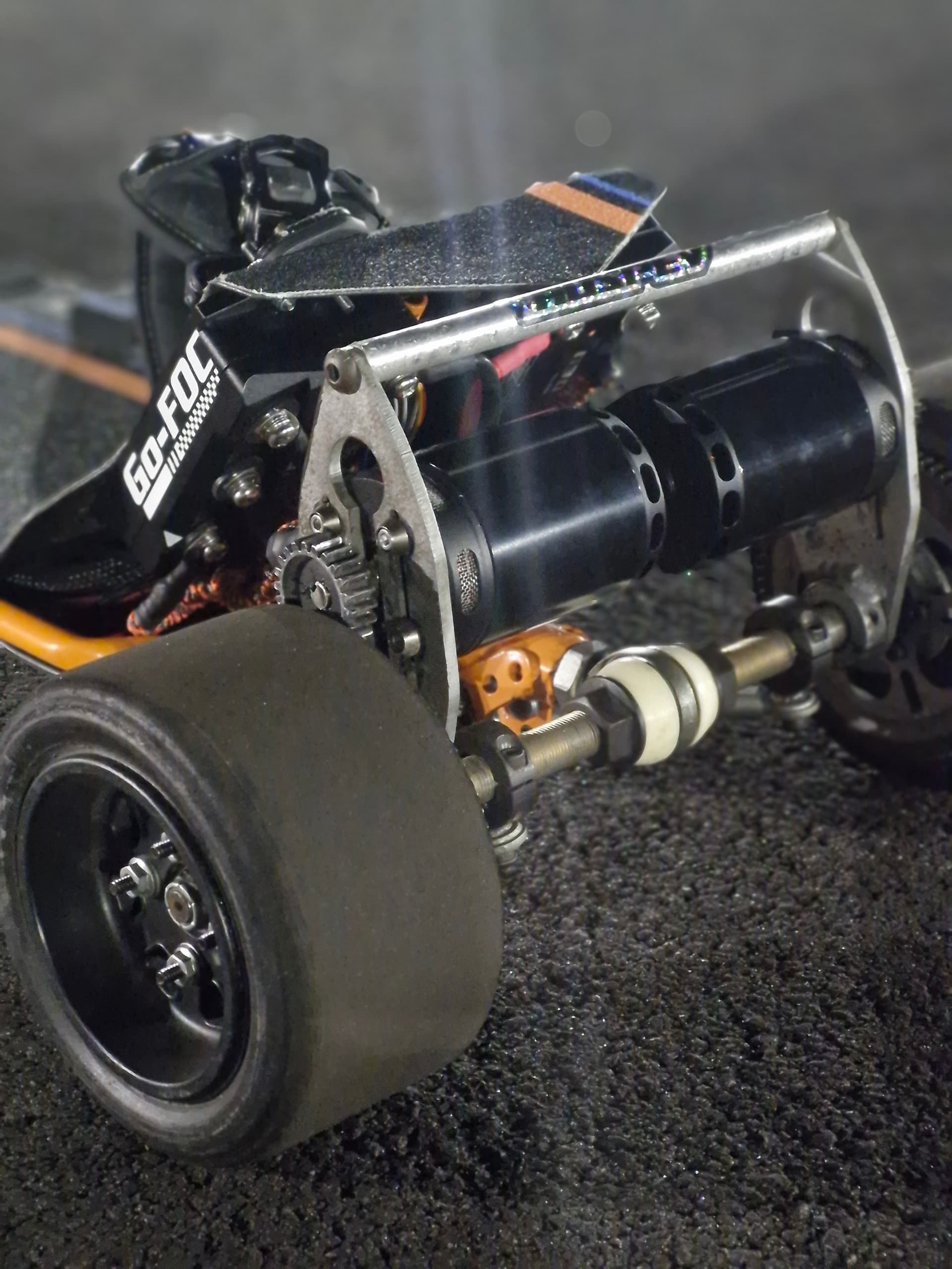

It’s winter here in WA, which means off season, which inevitably means upgrade time. Massive thanks to @Tony_Stark not only for arranging custom 255kv motors but all the tech support that followed. I went slightly larger on the rear (6495) and the front (6465), moved my old dv6pro from the rear to the front, and now controlling the rears with maker x g300s for a bit of headroom.
I currently have the rears set to 180A ea, and fronts at 90A ea. I didnt record much data on my test run as i was just getting a feel for the power increase, but the additional amps were certainly noticeable. I did about 10 t-race laps either side and was already in the mid 13s on those first few laps, so considering I havent done the T properly since last year, I feel ive finally got the punch i want out of the setup - for now… grateful that i do have the ability to turn it up even more when i feel the need to
