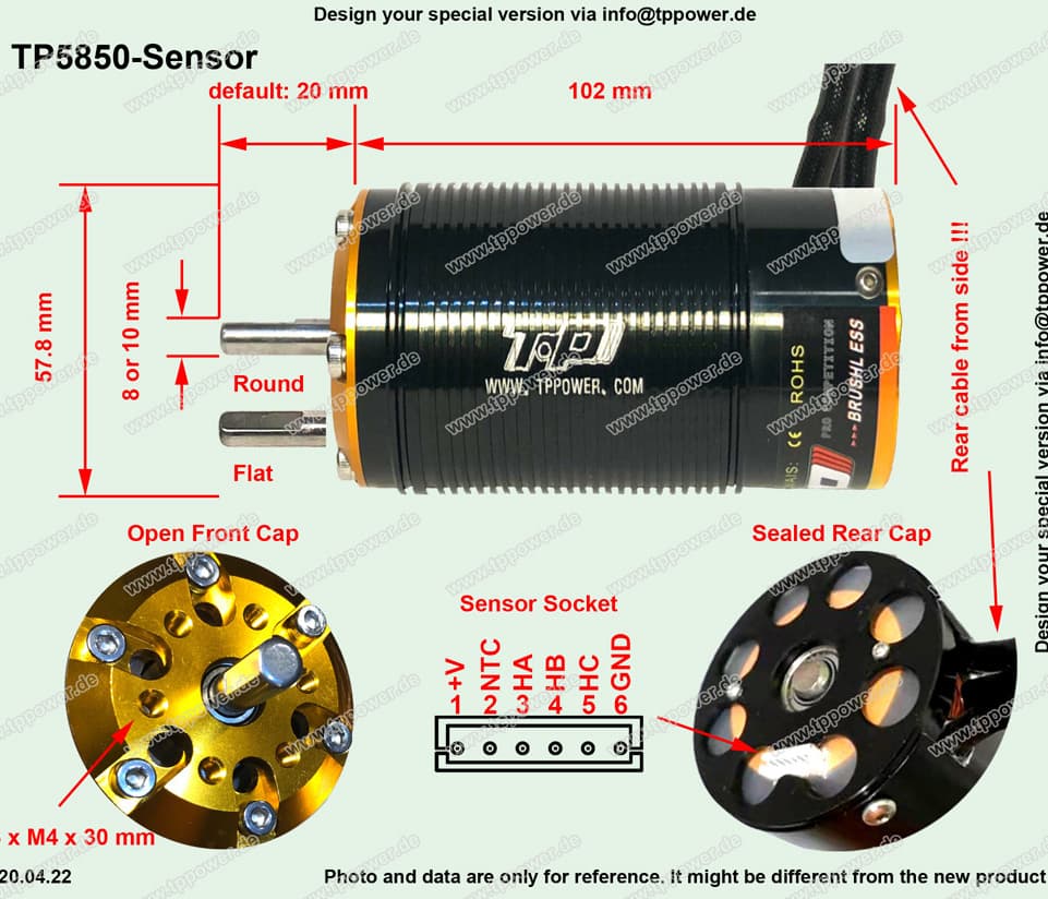

This is the sensor socket:
isnt the NTC the temp wire?
Dont know if the winding plays a huge role in our application but i might be wrong
maybe anyone can confirm this?

Certainly looks like a temperature sensor wire. I only know I explicitly asked about getting temp sensors and they told me they could only add hall sensors and that was after checking with the factory. Have you been dealing with the US distributor?

Ill check my motors as soon as they arrive and post a pic of the sensor plug.
except you dont get temp readings its not affecting a smooth startup am i right?
I think it would only affect startup if you were using a VESC-based ESC and using VSS which I believe relies on the temperature sensor.
I also shared that image you posted above with the US distributor and asked them to confirm.

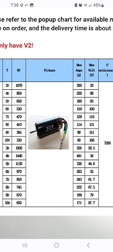

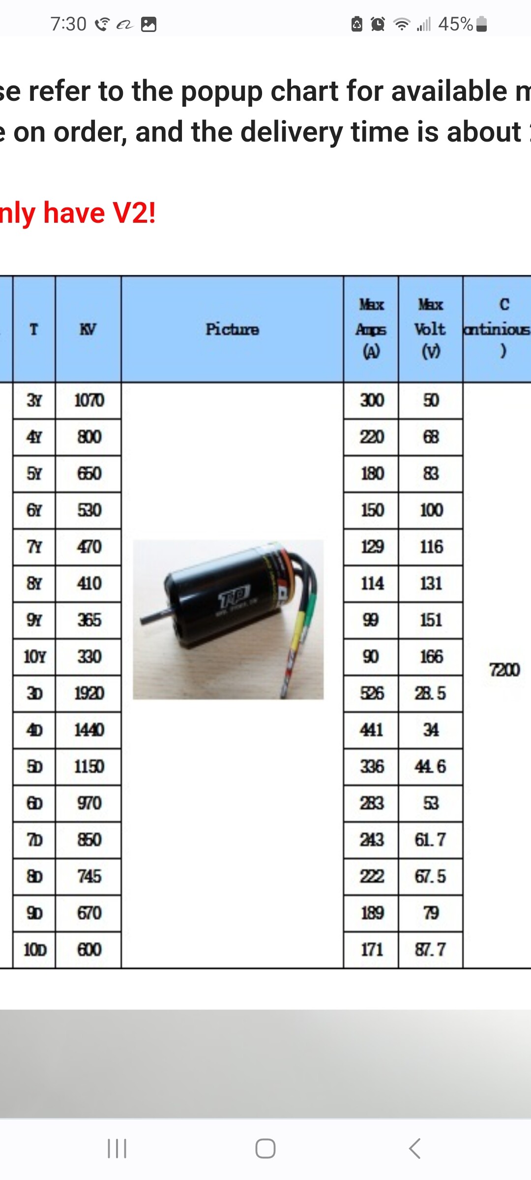

different windings do effect the โ€œwinding factorโ€ which is the magnetic circuit and some are more efficient but delta or wye isnt the winding and is the termination.
Watts is the same for same Delta vs wye on the same winding count. , more amps using a lower voltage with delta to get there
Different Kv for the same number of turns on delta vs wye
You need to compare the same Kv motor, for example 4TW is 800 Kv and is rated at 220 A
7TD is 850 Kv and 243 A
Is not the same due to the Kv not being exactly the same
