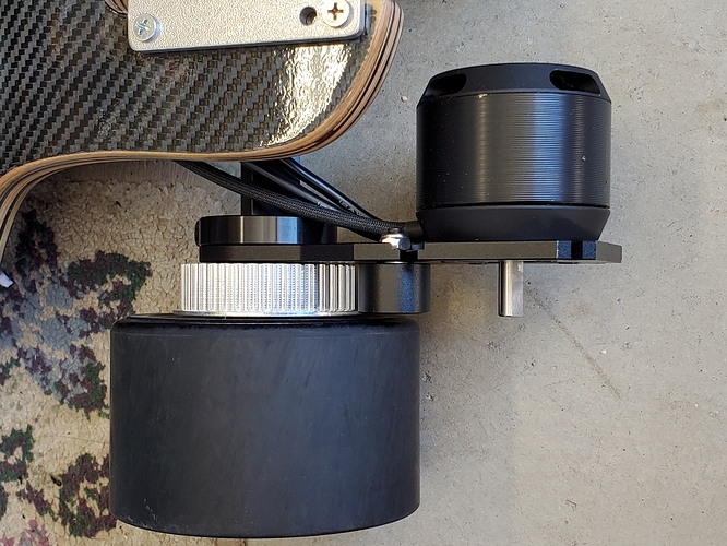

Two packages in one day is really a fun time. Thanks @NatS for the good deal on these wheels and pullies. I may switch the 110 black 78a onto my other board so the blue ones can be on here or end up selling them later if I want to switch out to the 72a on the hummie. For now, these are perfect and came at a good price.
The @Boardnamics pullies look pretty nice, am curious to see how much of a spacer I will need to put on the rear hanger now. For normal TB218’s I think I put on a 0.5 inch spacer, I think it will be less for this due to the bearing pulley, which is totally fine by me.
OOOoohhh look at that fit doe
Looks great. Whoever made those parts must really know what they’re doing :+1: :smirk:
