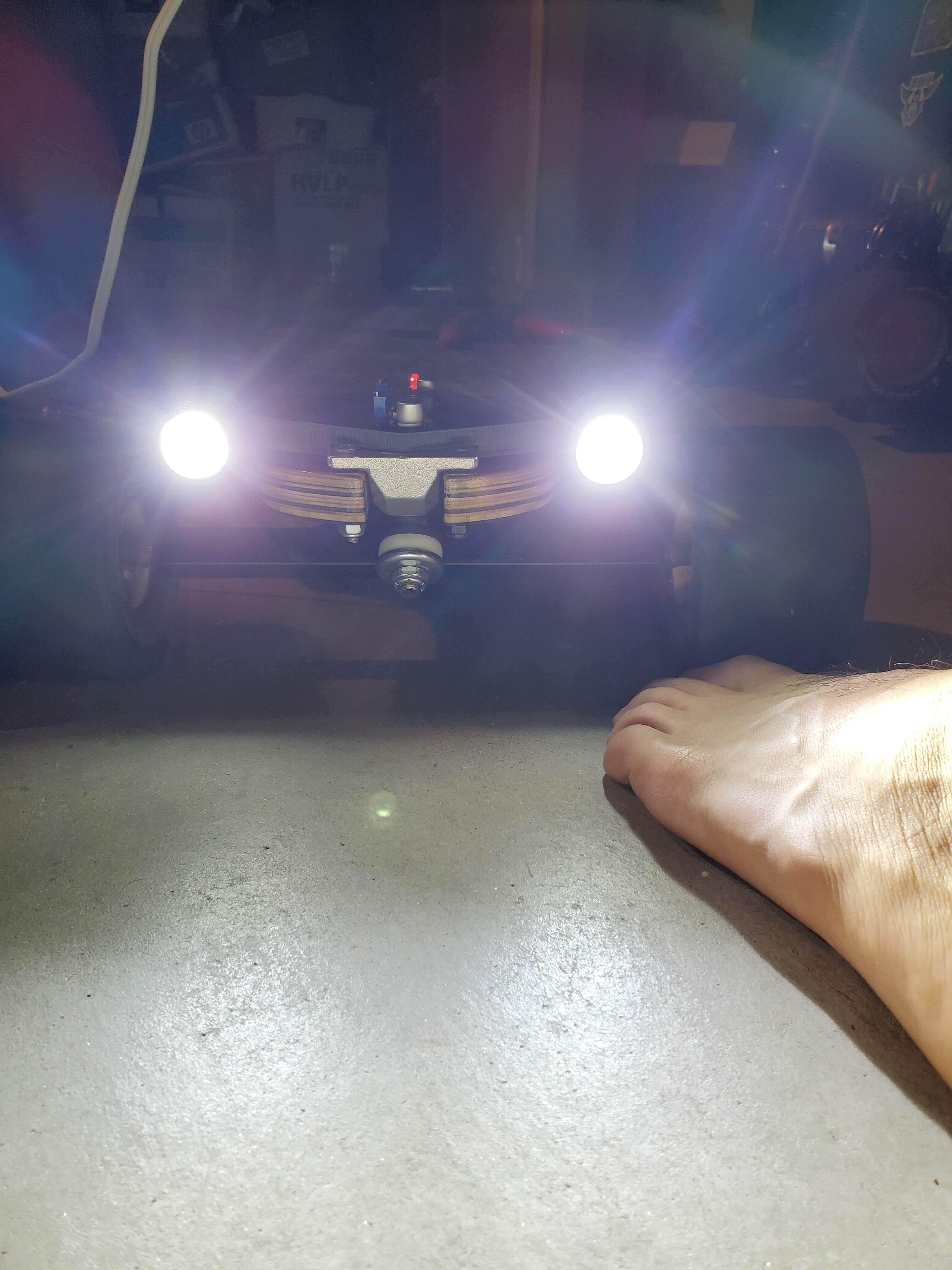

Here’s a little teaser for the headlight / tail light project that I’ve been working on for this board
@Venom121212 and @Flasher were murmuring about the wiring of this setup in the pictures replies thread, so I’ll detail it a bit.
I actually read the schematic incorrectly on the Maytech user guide, which ended up with my shorting 12v across the receiver, which blew up the switching transistor and caused the forwards UART function to no longer work.
$57 and four days later, I have a new receiver. With the new receiver I was sure to wire it correctly. This is how I did it. Please appreciate my gorgeous MS Paint drawing.
This works perfectly and I have no problem drawing the current I need at 12V to power my LED diodes at 3.3v, 1.25a

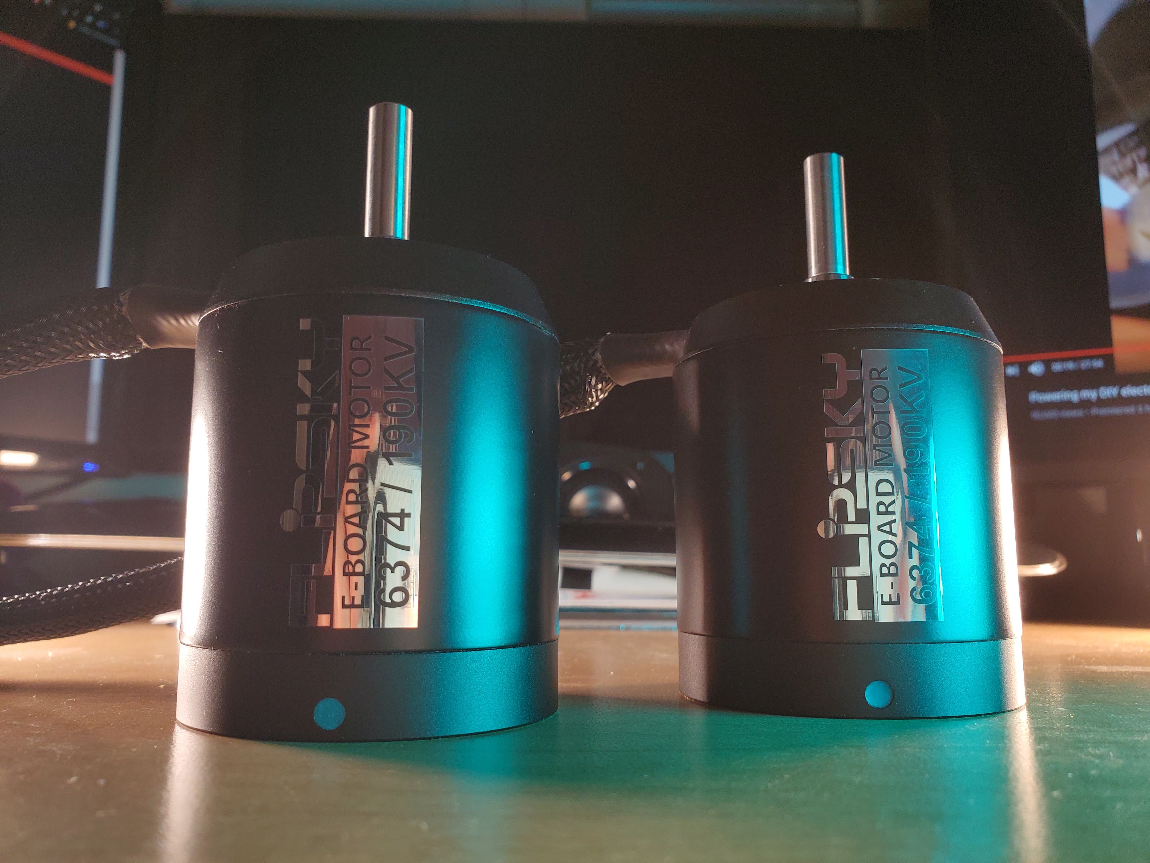

The other upgrade that I made was from my 6355 BKB motors up to the new Flipsky 6374 motors. These have been running for about 50 miles now and I’m impressed with their performance. They run great and I’ve got a higher limit at which I can throw amps into them. Unfortunately, this has lead me to discover how severely the Go-Foc Retro thermal throttles. With pnummies and the new motors, it will only take two or three major hills at speed to heat soak the ESC. I have my thermal limit set at cutoff start at 85. I’m wary about going higher than that with my internal mounted VESC. I am thinking that I may bite the bullet and figure out how to mount the ESC so that the heatsink fins stick out into the air. This may be the only solution to my overheating issue.

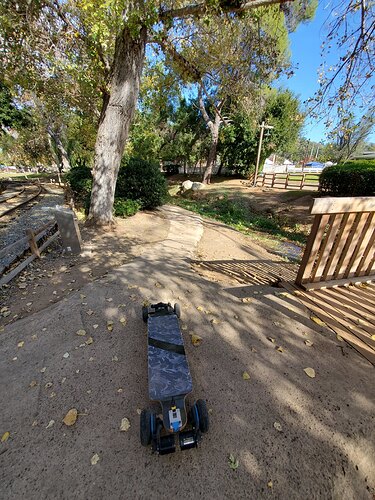

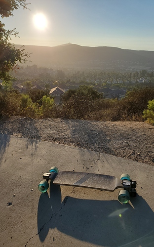

The last ride picture up there was taken on my range test of the board. A fateful test. A painful test. You don’t know how annoying pnummies can be until your battery runs out 1.5 miles from home on a hill. I just overestimated my range on the ride and ended up walking the end of it. Well, at least I know what my range is now. My range on the 12s7p of “salvage” Samsung 30Q cells is officially 23 miles before it becomes unusable. That was starting at a charge per cell of 4.15v and ending at 3.2v. Here’s the Metr and Strava rides for those curious. If you inspect the ride closely, you can see my ESC bouncing off of thermal limit pretty frequently. It really is annoying getting halfway up a hill and having to stop and wait for the ESC to cool down.
Overlooking the battery running out, the ride was awesome and really was probably the thing that spoiled me on pnuematics. The ability to just glide onto a gravel or dirt trail is pretty awesome and all the concrete cracks fade away into nothing.
One last thing, I did end up finishing off my headlight build and it’s been holding strong on the front of my board for over 100 miles now. The ms paint schematic that I drew up there is the basics of it. If anyone wants to re-create it, I can explain it a bit more. In the module with the lights, I have the smaller buck converter that drives the LEDs. I found a good balance of the current so that the LEDs won’t overheat while riding. I wouldn’t run it if it was hot out but when riding at night time the lights have no issues staying cool. I used thermal paste when mounting the diodes into the heatsinks to make sure that they were fully utilized. The lights really make a huge difference riding in the dark, I can actually fully see where I’m going. More importantly, it makes me very obvious to other vehicles and persons on the road. Here’s a short vid of my friend riding my board with the lights on!
