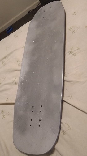

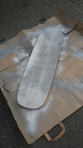

I’m painting a tayto this weekend and wondered if a few layers of clear coat would be enough for protection and to keep the shine, or should I add a thin layer of epoxy as well to seal it all in? If I do the epoxy I might as well frit it then and there.
Here it is about halfway through sanding last night. I have the backside taped up but didn’t get to painting since I forgot to buy clear coat. I’m also not sure the paint I got is the greatest, but we’ll see how it goes.
Ideally, use the same brand of primer/spray paint/clear coat.
You will need a primer first, which is a base coat before the paint. A couple coats of primer on both sides will do, lightly sand with 600 grit, and then spray the paint. Wait for the paint to dry for about 6~8 hours then spray the clear coat.
Wait a full 24 hours before applying grip tape/handling. Have fun!

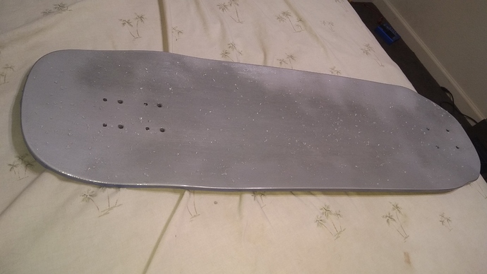

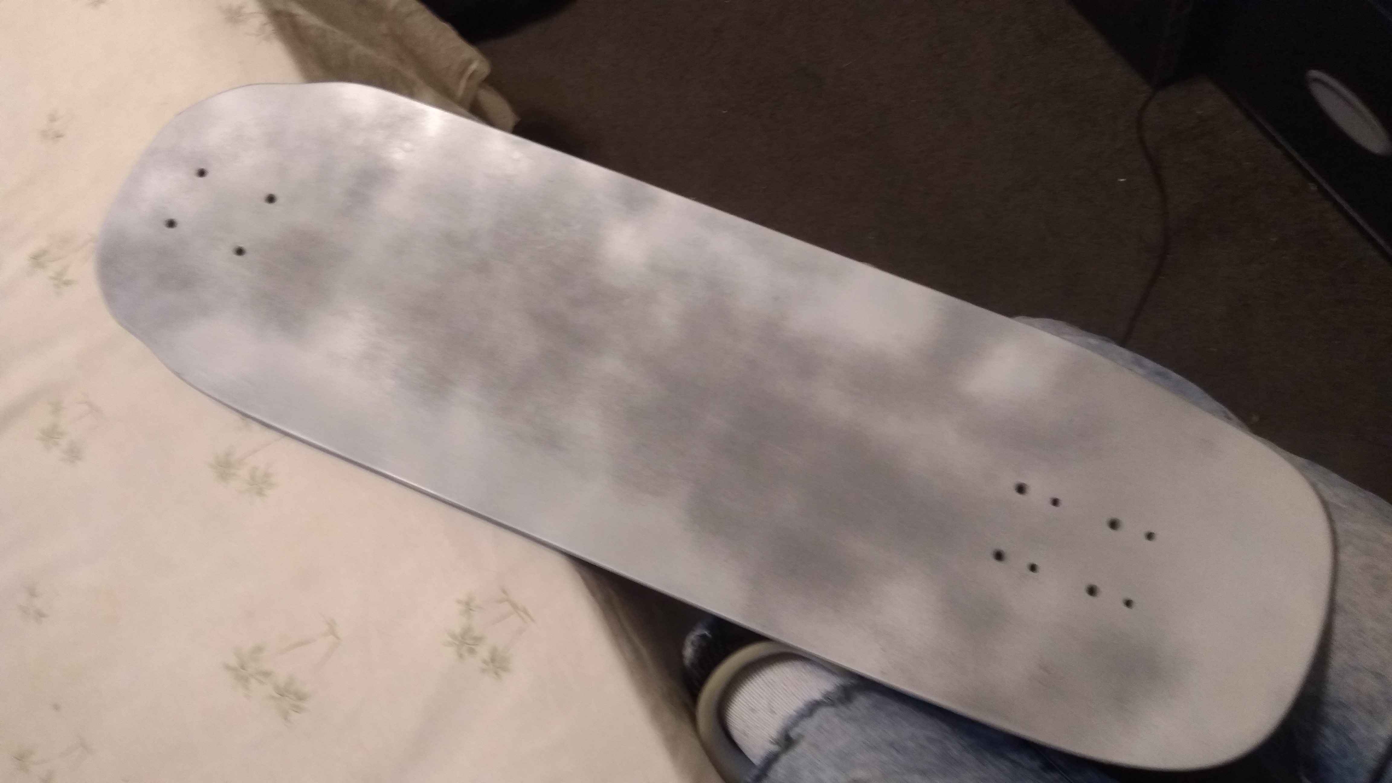

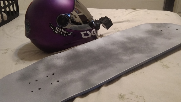

Not quite as I expected but I dig the look. Looks the the surface of the moon, dang I think I just discovered a theme.
Looks like uneven layers. Did you prime first?
It did turn out cool though!
Yep that is uneven layers and pressure. What I have used to get steady flow is this
https://www.homedepot.com/p/Rust-Oleum-Stops-Rust-High-Performance-Comfort-Spray-Grip-Accessory-241526/100670383.
I use it any time I spray something. I just used it when spraying this.

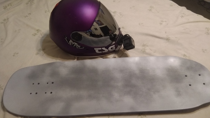

3 layers of primer, then sanded with 800 grit, then 4 or 5 coats of silver paint. I think I needed more primer.
We’re helmet+mount buddies :slight_smile:

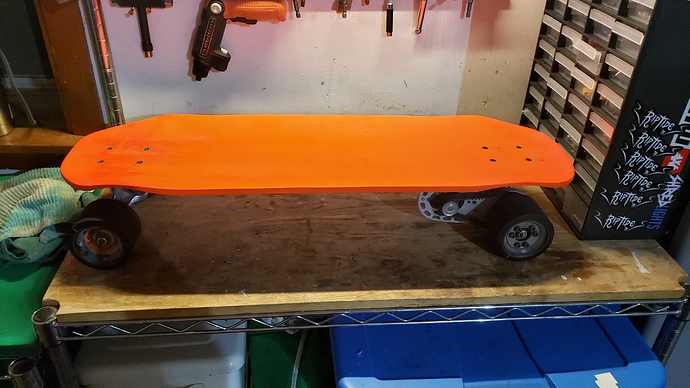

Funny. I just painted my spud with rattle cans… I expected it to be much easier than it was. I sanded it and actually started straight with the fluorescent orange… Horrible coverage. Then did a white+primer base and a can and a half of orange again. Then about .75 of a can of clear coat. I used mat finish and now grip tape is not sticking. I decided it was close enough and left it alone. When building I used a heat gun to shrink the shrink tubing for the bullet connectors and fucking took a big chunk of the paint off… If I ever try to paint a deck again will definitely be going a different route and try to do it right…
