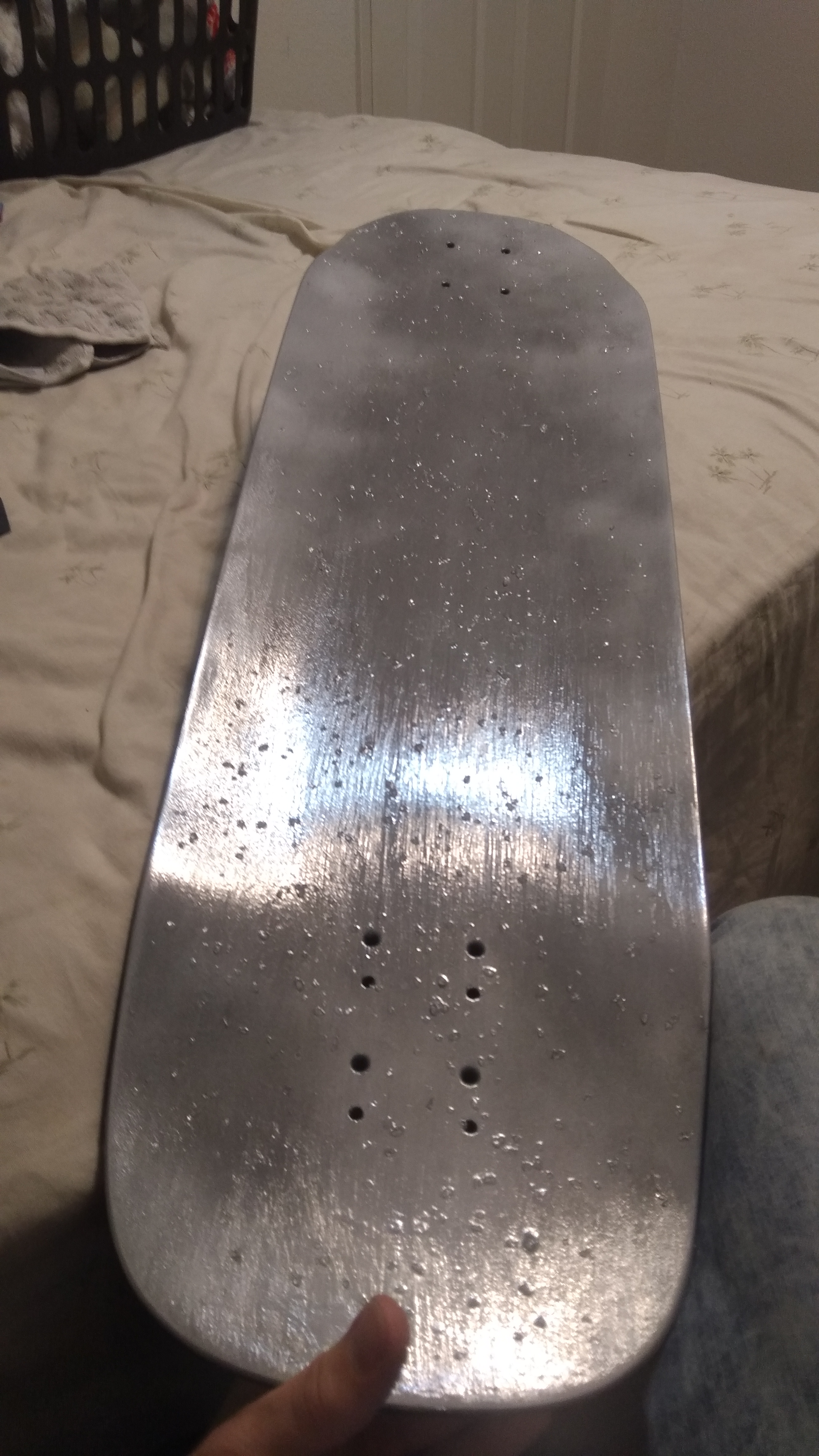

Spray Painting and Fritting a Deck
I love it.
I really like the moon surface look :rofl:
that is what i call ‘‘a pinch of salt’’ frit lol

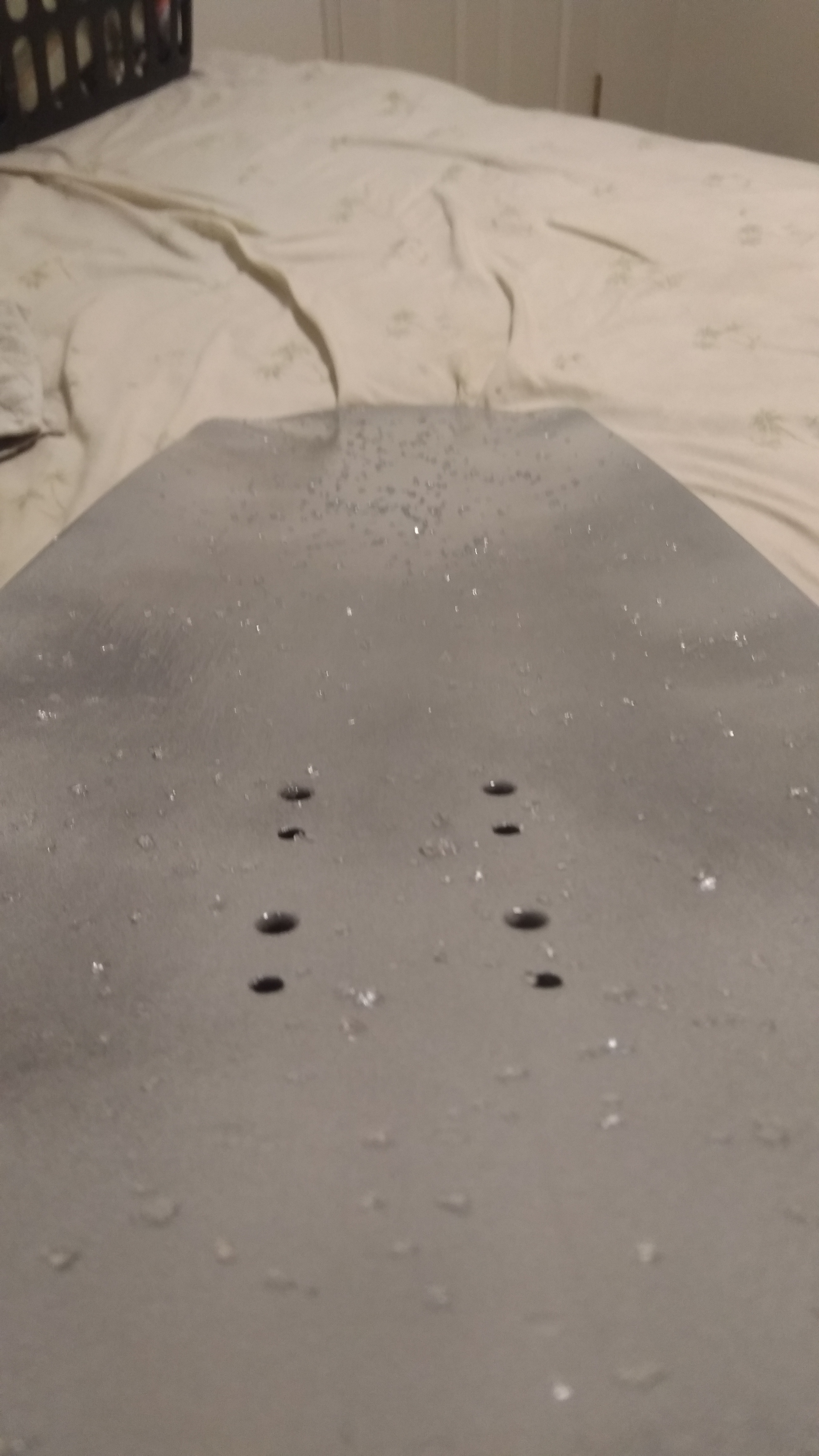

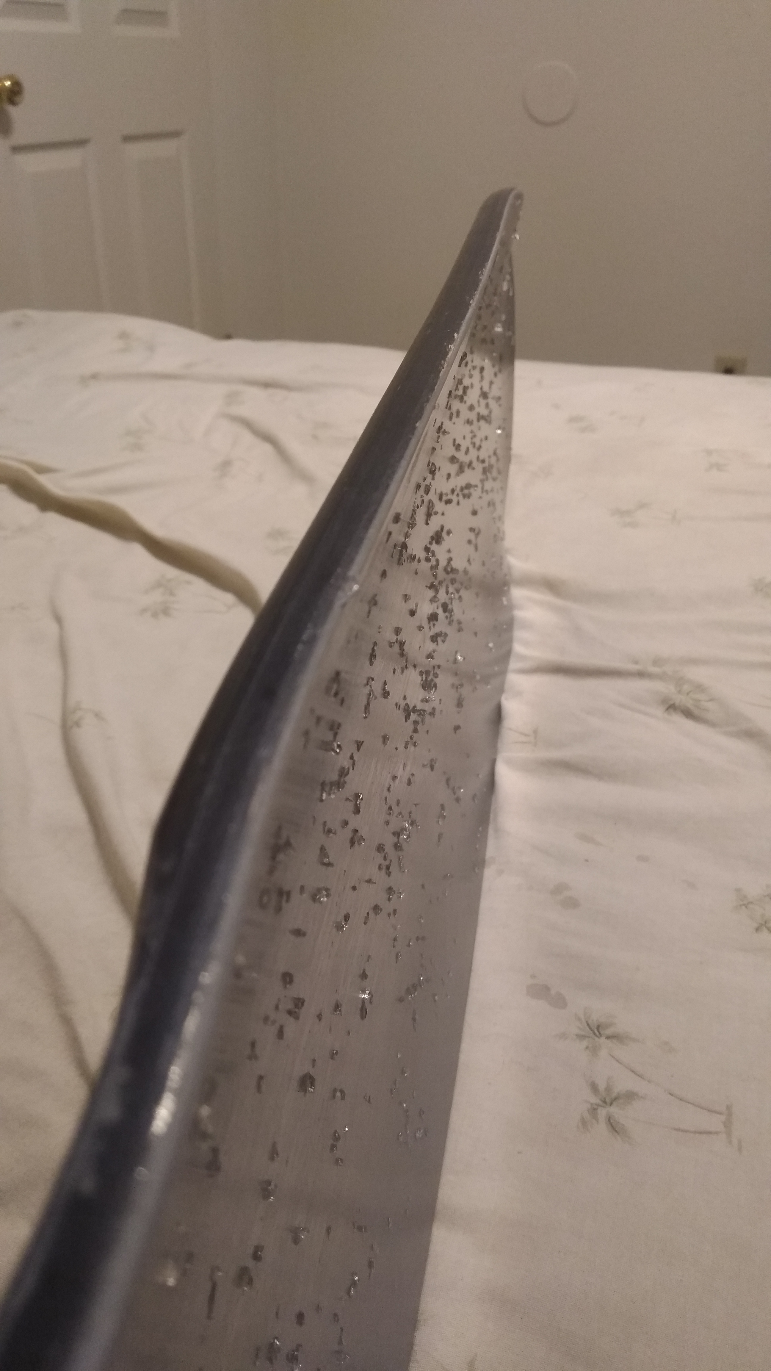

I made the mistake of adding another coat to lock in the frit and I did it in my room. Of course dog hair got all over it so I spent a good 20 minutes picking it off before it dried. Think I got it all and the glass is nice and stuck to the board. Gonna get to try it out this weekend, I might need to add more glass though.
:rofl: nice
Bet you couldn’t do that effect again lol.
I love it, it looks great.

Table. The stuff just floats around in the air. Unavoidable but I was tired and didn’t want to go outside. Lesson learned.
What is left over will give your feet a nice carpet like feel when you ride it barefoot.

Never tried Lucid but I’ve heard it looks OK if a bit cloudy but isn’t all that durable or grippy. A large part of the reason why people prefer frit I think. It’s fairly simple to do with the spar 'thane. If you have a spare piece of wood you can use it as practice when applying frit nice and even. I sprinkled it on a credit card from a height to distribute it fairly evenly.
