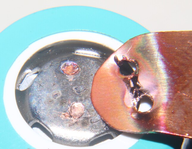

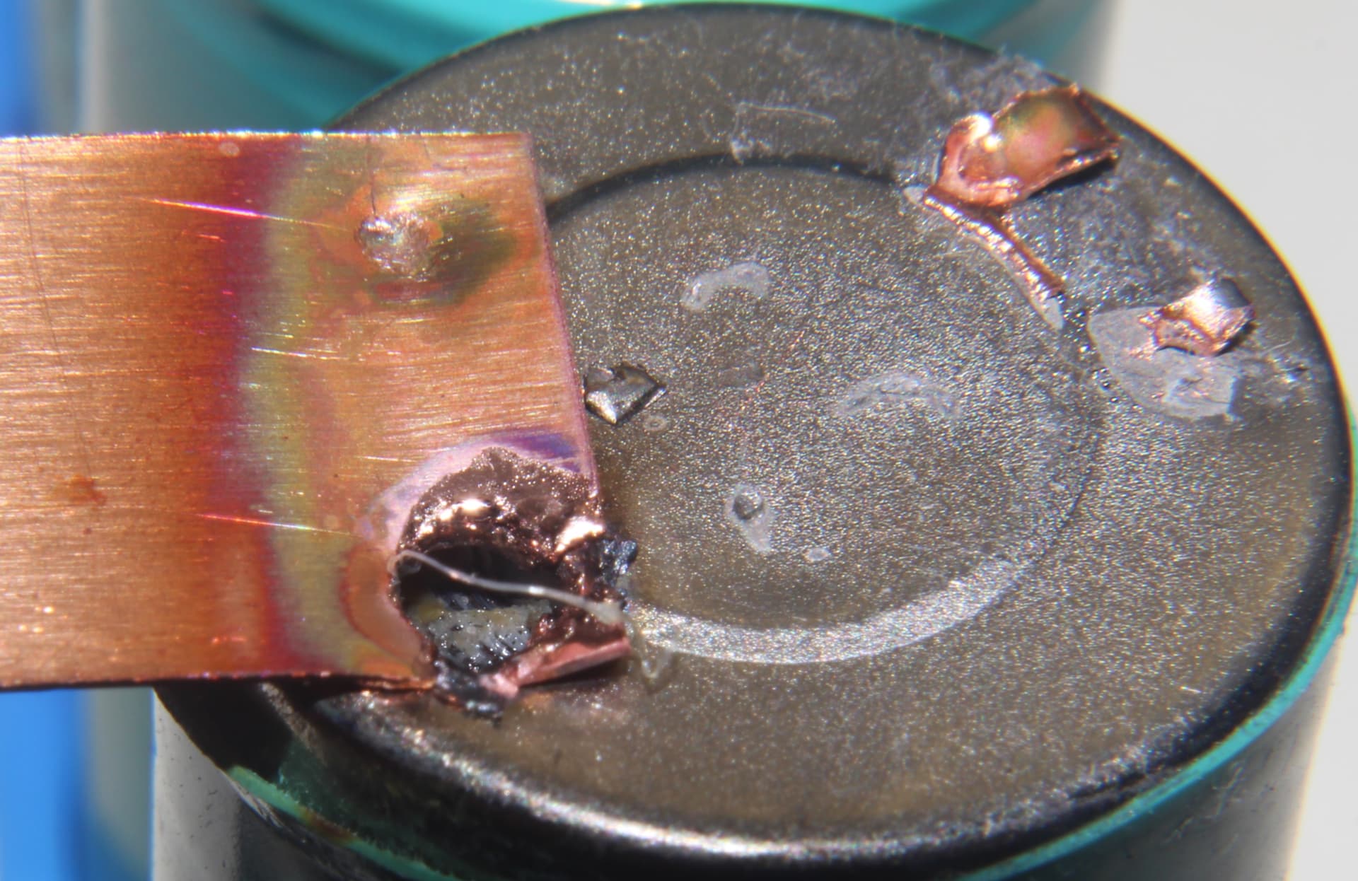

I wanted to try again, to weld 0.2mm copper, without Flooux. :smile:
I returned tre more worn, wider tips into the welding pens and insured they were clean and the same size and shape
Gear 700, No preheating, triple pulse, 2MS interval between pulses.
Carefully positioned electrodes with equal pressure.
Result = stinky electrolyte geyser which laughed as it bypassed my newly tuned Hepa charcoal air filter.
Pretty sure it happened on third pulse.
Looks like the electrode tip melted some separator plastic and pulled it outside the cell. Good thing it was drained to 0.0623v
The other electrode did not stick at all.
So this is basically the same result as the last time I tried to weld 0.2 copper without flux.
I still have more power available.
Perhaps these Wintonic cells have super thin cans.
Perhaps That raised portion in the center of Anode/ negative/Can allow them to use thinner steel.
I guess I can try welding the cathode tab, but I am leaning against the viability of this welder to weld 0.2mm copper no nickel sandwich, no Flooux.
0.2mm copper alone is VERY hard to weld without flux if not impossible. 0.1 and 0.15 is easier.

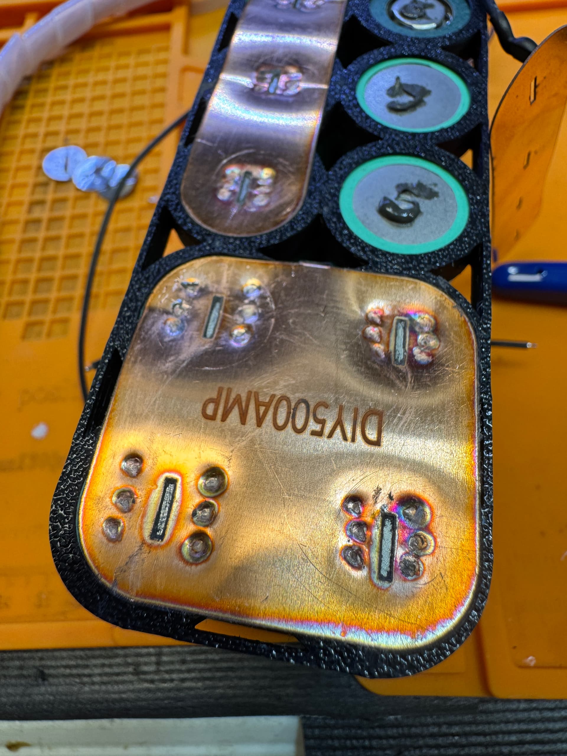

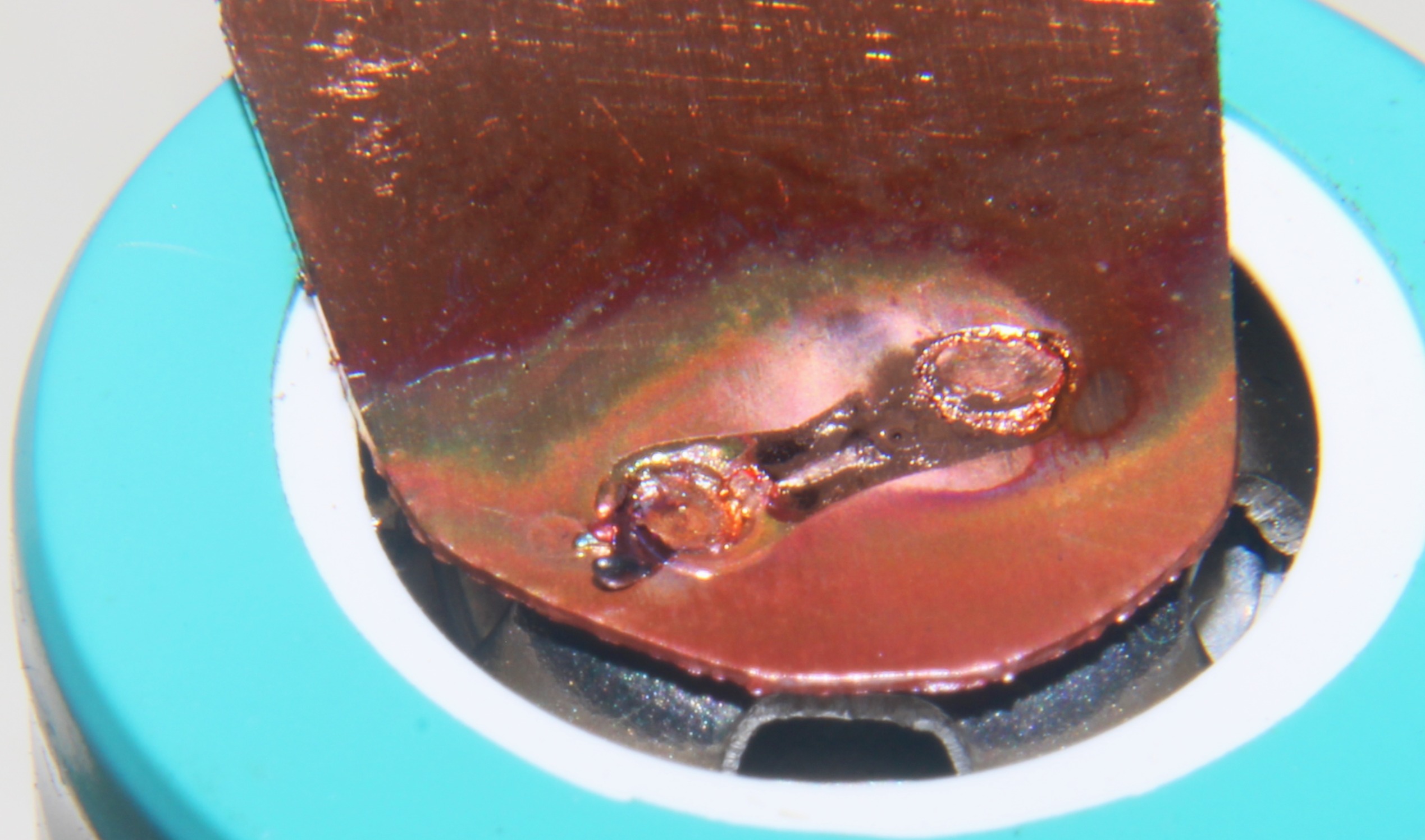

This one is Pure copper 0.1mm straight to the cell without flux spotwelded with the SUNKKO 73B Pen.
This one is Pure Copper 0.3mm welded with the AWithZ P60F using flux.

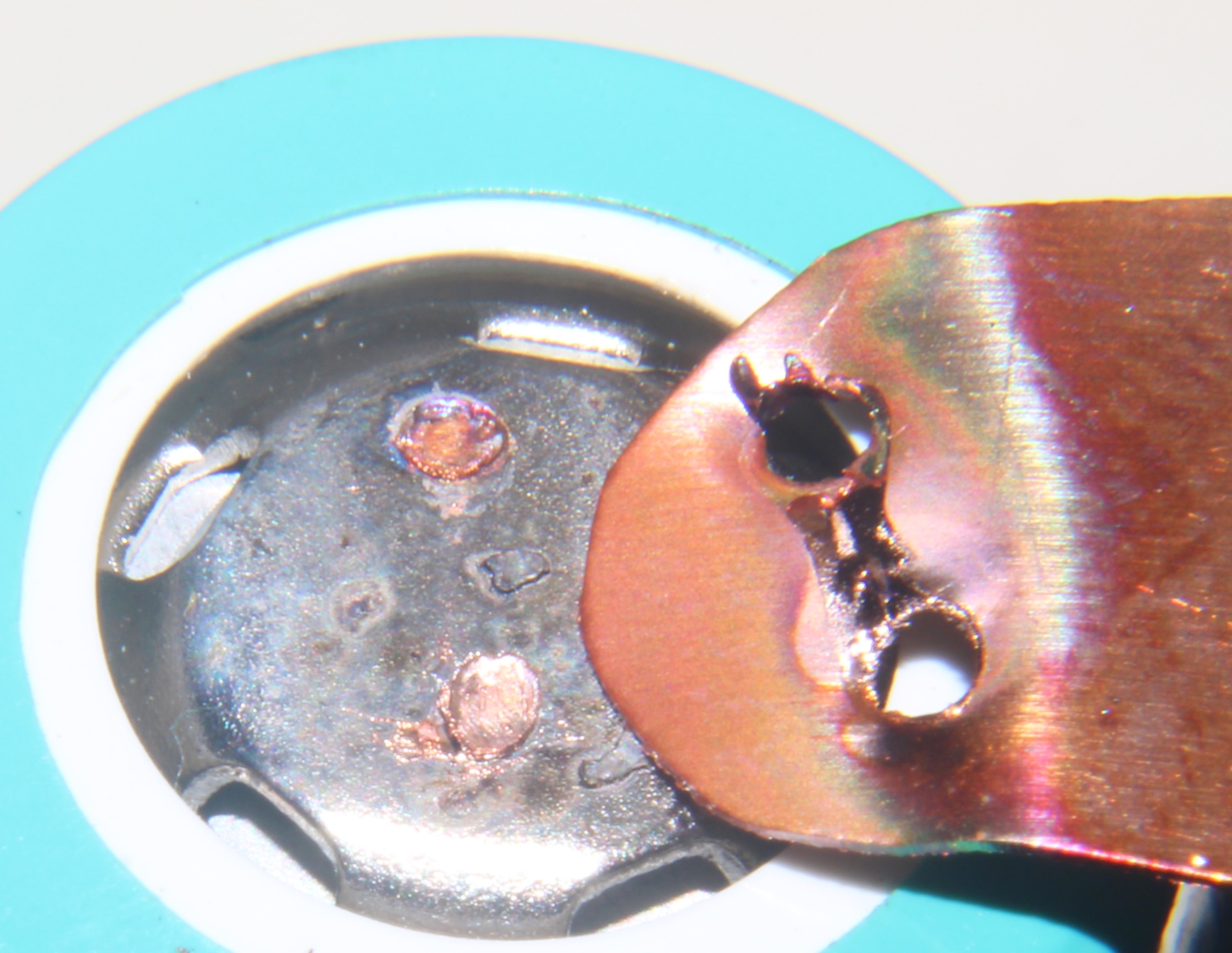

I carefully filed the electrode that had can steel stuck to its tip, and made sure it was same size and shape as the other.
Flipped a cell over in holder and tried welding the + tab with the same settings. no Flooux
No preheating, triple pulse, 2ms interval
Two very even, weak welds lifted off very easily.
Tiny holes in copper, didnt bother with photo

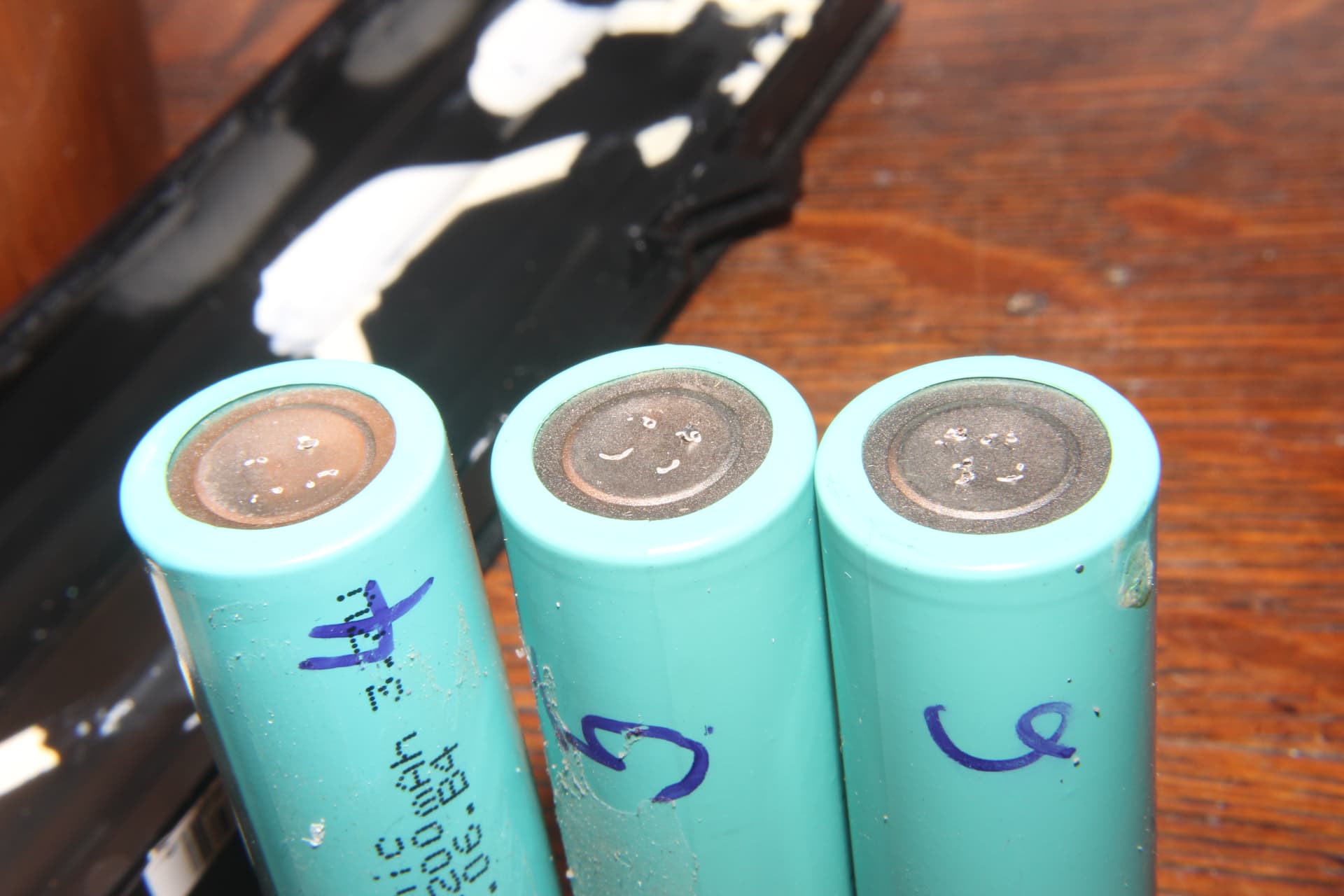

Tried again with gear 750, 1ms interval, triple pulse.
Notice the steel colored ejecta on the weld on left. That is not a weird reflection, it is steel colored. could there still have been steel stuck on electrode? I was pretty sure I got it all, but perhaps there was some on the side.
It too lifted off pretty easily, but left the copper behind.
Yowch…
Could this have happened because the center of the bottom of the cell is raised so you didn’t have as much pressure on the copper as you thought?
I made sure to press really hard and conform the copper to the shape of the raised portion, then let off a bit and use normal pressure before the weld.
I think that raised portion design allows them to make the cell can thinner.
They were pulled from an old Aftermarket Dell laptop battery and the cans on the two worst performing ones, on tear down, were compressed the most.

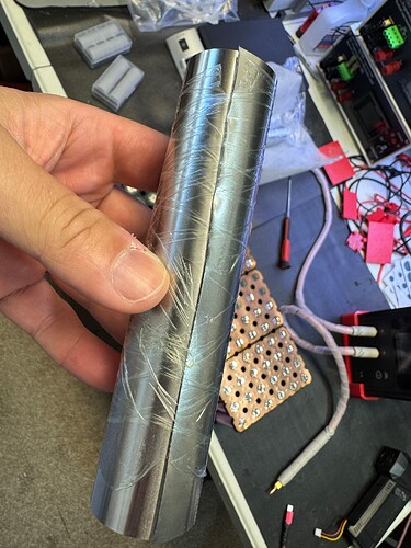

The marine Stainless I have is 0.5mm thick. Pretty stiff and strong. I know it is of little to no purpose in battery building

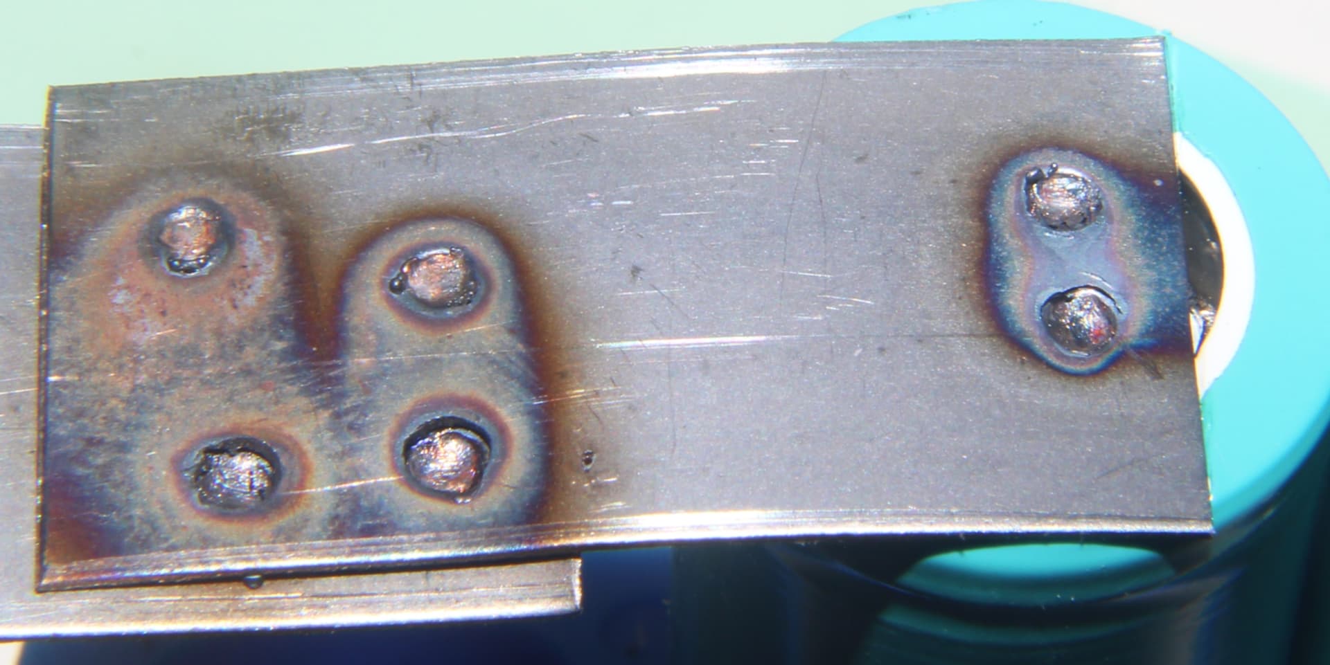

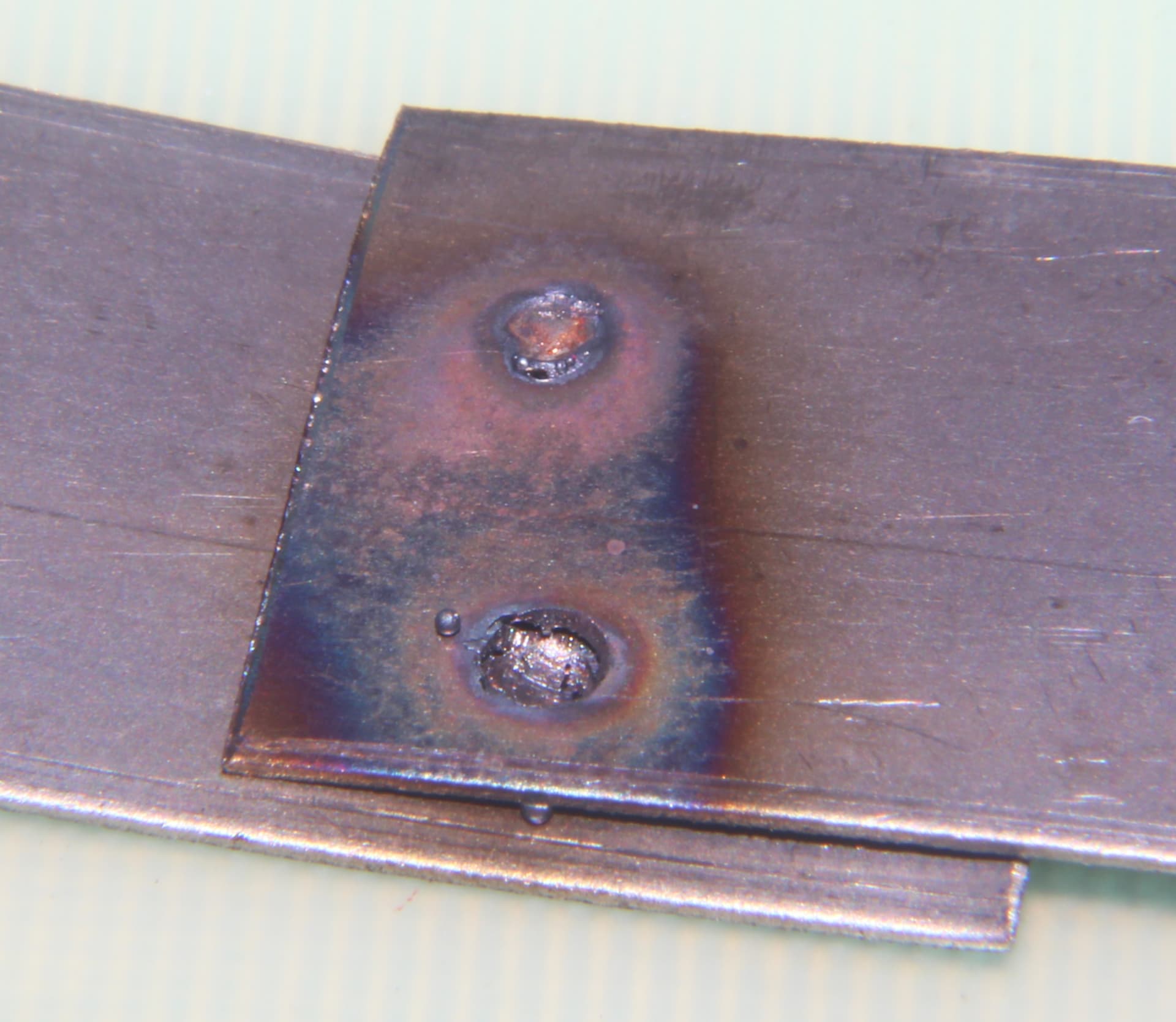

I used the gear 750, no preheating, triple pulses, 2ms interval to weld two not quite flat pieces together. There was a small gap on bottom weld Did not notice until I took this pic and put it on computer and zoomed in.
Still amazingly strong.
Amazingly, NO Sparks! The electrodes made almost no attempt to stick to the weld. This is the exact opposite of what I expected.

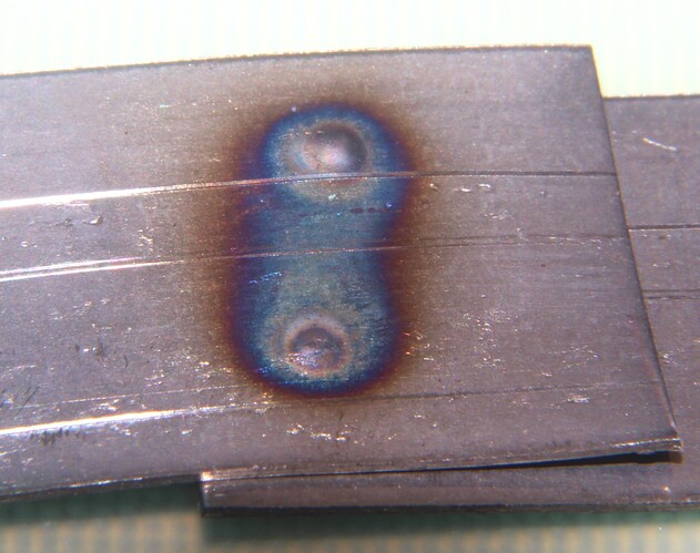

Underside:
Added a second weld, same gear and interval but 2 pulses instead of 3.
I figured why not weld it to a battery cathode +. I used NO flooux.
Ripping it off was not happening. Rolling it off took a lot of force, where it felt like I was going to pull the tab out of the battery, but once it started moving it came off easily.
I find it very interesting that this cell is one I had welded copper to before using Nelvick’s Flooux. The Flooux obviously tins the copper in immediate proximity to the weld, but it appeared to NOT tin the nickel of the cell itself.
When I tore off the stainless, the layer of tinning from the Floux came off with the Stainless.
Maybe this ridiculousl stainless could go on top of 0.1 copper, and make a rigid battery, which could then keep the deck and enclosure from flexing :crazy_face:

Blowing a hole in the cell can with 0.2mm copper, no flux, has to be a combo of factors. The raised center ridge likely allows the can to be thinner, and even though I used a lot of pressure to conform the copper to the can before pressing the foot pedal, there could have still been a gap, and the air in the gap expanding could have lifted the probes in my hand on first or second pulse, and then the third pulse blew the hole into the can.
The other time I punctured the can there was no geyser. I had to look close and give a sniff to confirm
Welding 0.2mm copper on the cathode no flux worked fine. In my opinion even though the welds were good, the 0.2 copper peeled away from the welds too easily. Perhaps too much power, or I am too used to peeling 0.2mm+ worth of nickel plated steel sandwich.
I am still of the opinion that 0.2 copper by itself is just not strong enough.
My stacked 0.1 and 0.15 flux’d copper tear off felt more than 20% stronger than 0.2.

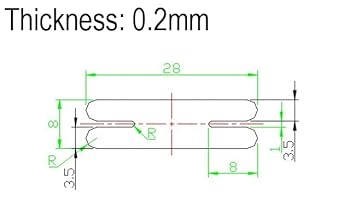

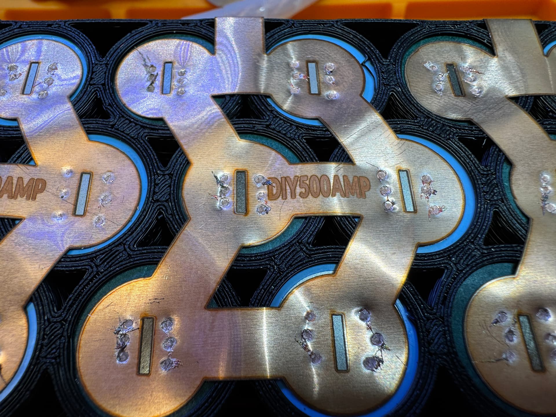

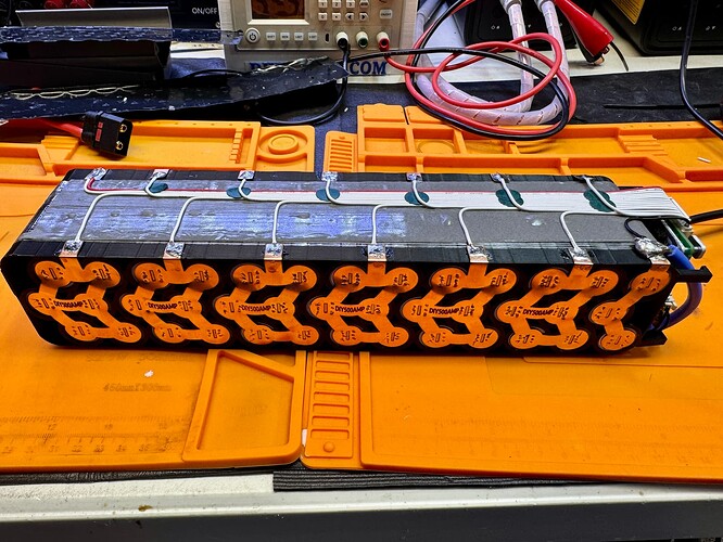

Took note and ordered some .25 by 25mm sheet plus som of the tined or plated copper from @DIY500AMP.COM with some flux and tips with the welder
Might look at some silicone bronze rod to make some more durable probe ends if they are wearing so fast. Might be helpful but im not gonna try it until after i get some use on the thing.
Gonna build something fun then use it way under capacity first and get some vibration on it. Have a 12s2p that only needs 80a but ive got space to over build the pack and try to max out the cells. I’ll build it like it’s gonna need 160a just to figure it all out. Gonna be interesting

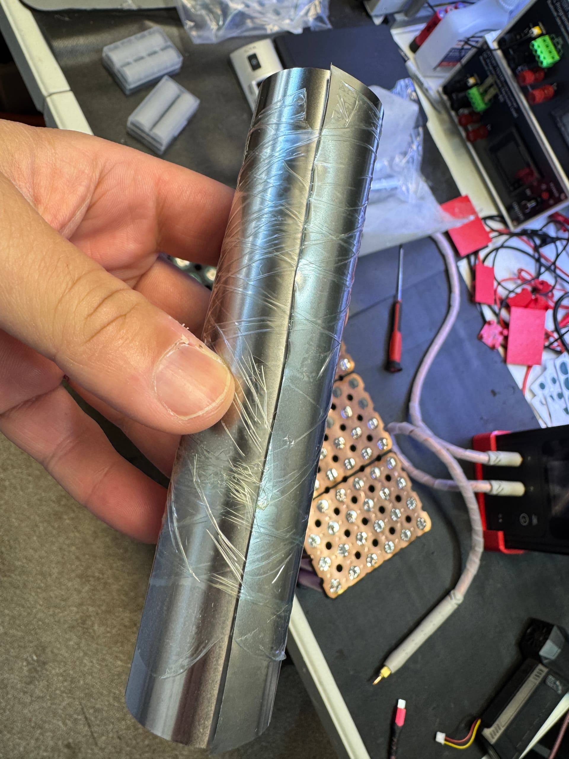

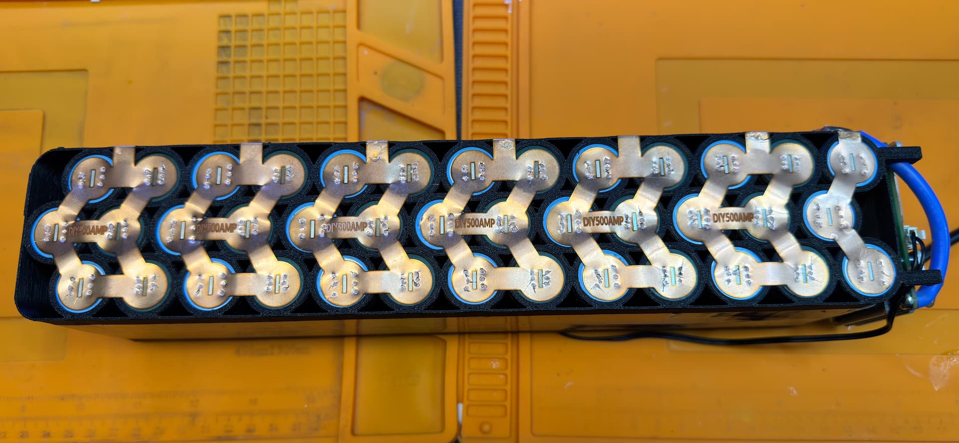

I just received a roll of 304 stainless steel. I will be sending few cuts for @SternWake and @Pecos today for testing too. Let me know the size of your strip. I can cut in the laser.

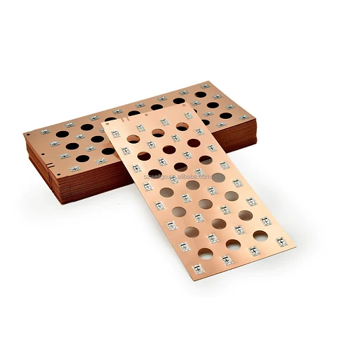

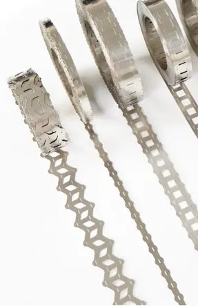

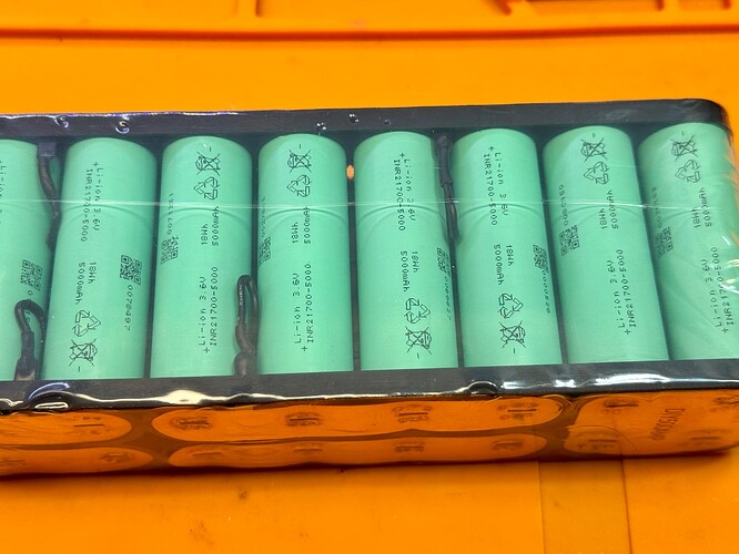

A single row continuous section with slit holes every 21mm like this center roll would be useful i think:
IMG_2620
Simple 2p straps like this may be easier to fill the sheet and would be useful for adding the ss sheet as reinforcements though my preference is to have the simple slit vs a the open fork like this drawing
IMG_2621

I need to make the template. But I can cut small strips like 10mm x 150mm just to testing. I may have a good feeling. I will be testing this today as well.
The very existence of these assemblies is proof that copper can be welded to Steel and Nickel consistently and effectively. The availability of 15 and more kilowatt welders at affordable prices makes building them yourself reasonable if the process can be figured out and streamlined. Doing it collaboratively on the forums helps spread the costs of trial and error out and introduces new fresh ideas.
Kinda the whole point of this forum ¯_(ツ)_/¯ it’s not all about that boty prize pool :rofl:.
Blowing holes in cells is just a nice little bonus. Not really the goal here so much as literally the purpose of this thread to sus out how to avoid.
Let us cook, im sure (though i have no direct experience) those work really well. Not sure if the nickel connection would withstand 125a but it’s possible with the cooling offered by the giant copper bus that it’s a non issue, until you look at voltage drop at high amps and volts. Could quickly add up to more than .3% and start being a bottleneck when all added together. Removing the bottleneck is not necessary in every purpose you can make a battery for but that’s not where direct copper makes sense anyway.
And fixing it by using thicker nickel seems like the same problem - needing more beef in your welder so why not remove an additional connection point and higher resistance point all together due to the welders now exceeding the threshold needed to weld pure copper when they can weld .4 nickel

As well as direct copper to cell action, especially with the flux, the welds look a lot beefier than traditional nickel welds.
