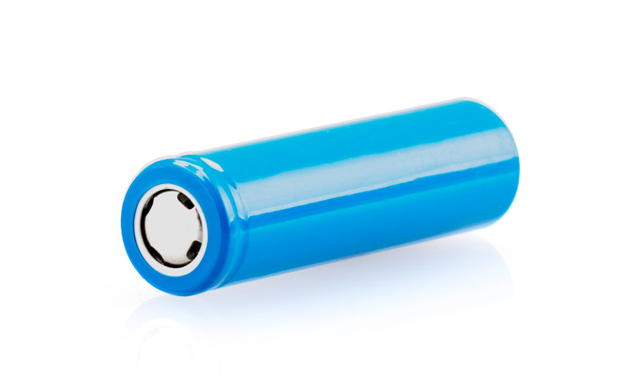

@Battery_Mooch are these type of empty cells what you were thinking of. They seem to be out of stock stateside everywhere im looking. Found some on alibaba but i can dig more and find something somewhere im sure.
If you have a different preference for testing i can gather the components and put samples together.
How many examples of each setup should i make? Not sure how how many would be representative or if the tests you have in mind will require multiple samples for different tests
I didn’t notice the ‘out of stock’ part on that dummy cell listing.
Sorry.
