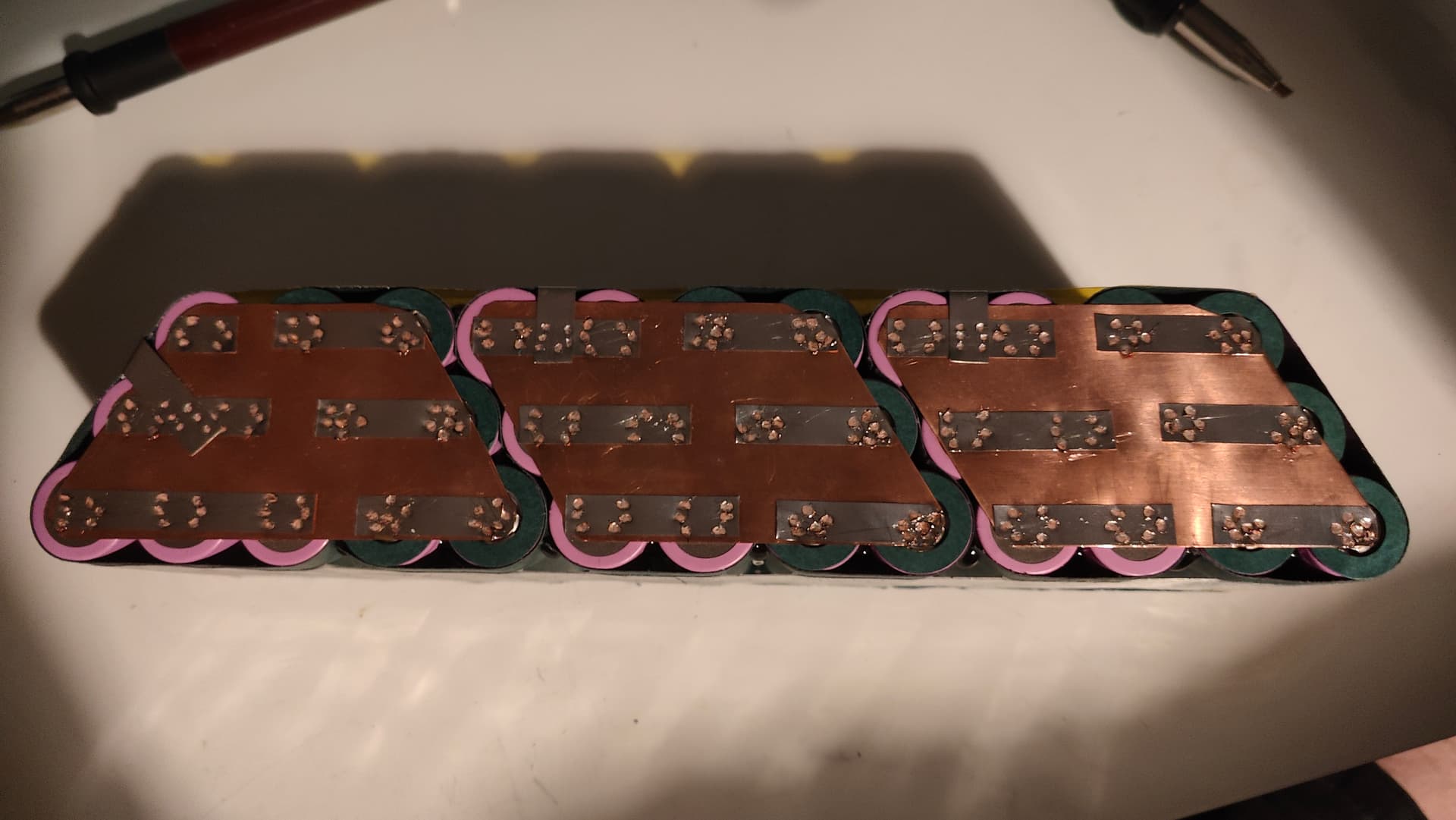

My 0.3 copper 0.1 steel sandwich welds on the glitter 811h at 65% are so strong I teared the cell housing instead of the copper strip. 0.2 nickel feels significantly flimsier by comparison, it took a lot of force to roll off this weld with needle nose pliers. That was a P42A which has a relatively thick can

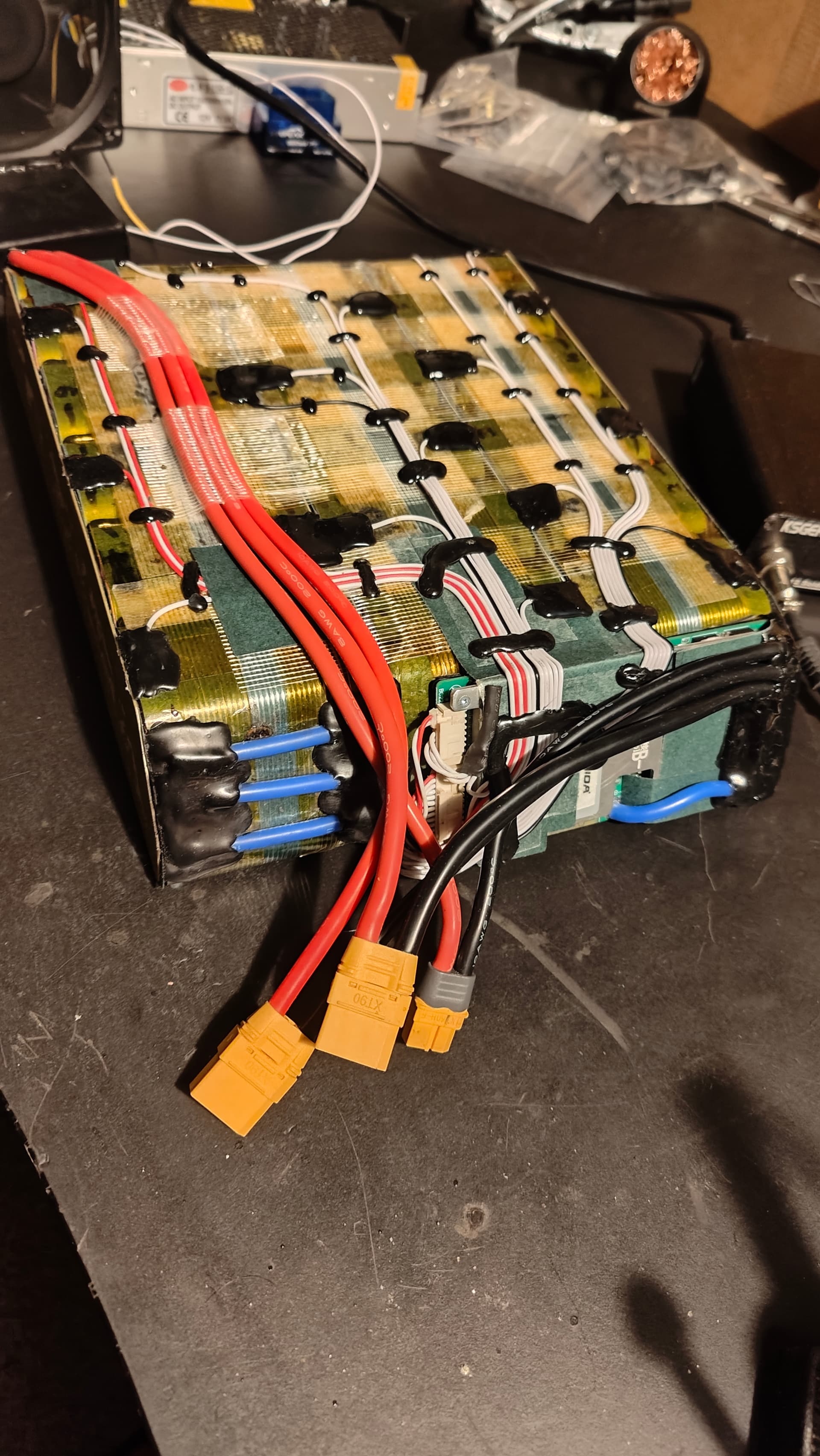

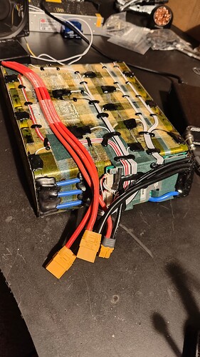

Here an 18S6P pack that I built with 0.3 copper. BAK 45D cells. It’s performing incredibly well in a raceboard
You can see the thickness of the can in the photo :exploding_head:
Makes me wonder if the weld weakened the can?
Judging by the amount of force it took to open it up, it probably didn’t. It was super hard to roll off the copper. Didn’t suprise me that the can was torn, since I was barely able to roll it off. It’s multiples of 0.2 nickel + kweld weld in strength
