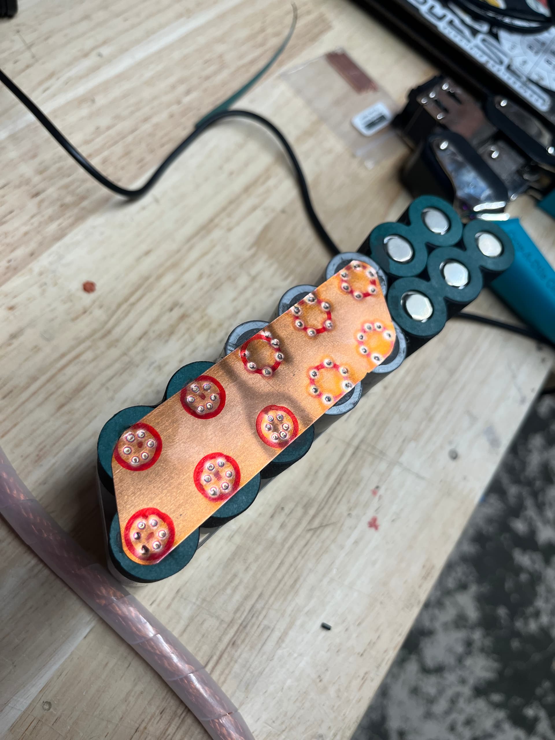

Ok, review of the double pulse im getting from the p60f: using the brazing flux and welding .3mm copper to rs50 cells at gear 400 preheat @.3ms intermittent @.2ms. Continuous welds set to 1 in manual mode.

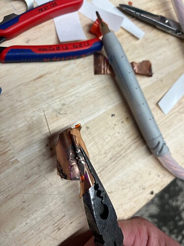

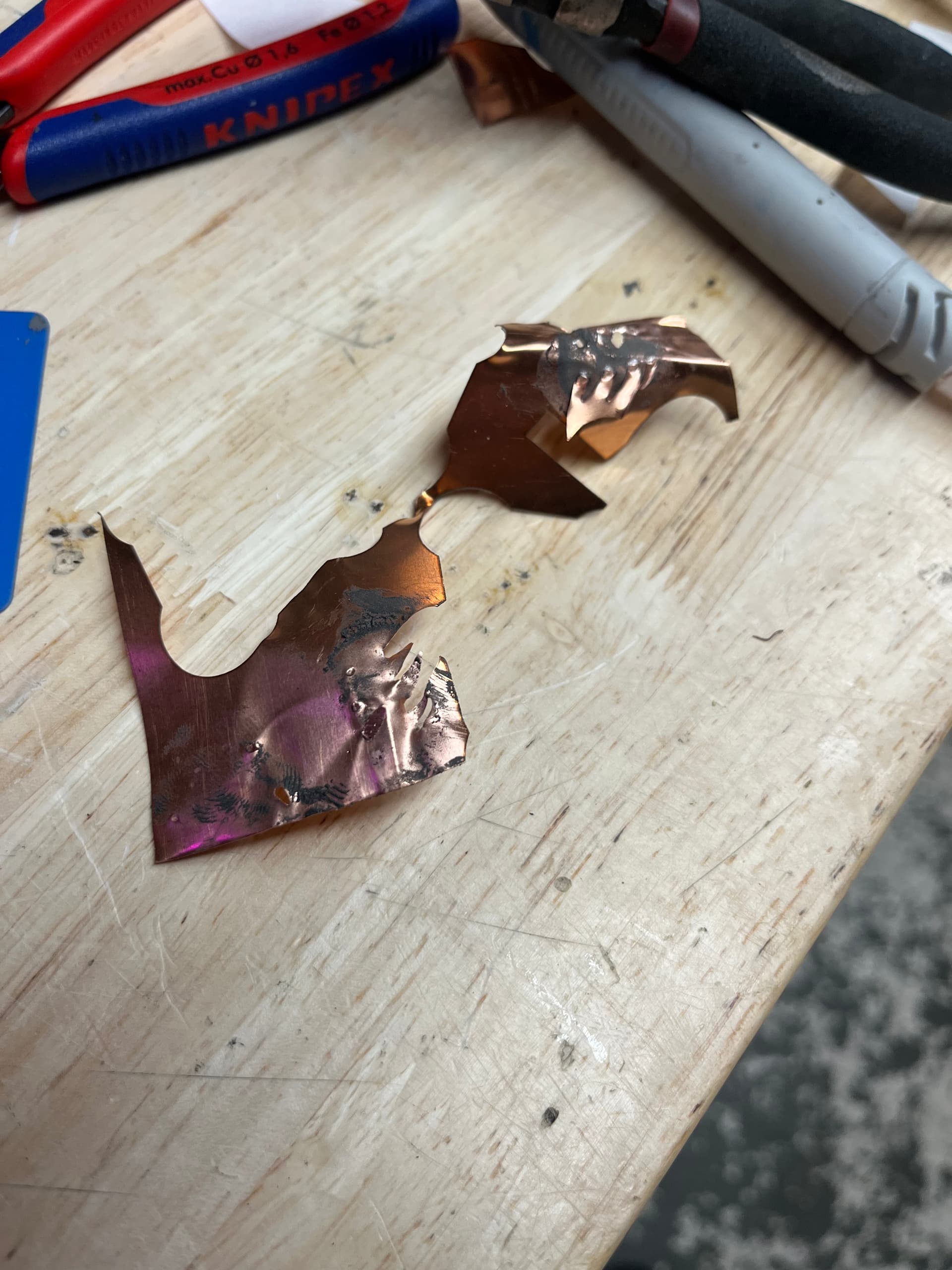

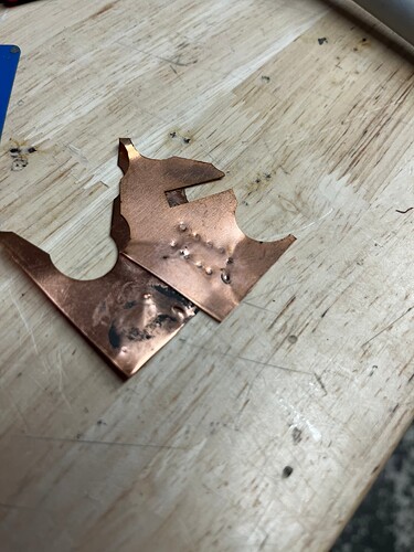

I increased the size of the copper im using so that i get more overhang on the edge cells and keep my welds about 2mm from the outside edges. When welding a single pulse has good attachment even when very close to the edges but a double pulse can burn through, with a little more clearance the double weld is nearly indistinguishable from a single pulse. There are two sets of welds in the picture and visually it is impossible for me to distinguish them with marking.
Did a tear off on a dead cell and the double pulse isa little stiffer to remove but doesn’t seem too far off from a single
Two incidents of a double pulse in 30 sets of welds

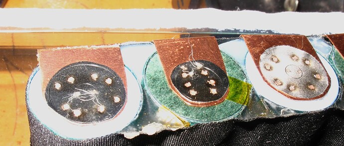

I have been scratching a ring with a sharp awl, for excluding the 6mm center weld spiral of EVE 40PL, and to confine welds within the 10MM circle on positive tab. I find it really helps positioning the strip on the cell, as my ability to tin snip perfect circles is lacking.
My previous esk8 batteries with 0.1mm copper I would bring the 0.1 nickel plated steel up over the shoulder and tack spot weld the stainless to copper before welding proper to the cell, but this is 0.2mm copper and is not so flimsy.
This pack I decided to not weld across the spiral/ center and tried to keep electrode distance the same, and 4 pairs of welds on the Anode, 3 on the cathode were what eventuated.
The two welds in the center spiral are just the gear 002 tack welds to tack weld ss to copper off the cell, same as the two at the top of the cathode weld. Sorry for the cotton Qtip fibers, I dont notice them with naked eye.
This flexible 10s1P pack, the gaps between each fishpapered cell is filled with silicone, two different types, one much more clear than the other. I figure it is far better than dead air space for transferring heat from cell.

Just messing around, copper to copper can weld pretty well with the magic paste, seems to take a bit more to get a sandwich connection consistent but the mated surfaces are obviously cleaner. Even putting 8 rapid consecutive welds the sheet is warm but not hot to the touch.
