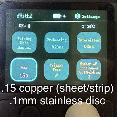

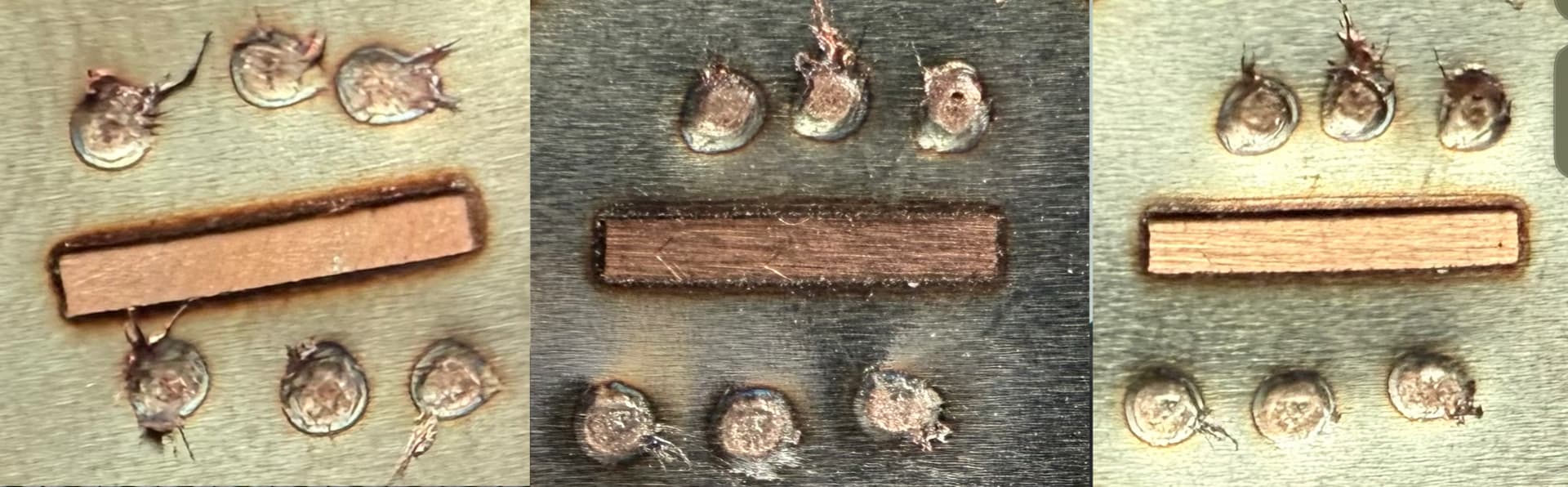

Basic level achieved! Here’s a pic of those welds I was mentioning above:
.1mm stainless | .15mm copper | P30C at settings shown.
How u get the slits in the ss?
I have not yet tried to weld across a Slit. Mostly as making an imprecise slit with a dremel already makes a tedious process more so.
The slit should be more effective ( in allowing lesser power levels to achieve the same weld) if the Slit was in the copper too.
I read a white paper saying that the Slit decreases the size of the spot weld, but they were using tungsten electrodes and it was not so much a slit but a 2 pronged fork and reducing the length of the fork’s tines made for a wider weld.
Looks like a lot of the SS ejecta, is almost parallel with the SS striations. Try maybe less duration of preheating?
I have gotten that same amount of ejecta when using a bit more power than actually needed, but all my succesful welds, when cleaned with a q-tip and rubbing alcohol will catch some cotton fibers, even if I try and press them down with a rounded tool and pressure.
If the tear off strength of your welds is acceptable, then I’d say you are pretty close to the ideal settings, at least on those cells with that material thickeness.
I believe they’re cut with a fiber laser, but @DIY500AMP.COM cut them for me as a custom job - but I feel like there’s got to be a market for having some non-custom options. I saw a video he posted with these SS discs with slits and was like “TAKE MY MONEY".
Thank you very much for the feedback! This is actually where my settings were going:
Gear 230 | Zero Preheat | 1 Pulse (for the same material combination). Still need to test some though. I’ll try and post some test welds sometime with the final settings. I do think I need to clean these discs though. Fair amount of burn from the cutting process that I really should address.

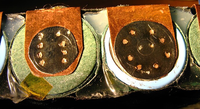

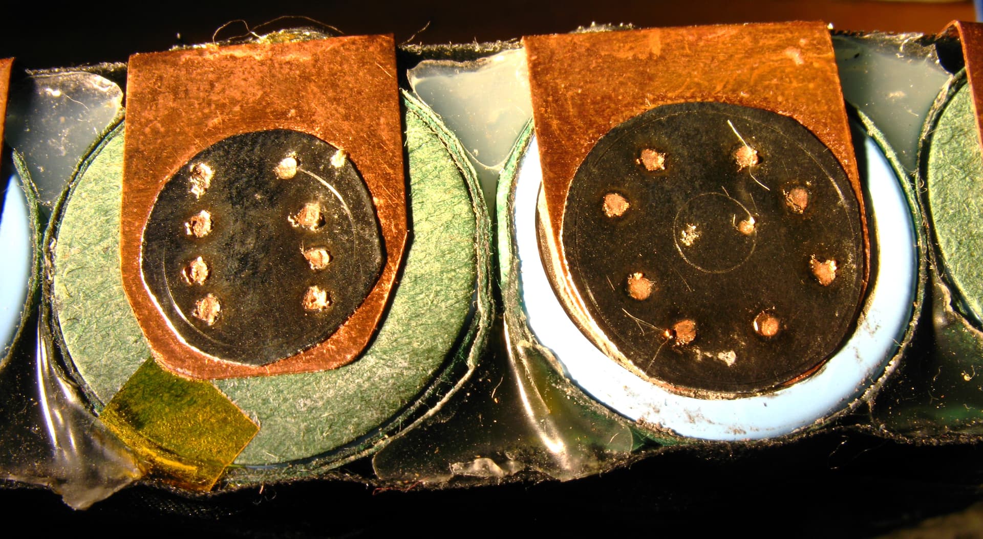

Here are some of my latest welds when building a 10S1P Eve 40PL
AwithZ P20B 14.6kW
0.2mm copper under 0.1mm stainless steel
Preheating 0.10ms
Intermittent 04ms
Gear 385
Number of continuous spot welds 2
Interval time of continuous spot welding 0.2 second
With Flux.
The cell on the left the two little spot welds up top outside the scribed circle, were just to adhere the SS to the copper before welding the sandwich to the cell. a positioning aid.
Same for the two welds within the small circle on the cell on the left. The scribed circles help greatly when positioning the sandwich on the cell, and on the negative of tabless cells that have the center weld spiral, one needs to avoid welding atop the spiral.
I am not so concerned with minimum size or weight so each cell is individually fishpapered, with an extra layer around the cathode+ shoulder, and I used silicone to fill most of the gaps between cells as silicone is a better thermal conductor than dead air space.
Love this pic, all the info for reference. ![]()
Im going to start doing the same so hopefully helps someone in the future easily find a good starting point to get settings dialed in

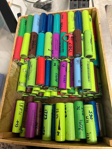

going through my recycling pileto try a bunch of different settings to eliminate the double pulseAs far as heat distribution and dissipation into the cells, anecdotally I noticed that the weld is touchable much faster with copper than with nickel. I don’t have any perfect comparison because i am using.3 copper and .2 nickel as my standard material thickness but i have touched recently welded nickel and have to pull my hand away quickly to avoid a burn but can press and hold a copper weld with significant pressure after a couple seconds. I think that the copper wicks the heat away into itself much quicker because it is such a better conductor and therefore should quickly bring the temperature of the weld down and distribute the heat throughout the copper preventing more heat input into the cells.
I don’t think either are a significant impact on the cells nor are they avoidable with this form factor of cell but it’s nice to see it isn’t worse in than nickel welds.
