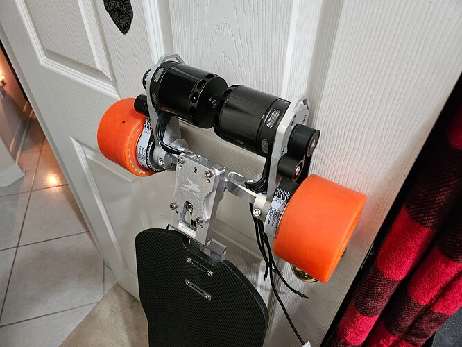

THE TRUCKS
So, with my prior experience with RKP trucks being pretty mediocre and uninspiring, i decided to try out a set of TKP trucks awhile ago on my pushboard (a loaded fathom). Me being me though, regular Surf Rodz TKP’s just weren’t shiny enough. Hence, the advent of the @IDEA Surf Rodz TKP 180 and 150 hangers, narrower than his prior 220 or 260 offerings, and also introducing the option to flip the hanger on the bushing seat to change the effective rake and ride height. Additionally, these hangers use a stronger M8 bolt rather than M6, and are full billet aluminum. The initial plan was to use 180mm hangers on this board to keep it as narrow as possible, however i pretty quickly realized that i wouldn’t be able to do this, for reasons you’ll see in the next category, so this board is on a set of his 220 hangers. Still relatively narrow, and plenty shiny enough for me. And of course, @RipTideSports bushings and pivot cups all around.
Shiny Stuff Goes Here
THE DRIVETRAIN
So, with my preference of thanes or BRP’s, and me wanting the ability to fine tune the drive ratio, as well as the recent use of thane belts courtesy of @Tony_Stark (he makes some great shit), the choice there was pretty obvious, despite my prior experience with the bioboards 4:1 helical cut steel gear drives being positive. So, to cover as many gear ratios as physically possible, i went with the @Boardnamics press fit wheel pulleys in both 36 and 44T, as well as designing my own 53T set as shown here (Interest check for >50T wheel pulleys compatible with BN/SR125). This combined with motor pulleys in 15, 16, 18, and 20T gives me the ability to select from ten different ratios, all the way from 1.8:1 to 3.53:1. For motor mounts, i had to go with the @IDEA mounts, and i have a couple choices here, his idler mounts or the shorter ones. For the time being, it looks like i’ll be using the idler mounts in the rear and the short mounts up front. Lastly, to allow for the use of BRP’s, i’m going to be making my own wheel hubs that use the Radium SR125 interface, to be compatible with my 53T pulleys.
The spinny bits
THE MOTORS
With this build being 4wd and performance oriented, the choice was obvious to go with Reachers - My prior experience with 7490s and 6485s from @Skyart has been excellent. The initial plan was to go 6455 and mount them inboard to keep things as tucked away and stealthy as possible - however, this was not possible due to clearance issues, even with wider 220 hangers. Since i was going to have to run the motors outboard mounted, there wasn’t really a reason to stick to 180 hangers, so i decided to make the change to a slightly wider set of 220 hangers, and larger motors. One RFQ on alibaba later, four 220kv 6475 motors were paid for and on the way.
Six motors into a four motor board later

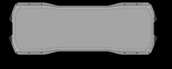

Also, here’s the last version of the enclosure design. Needs a lot of work, as i didn’t realize the IDEA deck isn’t symetrical front to back haha.

The IDEA deck platform is amazing, but enclosure options are a bit sparse, besides the eboosted ones, which are great - however, i have some gripes with them. The SS enclosure is too shallow for me to comfortably put an esc underneath the brackets, and the DS enclosure is thicker than i need. So? I’ve been working on developing my own enclosure in between SS and DS thickness, as well as taking up more of the available surface area. Hopefully, this will let me run the two VESC’s and give me decent space for batteries in there in the future, while still having somewhat reasonable ground clearance.
So, with the reasoning aside - A couple months ago i started modeling the first version of this enclosure, and the associated 3d printed mold.
However, those with a sharp eye might realize that i didn’t account for the IDEA deck actually being different front to back, and not symetrical. Ontop of this, it’s a very complex shape for no real reason at all, and would generally just be really annoying to do carbon fiber layup on. So? I’ve been wanting to re-do this model for quite some time. With that, i finally present, the much simpler version two of this enclosure.
Also, after some more experience working with carbon fiber, i don’t think i need to make a negative mold - Instead, i’ll be directly printing the positive form, and then laying carbon fiber over top of that. Hopefully, i’ll be able to get a relatively decent surface finish with the epoxy on the exterior still, and if not - well, i can either add extra epoxy and then cut down, or i can design a negative mold for this design and go through that again.
So, what’s left? Well, waiting for my bulk order of filament to come in, optimizing the form for 3d printing (as it has to be done in sections, even on my huge neptune 4 max printer), and then sorting out all the carbon fiber layup materials i’ll need to order more of. The only other things i’m considering doing for this enclosure design are
  • Integrating 3d printed flanges in between layers of the carbon layup, to increase strength there and provide some more stiffness than the otherwise thin carbon layup would have
  • Integrating some ribbing along the bottom of the enclosure for some steel rails, so that i’d scrape those, and not the carbon enclosure itself (this board is going to be pretty low)
  • Possibly integrating some 3d printed cable passthroughs on the front and rear for some fancy panel mounted motor connectors (superflux connectors?, but god help me if i have to spend $280 on just connectors)
  • 3d printing a holder of sorts for the QS8 loopkey and charge port.
  • The possibility of using some sort of automotive quick release pins instead of bolts, if i can source any small enough.
