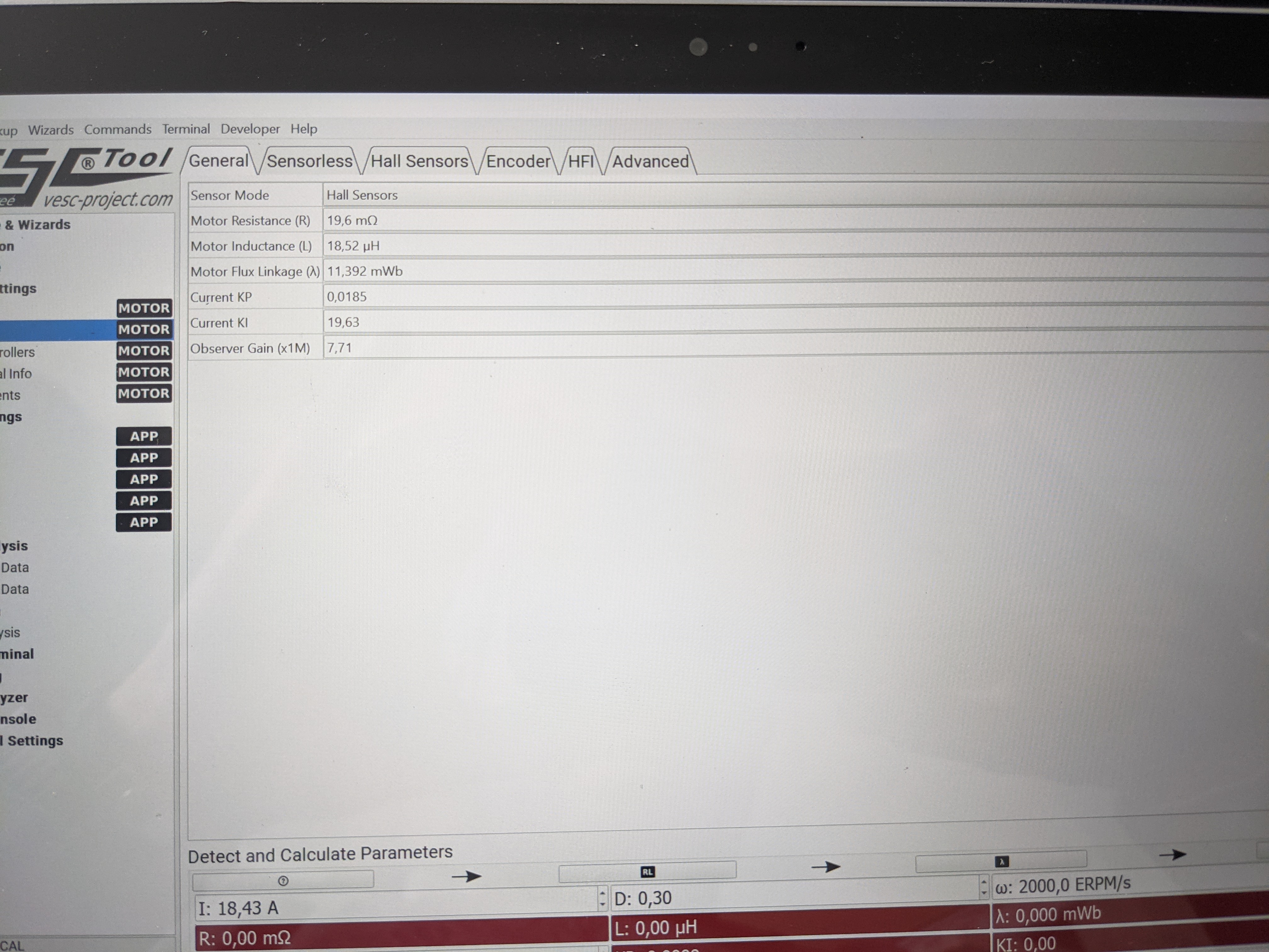

The thing that i don t understand Is why when i push the throttle the Amps outlet to battery Is Always 15-20 Amps…i would have all the 100 Amps in ramp up…
How could i do ? Now i post a video…

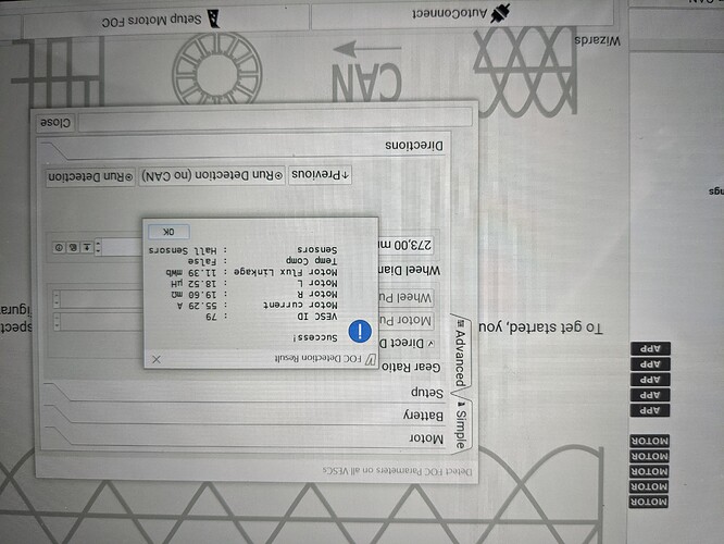

I think so, It Is simple, i use the autodetected motors parameters…
they arent great
they give really funny weird number
post your settings and we cna tell you what to change

Did you apply settings to ALL sides?
Can you film the same thing but in the next tab (one swipe down) to show combined values from both internal controllers?
Yes, but i want that the rear motor works well…this Is a e-bike … so It could rides with Only a motor
If this is an esk8, then “Duty Cycle Current Limit Start” needs to be dropped to 90%. But on an ebike, this is probably fine at 100%.
What motors are these? It’s hard to say without knowing what motors they are, but I feel like raising “Motor Current Max” to 88.5A will solve your problems.
You need to know the specs on your motor though, and I don’t. What make and model is the motor?
