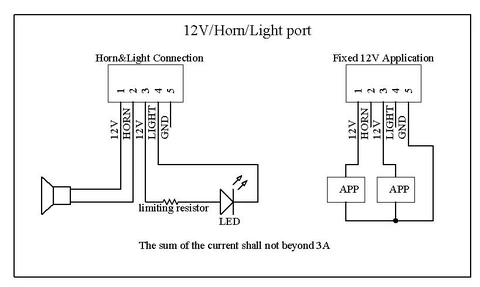

anyone know how to wire their horn? or a link to a wiring diagram?
thanks
It’s all in the FAQ
https://spintend.com/pages/faq
Thanks didn’t see
When they say doesn’t make a difference which is positive and which is neg does that mean either wire can go to lights and 12v
Horns don’t have polarity, so it’s going to make noise whichever way you plug it in. LEDs do though, so I think that one would matter.
