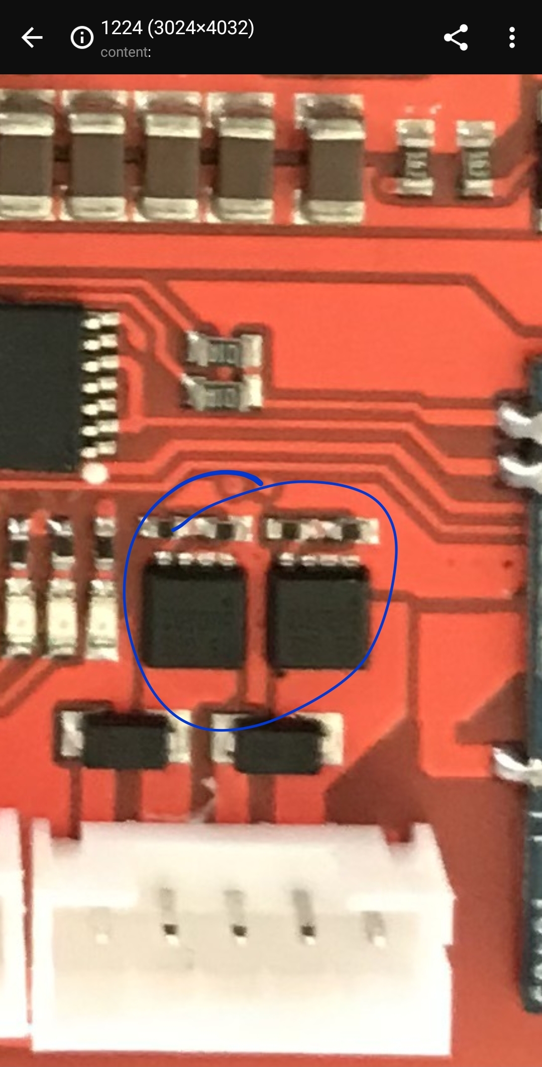

Noob question, but does this mean I can use all 3A on the light if the horn pins are not used?
I tried. And it blew the switch
Yes. Leave deadzone to vesc. Even at 0 percent. Still way … too much
The 12 volt output works perfectly,. But no longer from the remote. I certainly blew the switching mosfet
These do the switching?

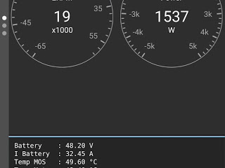

I’ve been quite pleased so far with the ubox, very good thermals, haven’t been able to hit throttling once yet in my normal rides.
Whats up with the duty cycle on those logs?
it’s the duty cycle limit bug
Vesc bug that causes skaters to fall: exists
