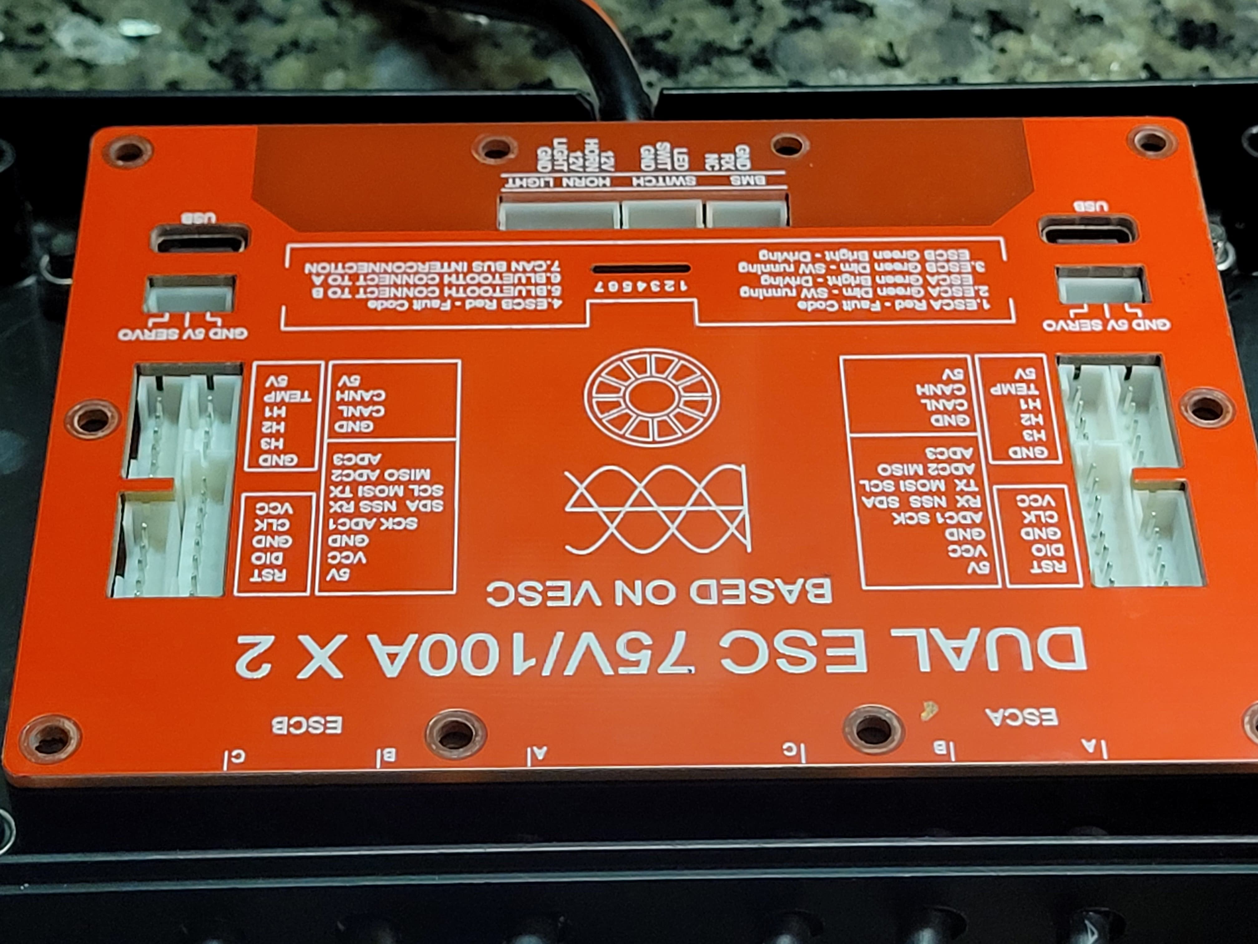

Not necessarily, i had this issue once and reflashed the fw to custom 5.3 and it fixed the problem. On another unit this mever revived it and the whole side was toast. Ya never know with these uboxes lol
Yeah nothing was working nothing I did change the fact that I couldn’t see it in the other screen or the ID box and I was even talking to the lady from spintend and she was walking me through everything I ended up replacing the can chips set on the back of the ESC and both sides were running so hopefully it stays tha way

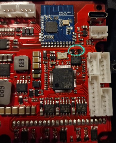

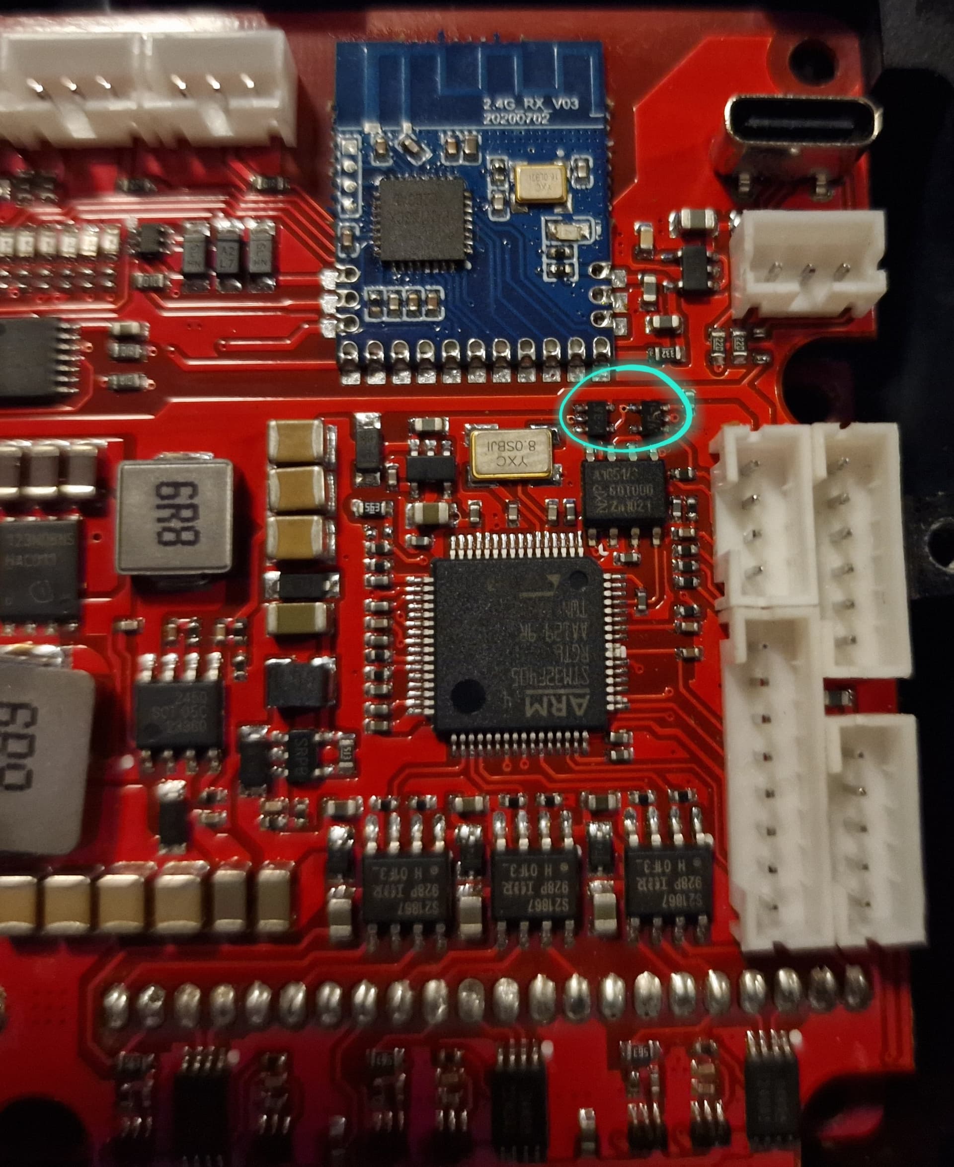

Does anyone know the part number for these parts? Theyre fucked because of some can bus fuckery.
Also, how does the internal can bus work on these? Also seems to be broken.
Chance that @jaykup might know

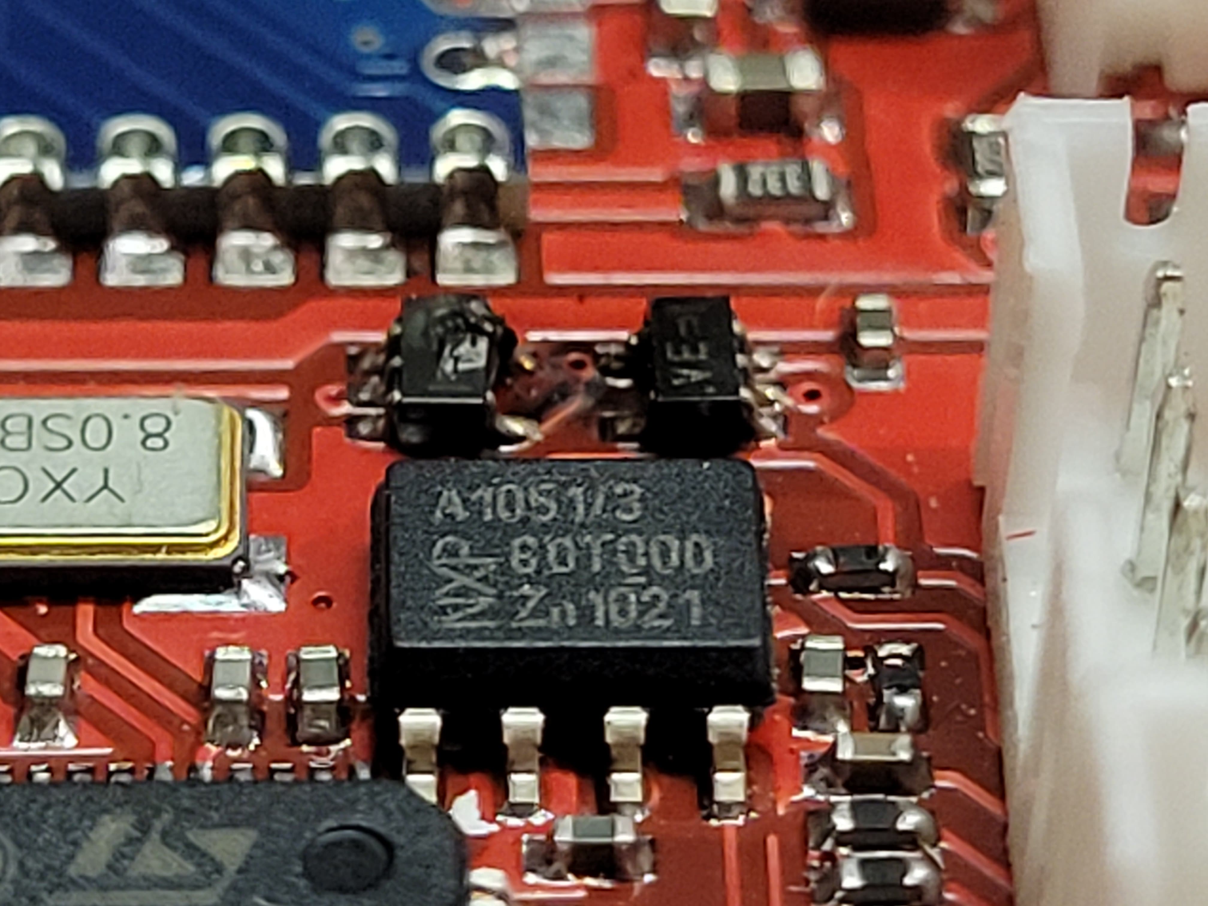

The canbus chip (TJA1051T/3/1J) is right below what you circled, but I can’t read the markings on those chips from the pic.
Usually if you google the marking followed by “smd” or “smd code” you will eventually find its full part number

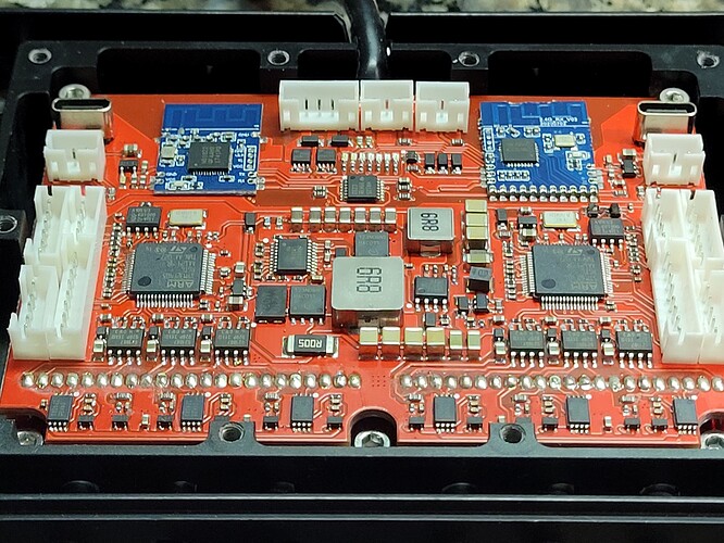

The Spintends have two canbus chips that should be internally linked… but I also have a Spintend with canbus issues that I haven’t had a chance to repair yet.
What issues are you having?
I have two units. On one of them the internal canbus is dead, but both sides work if you link them with an external cable. On the second unit both the internal and external sides are dead and the unit refuses to stay on unless the power button is held.

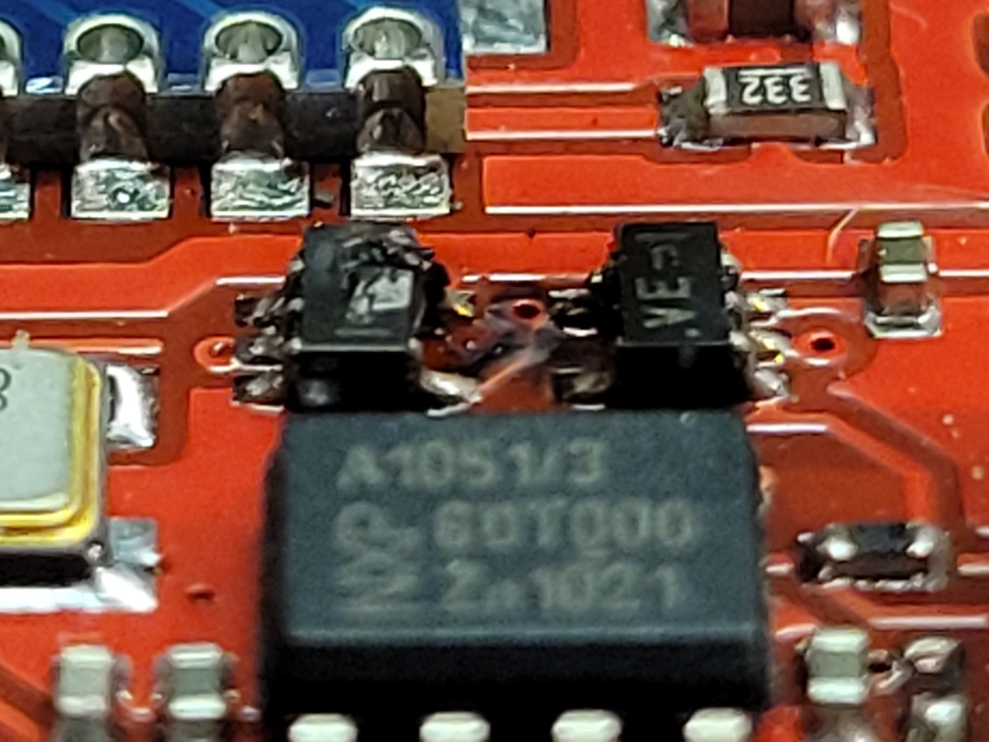

Yeah I figured this out and already have replacements on the way, but the right ic I circled has a little burn mark on it too the markings on them say VE followed by an underlined J turned 90 degrees.
https://smd.yooneed.one/ gives a ton of options but it looks like a SOT-23 or SOT-25 package

CAN connection stopped working on my UBOX V1? Type-C USB.
I opened it up to inspect and noticed this dark spot. Anyone know what these things may be?
Neither CAN with a wired connection and without work.
Using 5.2 FW provided by spintend for type-c ubox
