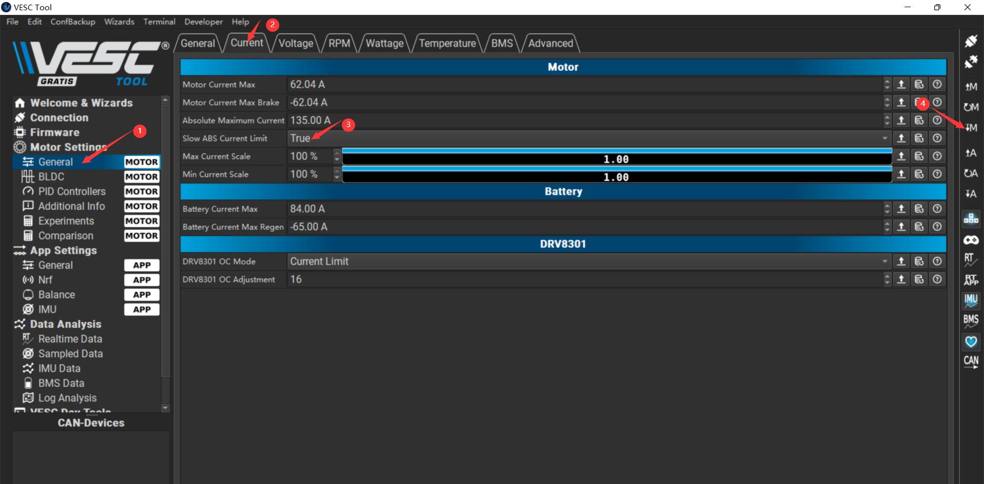

if you’re using 5.3firmware, do you turn on this?

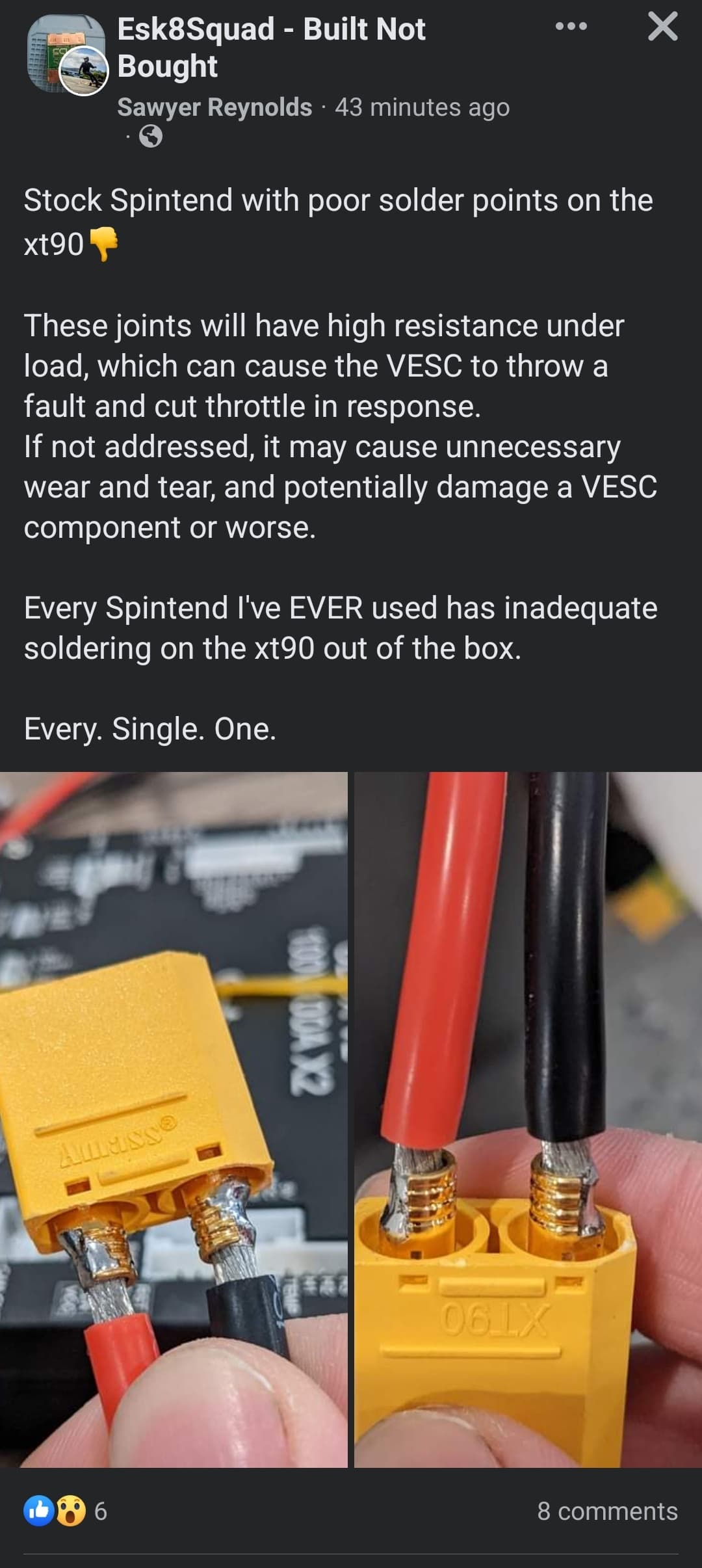

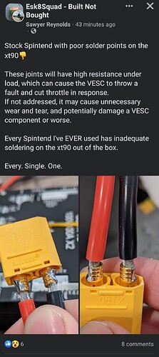

Has anyone here checked their ubox’s solder joints?

I got ABS overcurrent faults too frequently with 100A and the default firmware :fire_extinguisher:

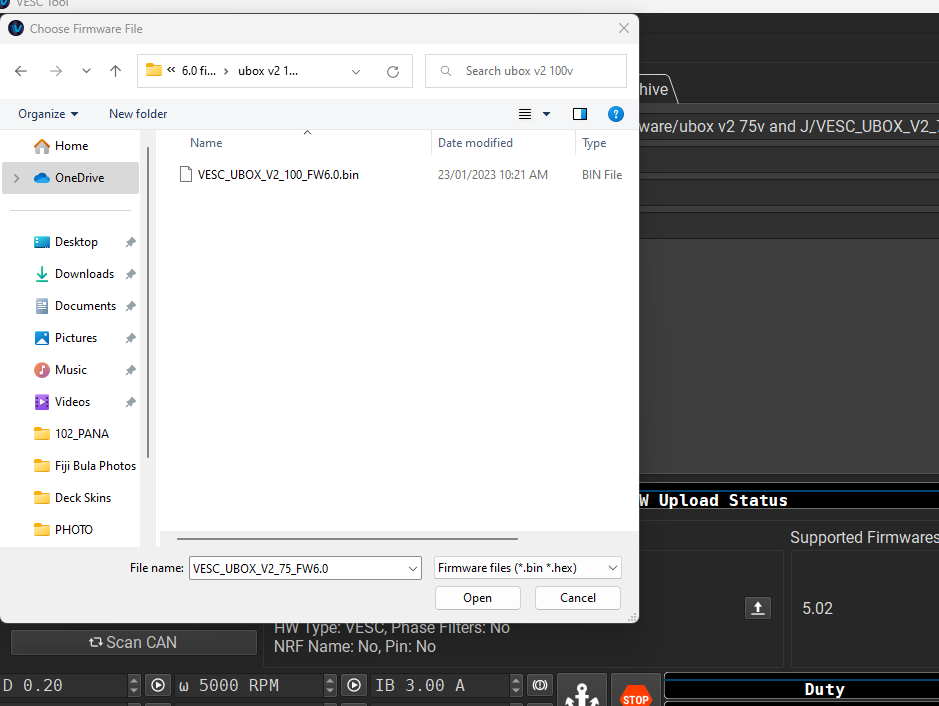

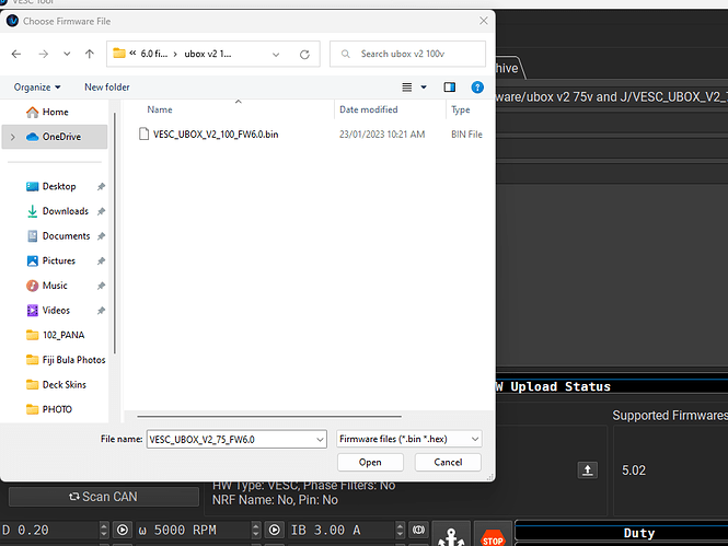

All good with this firmware version for V2_75V/100a Ubox?

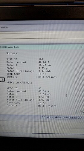

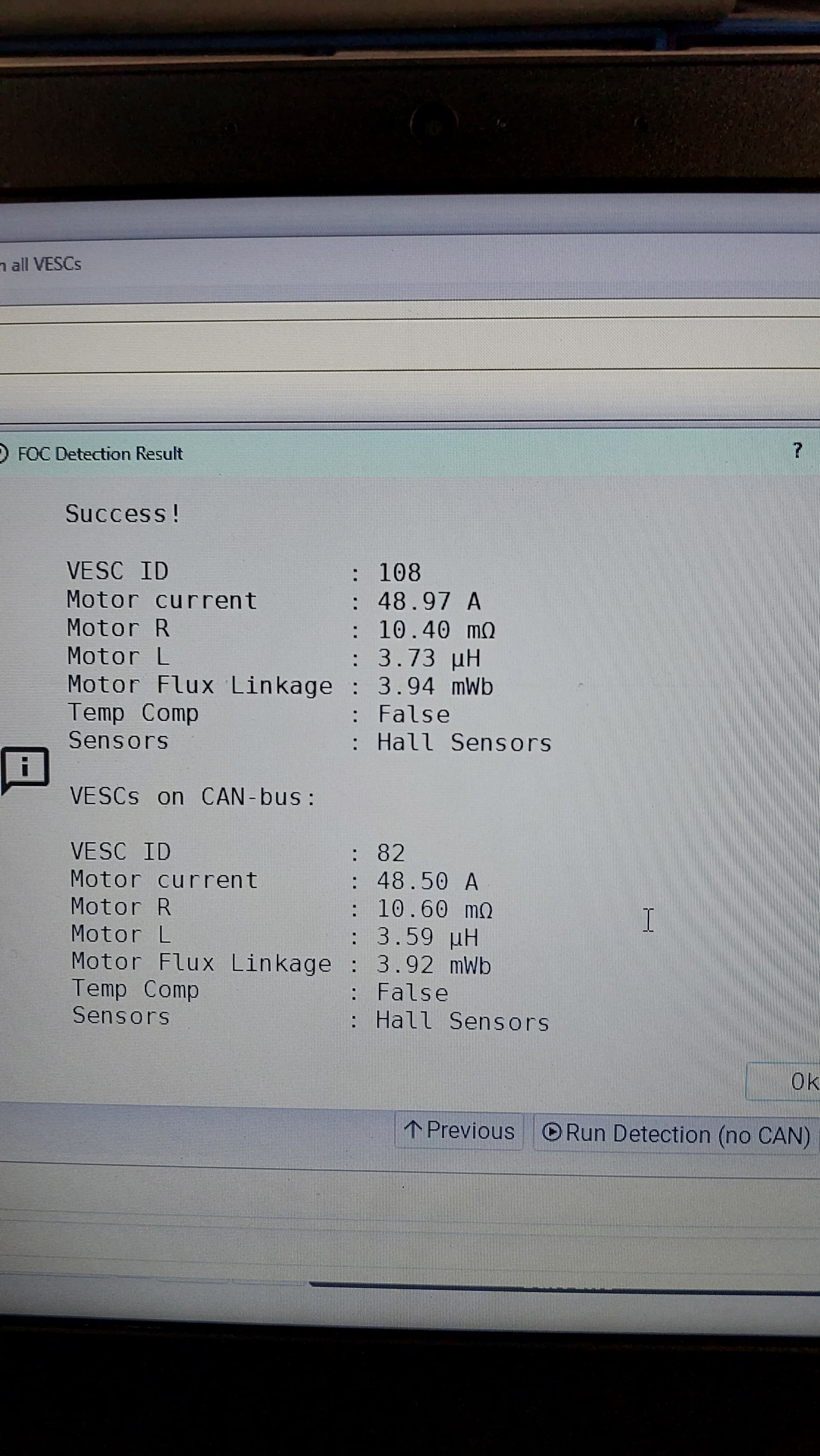

Having some stuttering issues after running detection on new motors so thinking I’ll just start from scratch and update everything, not keen on bricking it or setting fire to another one… Currently on FW5.02
I did shorten the sensor wires and solder but Im not sure if the issue is there given they are detected…
I figure I should start with the latest and greatest, assuming it’s stable, and work my way through it from there.
Advice welcomed to avoid flaming
[EDIT - Third time running detection with no FW change, was the sweet spot snd is all spinning nicely]
