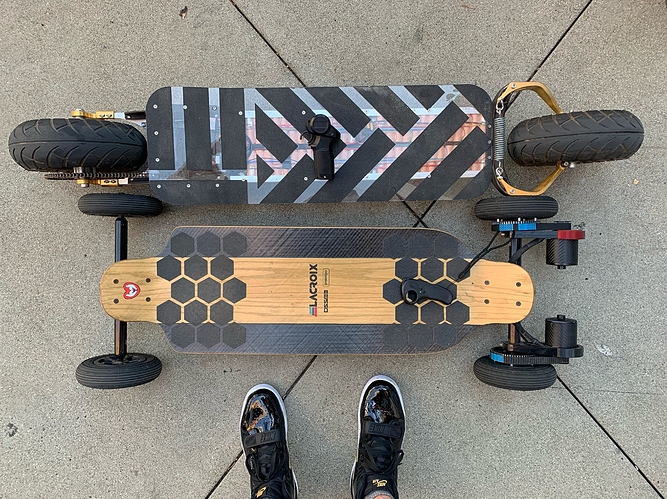

The ride height is already adjustable, but there’s a limit to how high the deck can be while maintaining stability. The enclosure on the deck can be very thin, basically just another single layer of cells to increase capacity by 50%.
That said, if enough people want a significantly higher battery capacity inside the deck, I can create that as an option. What would your ideal capacity be, and are you willing to actually buy a speedboard like that?
I would say that I’d be happy with 1000wh without feeling the need to upgrade it. Anything more would be a welcoming bonus. This would be the board I’d take on long offroad adventures with and anything less than that just doesn’t quite cut it. If it’s fitted with some 80xx motor at 12/13s and 100-150 amps, I don’t see the need to upgrade it at all and I would absolutely buy it complete. If you are actually planning to do something like that, lemme know and I’ll redirect the funds for my trampa build to you instead. :slightly_smiling_face:
I’m looking at 900 Wh now, definitely possible to go higher. I’ve got a 80100 130 kV motor coming from Flipsky, and a 200A Maytech VESC that I’ll be testing in the next prototype. I’d suggest holding off on that Trampa purchase. I’ve ridden up a mountain with the current prototype, 6380 motor, OG FOCBOX, 396 Wh, the upgraded one with the 80100 should be a beast. 260% more torque…
I’m pretty heavy on my stuff and I’m kind of heavy too :joy: My last mountain board with dual 6374s were overheating like a motherf. I’m talking 8 miles with 3000 feet of elevation gain, that poor little 6380 would not enjoy life. But now you’ve got me excited, I would love to get a hold of the upgraded version!
edit: I’m gonna hold you to it and hold off on my trampa build. I got rid of my last mountain board because it had a 10s6p and it was not getting me as far as I wanted to go. I was going to do a 12s8p build but I’m gonna see what you whip out first :ok_hand:
Yes! Good call. What cells were you using in the 10s6p pack, and what were you planning on using in the 12s8p pack?
HG2s in the 10s6 and was going to do 30Q for the 12s8 with the eboosted double stack enclosure on the holypro. Left room for a potential top mount too if I wanted it. That was the plan anyway :woman_shrugging:t4:

It’ll do a 180 on a two-lane bike lane, radius 8’. And go around a 90° corner on a 4’ wide sidewalk. This is tighter than the turning radius of most of the people I ride with with boards tuned for 30 mph. I’m able to follow OneWheels around all but the most ridiculously acute angle turns.
I do agree with you here, 100%. My objective is to have one base SKU with optional accessories that attach to it. The battery packs will be standardized, I’ll be able to add more for different levels.
I’ll do some math on that in the next day or two, see how it compares to what I have in mind.

New motors have arrived.
  • Flipsky 80100 130 kV, 148A, 17 Nm
  • Maytech 6396 170 kV, 80A, 5 Nm
  • TorqueBoards 6380 170 kV, 80A, 5 Nm (used on old prototypes, for comparison)
Taking the kV difference into account, the 80100 motor should have 260% more torque than the current prototype.
Oh boy! Now we’re talking! You gotta let me try this when it’s set up :joy:
I had a feeling you’d like that! Definitely Trampa-competitive. Will definitely let you take it for a spin when the next prototype is done.
It’s definitely possible, and quite easy. I’ve stayed away from hub motors because they’re so heavy. I don’t have exact numbers, but as a rule they seem to weigh twice as much with half the power. Plus, the front end needs a somewhat narrow axle spacing for the steering to work. I am going to look into having a hub motor made for the front just for supplementary power and braking. Even if it ends up being 1000 watts, it would be a huge advantage to have front wheel braking available.
