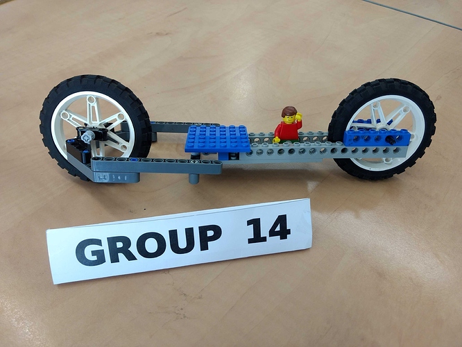

What is that, a speedboard for ants? It needs to be at least three times bigger than that.
