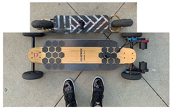

Holy, forgot how massive this thing is!
How big are your wheels?

The speedboard seems to shrink in peoples’ minds. I think that’s why I get a lot of “that is way overpriced” comments. When you see it in person, or at least in reference to a known board, there’s an “aha” moment, when you realize how much you get for your money.
The tires are 10.3" diameter x 3" wide, on 4" hubs. Massive contact patch of DOT-approved rubber. It really is a hybrid of a motorcycle and a skateboard.

Yeah, I think because people are used to the 6" wheel size and doesn’t realize its actually 10". It looked similar to this in my mind: (I just shrunk it to match the wheel sizes)
