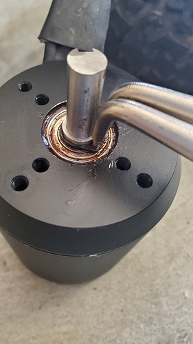

Did your motors come with very thin shims under the circle clip?
I noticed that on aps motors sometimes there is a bit of play. if you push the motor shaft in direction of the bell while the motor is mounted you can push the bell a bit back.
If there was play like this it probably always hammered on the circle clip till it gave up.
I would recommend to don’t use circle clips in future.
Just use shims, keyway and green loctite.
That’s how I mounted mine on my etoxx helicals.
This makes sense, I was just about to ask how to tighten a circlip more. I had to deform it a bit to get it on and off while battle hardening the motors and noticed it was a bit loose.
Perhaps I’m misunderstanding, how would the motor stay together without the circlip?
Just the green loctite on your motor gear, but depending on the direction the helical would force the bell anyway in the direction of the mount.
Is the motor bearing spinning well? If for some reason the bearing locked and there was a axial force applied on the circlip, the rotation between the shaft and the bearing could have opened the circlip and made it pop

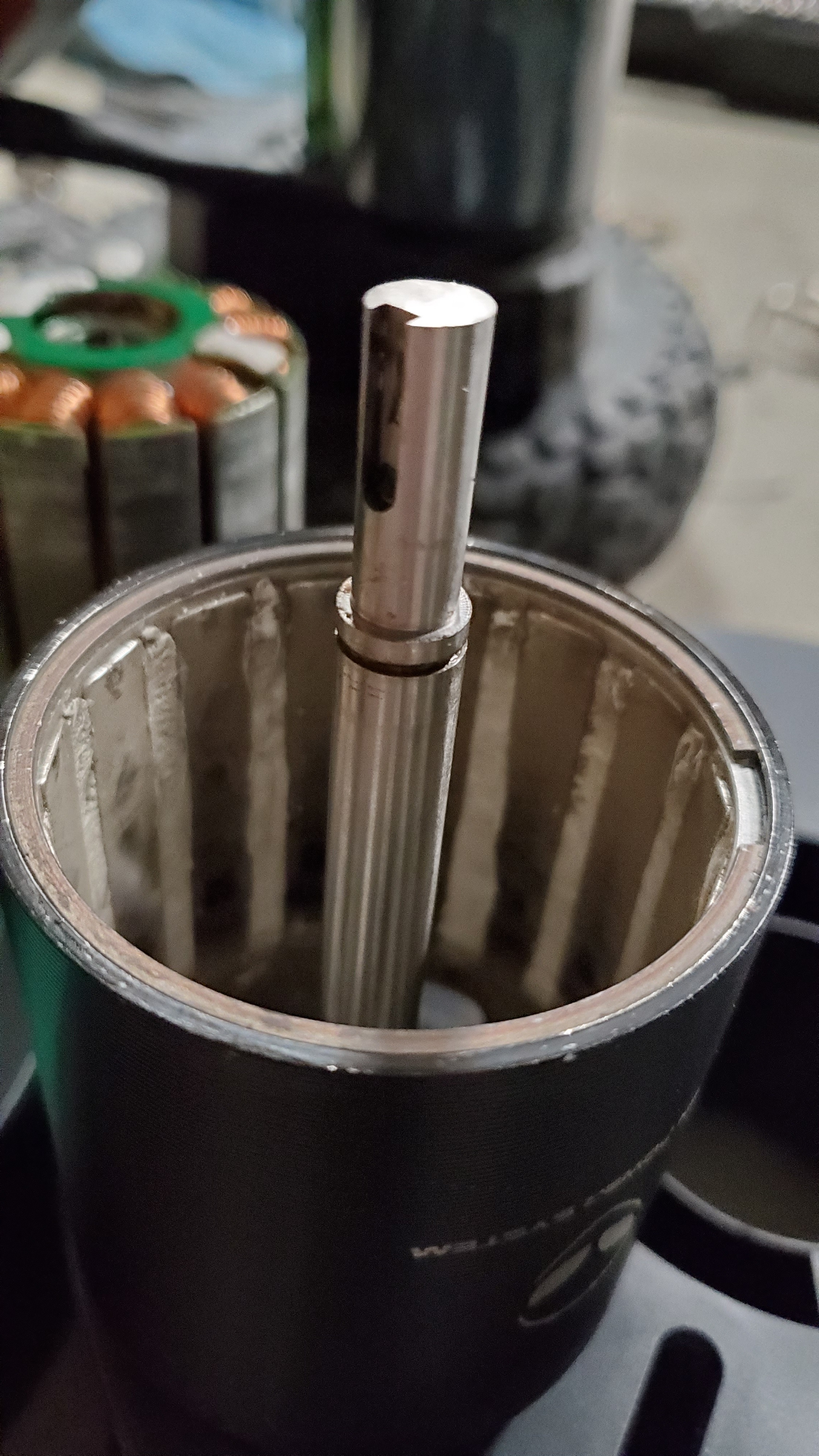

Coincidently, while epoxying the motors, I found one tiny motor shaft shim that fits the thicker section of shaft. The other motor was missing one. I flipped the room upside down and couldn’t find the other shim. I eventually got one from aps and asked a few people where that shim goes and got told it probably goes at the bottom of the bell like this.
Did your aps motors have 2 of these shims or just one? I may have put it on the wrong end of the stator bearing :thinking:
@rich I believe you had these aps 6384 motors too, do you recall?
I never had shims inside the bell.
Only between bearing and circle clip and often it was a different amount of shims as I guess there are some slight tolerances how the shaft is fixed in the back of the bell.
How does the shaft sit in the back of the bell by the way? Still flush or it moved a bit inside?
Moved a tiny bit as you suggested which makes me think I need that shim beneath the circlip instead.
I’m thinking another shim or 2 :thinking:
Definitely another. And a piece double mint to hold it in place
Hey venom the shims at the bottom of the bell are there to space the bell from the mounting plate, so they don’t rub. And you want the space between the circlip and the mounting plate bearing to be filled with shims

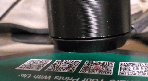

The motor gear has to be glued very well and not just a bit. Furthermore the gap between motor bearing and gear has to be 100% closed by adding washers. During gluing you hold (clamp) the gear against the can to be sure to keep it tight during curing. Personally I hold the motor and push the gear with both thumbs for the first 5 minutes to keep it 100% straight on the shaft. With a clamp it could get a bit askew if the force is not centered.

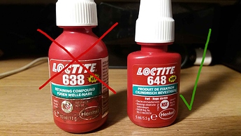

What do you mean with green Loctite, which one do you use?
From my experience 638 didn’t work well because it’s quite thick and normally the gap between shaft and gear is tiny. 648 is thinner and holds much better.
Personally I don’t use keys (and grub screws), just Loctite 648. Because during gluing it helps to rotate the gear when sliding on the shaft to distribute the Loctite. When removing the gear with a blow torch it also helps when you are able to rotate the gear on the shaft.

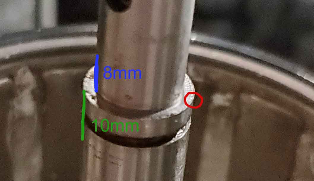

Just to be overly clear, you mean on top of or below the circlip in this photo?
I think I understand this but don’t want to mess anything up. Can you summon your paint skills and diagram what you mean in this photo?
The clamping makes total sense to me :ok_hand:
I’m talking about the edge from 10mm to 8mm. The last 10mm washer should sit a tad higher than the edge to have no gap between 10mm and 8mm washer. Amazed about my painting skills? :rofl:
That is the exact picture I had in my mind and needed to see. Thank you so much.
