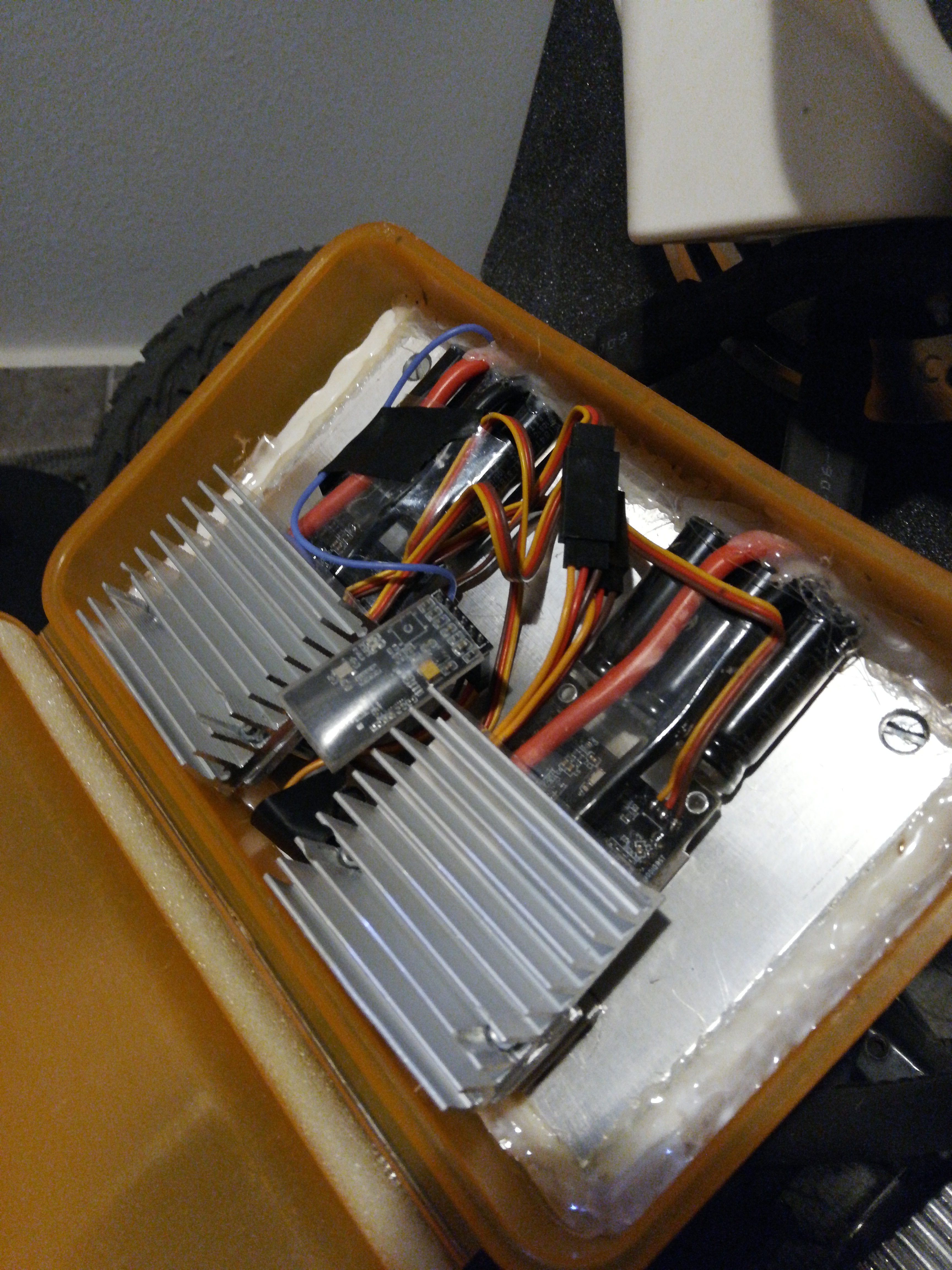

Also, could you post a picture of your setup inside enclosure, please?
Where was the magic smoke?
In this enclosure. Can’t say exactly where
You’ll eventually have to remove the esc and heatsinks from in there to diagnose. I’d suggest while you don’t have the tools yet to diagnose, start slowly disassembling it taking good pictures of the hardware without the heatsinks. From there, we can tell what component caused the smoke and whether it’s worth working on a safe fix/replacement
OK, thank you both. Will do that the following days
You was right. No clicking with the vesc’s disconectet
Third Mosfet looks damaged. This is no VESC BTW. It is a Maytech super ESC.
Take more pictures of both ESCs(Good enough, @Trampa ?) on both sides. Current target is to spot what is shorted/fried.
Couldn’t it be that heatsink somehow moved and shorted the right Mosfet’s legs?
