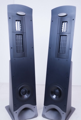

This is the more audiophile idea, reduce these to essentially a box with a tweeter on it:

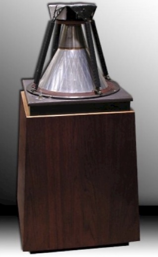

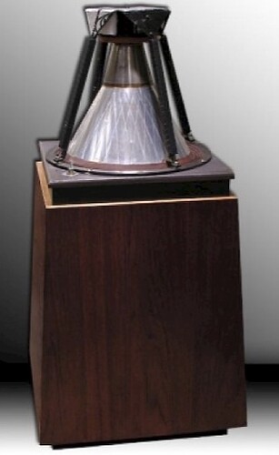

Actually if you do an ohm type the dispersion is better for everyone to enjoy so any 360 drivers?

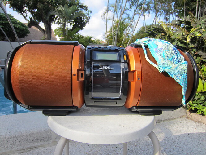

Now just a thought, have you tried recycling a modern Boombox? Not a pocket unit like UE, JBL or similar but a real Boombox.
Sharp, JVC and Pioneer and there’s also another brand which I forget… These guys still know their hand if you can grab one. I have an old Sharp Boombox in my parents garage, that thing was impressive blast on a wall charger but anemic on small batteries, never tried to make a new battery for it tho!
Something like this

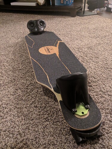

as documented by the dude who ghosted, @deckoz

Not 8’s… a pair of 6.5’s. I tried a 2x50W + 100W 2.1 TPA3116 amp board powered by a 6S4P battery in the boombox, neither the amp nor single 6.5in woofer were “enough” to enjoy while wearing a helmet. Those power numbers are very misleading. The boombox amp puts out maybe 25W of clean power into each of the tiny 3in full-range speakers which is more than enough. However, these little 2lb 6.5in subwoofers are not very efficient… the 50W of clean power from that amp is simply nowhere near enough, nor could one of 'em do any better with more clean power. I just want to use a pair.
I do NOT expect to need more than 100W of total power to drive the system when finished… I picked that amp board because it could be driven directly from the main 12S battery pack, eliminating the need for a (second or different) DC-DC converter. The stock buck converter in the Nazare handles a measly 2A = 24W.
Any store-bought boombox or bluetooth speaker smaller than a loaf of bread that makes decent bass does so with the aid of a very complex cabinet tuned to reinforce lower bass frequencies. I don’t h
Looks like a legit 2.1 setup (w/o actually reading the build log) but I face more sideways as I skate, want one small “top box” at each end & a pair of larger woofers in the middle of the deck facing upward. If I wanted to listen to NPR, this would work great. Not going to cut it for doom/sludge.

Never had the pleasure of hearing a pair of Ohm Walsh’s, don’t see 6-figure German Physiks speakers on the horizon for me any time soon :slight_smile: That said, you don’t need to spend $10k+ for true omni sound. I am a huge fan of Gallo stuff with their cylindrical omni tweeters. My little CS-2s have the budget version that only radiate 180deg, but it sounds the same in any seat on the sofa… no sweet spot. Upstairs I rock the Reference 3’s w/ the 300deg tweeters, 5in mid spheres, integral woofers… same thing. So long as you’re on vertical axis, anywhere in the room sounds great… The stereo image shifts as you move.
On the board, dispersion is low on the list, but those large planar tweeters sound phenomenal, just came down from $200ea to $40ea! GRS is the company/brand knocking off the B&G, they’re getting rave reivews on PartsExpress.com.

I really only used the walshes as an example for a 360 firing design for public speakers. They aren’t anything special aside from the special coating and tuning to the box(so yes special,lol) but you could diy some with a down firing full range maybe. Just an idea that could sound cool.
