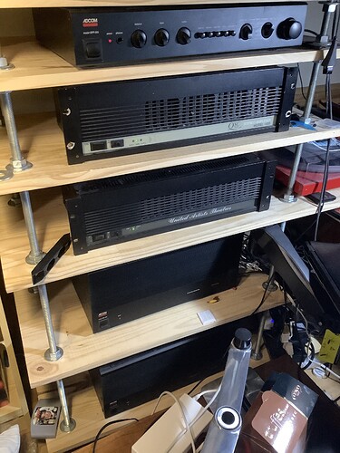

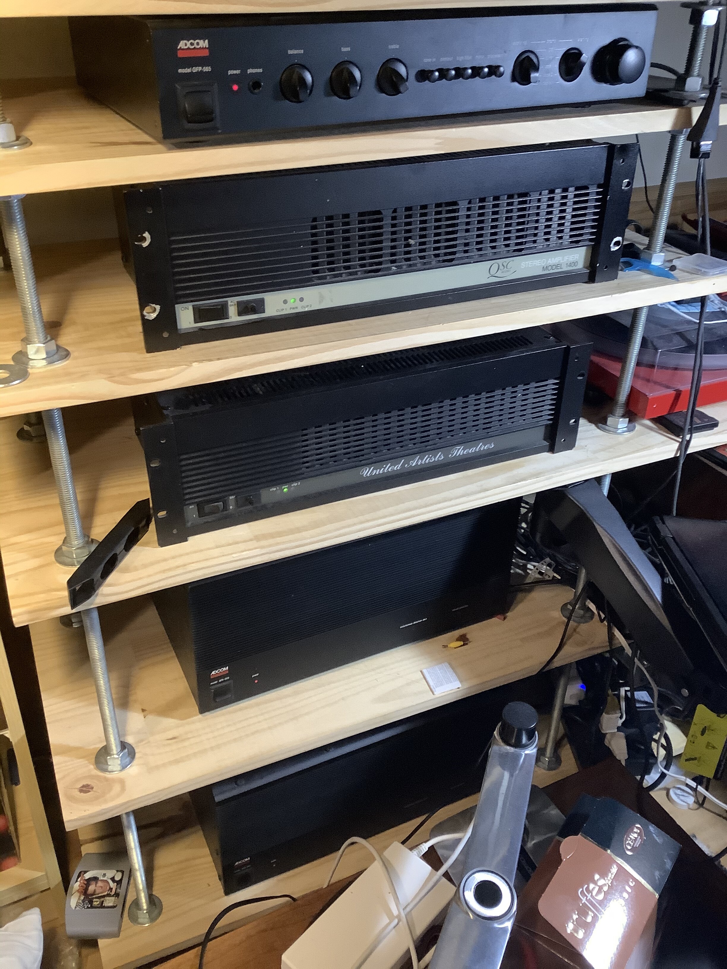

The qscs aren’t lookers that’s for sure, but I’m running them bridged mono on my electrostats and they dip to 2ohm I think but they work great despite arcing. Loud music for a while causes the fans to spin up a lot. :rofl:

You’re fishing for a “nice rack” comment… I’ll oblige: Nice rack (of amps.)

Yep I been wanting to put this crap in a closet. And yes thanks for the compliment, always fishing. :sweat_smile: I really only bother if someone might care. I bought these based on counting transistors inside and they amounted to roughly the same amount as the adcom 565s and they were $200 or something for the pair.
