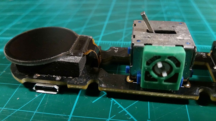

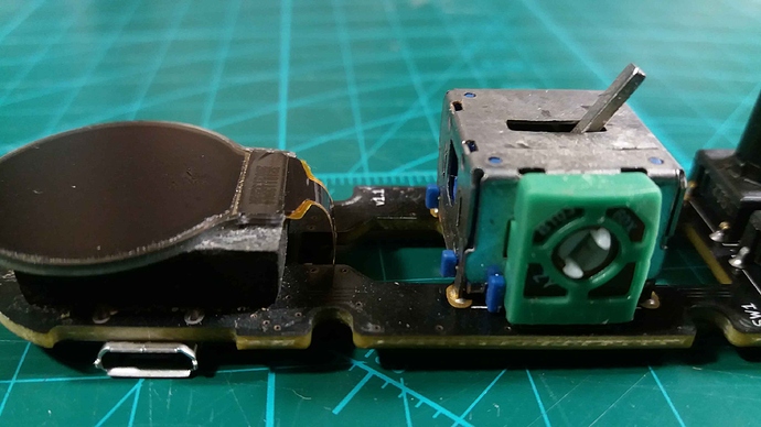

You can change the pot for cheap.
Not very easy though.
You cut it down and de-solder each pin separately. Quite easy if you have a small cutting pliers. Soldering on a new one is very simple. Send us the PCB and we will sort you out.
Thanks for the info, didn’t know that but exactly this is one of my personal problems. When I bought the Wand I was 1000% sure that there is a future shit poti with some support inside and not a cheap generic poti sold for 3 bucks where the trigger scratches on the aluminium enclosure. I thought it’s made for MTB so it should survive at least 1000 crashes with ease. I crash quite often so I need a tough reliable remote. If you don’t crash on your MTB you don’t ride hard enough :wink:.
Thanks Frank I appreciate the help but I couldn’t trust the same PCB with a new poti, also I kind of destroyed the display connector. For the shipping costs back and forth I can buy another VX1.

The good thing is that changing the pot is cheap and then the remote is like new.

We have triggers in stock: https://trampaboards.com/wand--potentiometer--p-27558.html
Had one of those on hand already.
Was absolute aids to desolder the old one with the fat ass layer of conformal coating I had on it :nauseated_face:
Desoldering is easy. You need to cut all pins with pliers and then desolder each pin separately.

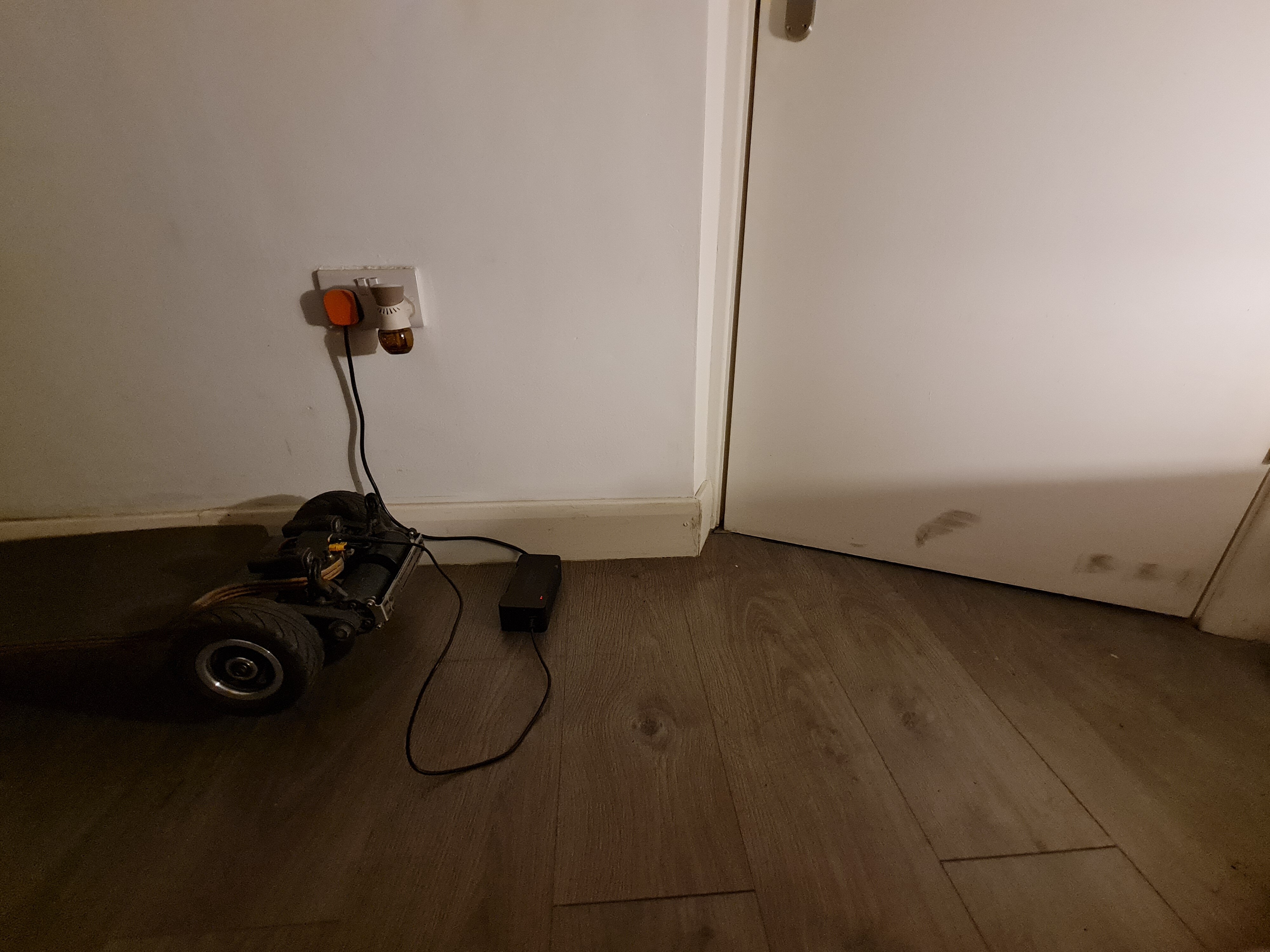

So, board on charge, wheels down, remote on table, just came from work and completely forgot it’s throttle locked, not off.
About half an hour later i almost fell asleep, when the board starts dragging itself backwards, with the charger, nightstand, and scraping the wall/door :expressionless:
I checked faults, threads, nada. I put the wheels up and turn on the remote, first thing full throttle for half a second. What the actual fuck?
