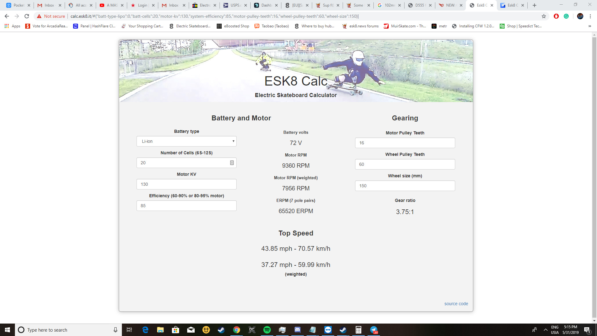

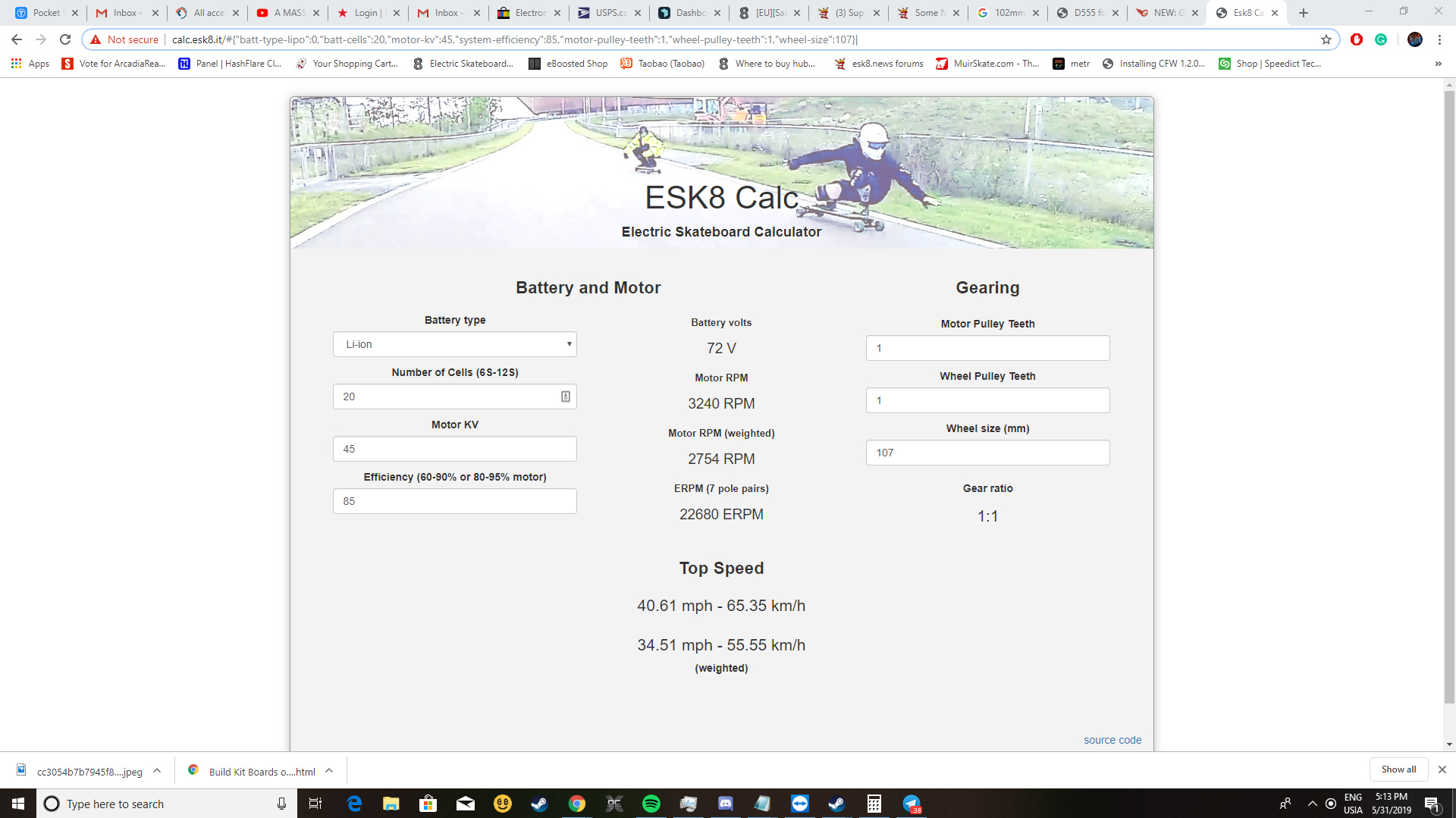

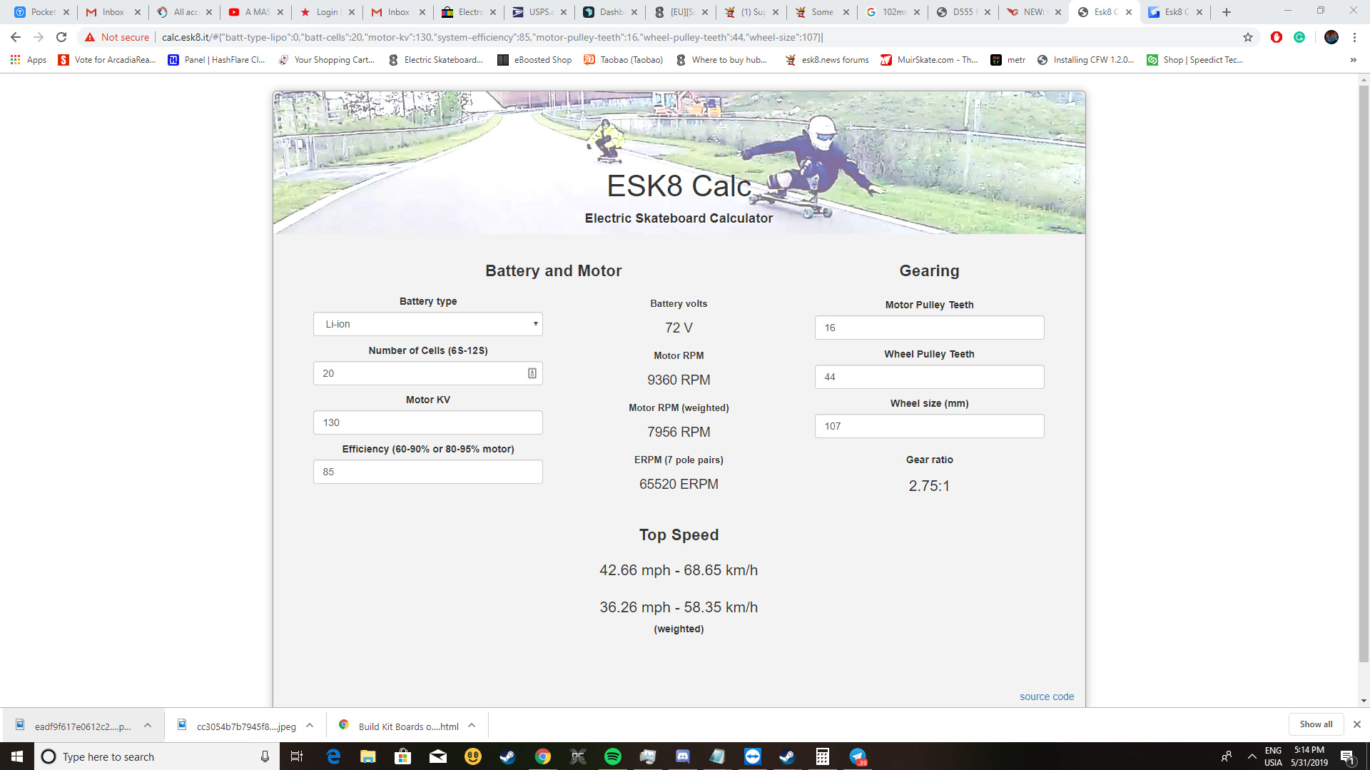

20s is like 100km/h :joy: not saying it’s not possible… but :joy: how ever. NY city kids need that :stuck_out_tongue_winking_eye:
special edition 45kv dd?
130kv belt drive? with ground shredding torque?
or some 130kv belt drives + @Psychotiller six shooter?
Ideally a high voltage system gets paired with low kv motors…or a hell of a reduction gear ratio.
Here I see the issue. My point is always first on mtbs and 1:6 is already pretty close to no real clearance. As min not with 8“ wheels. If I step up to 9“ the speed rise up again as well.

i mean almost any brushless dc motor can run at 20s (as long as winding’s dont short out due to voltage jumping.)
problem is the magnets/ the shaft.
i cant imagine how much torque would go through the shaft, 130kv + 20s (if you can even handle the torque lol)
and the ungodly RPM you get with it. eRPM at that point may exceed what the ESC is capable of.
With some as5047 Encoder or custom sensored it would be an option
@Chibatterysystems
130kv + 20s nominal is only 65k

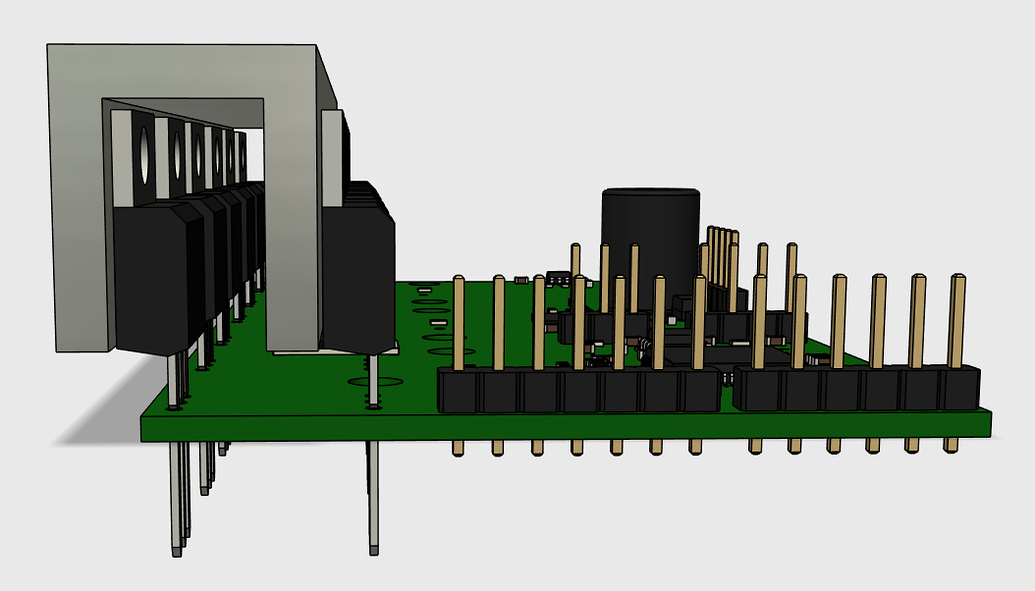

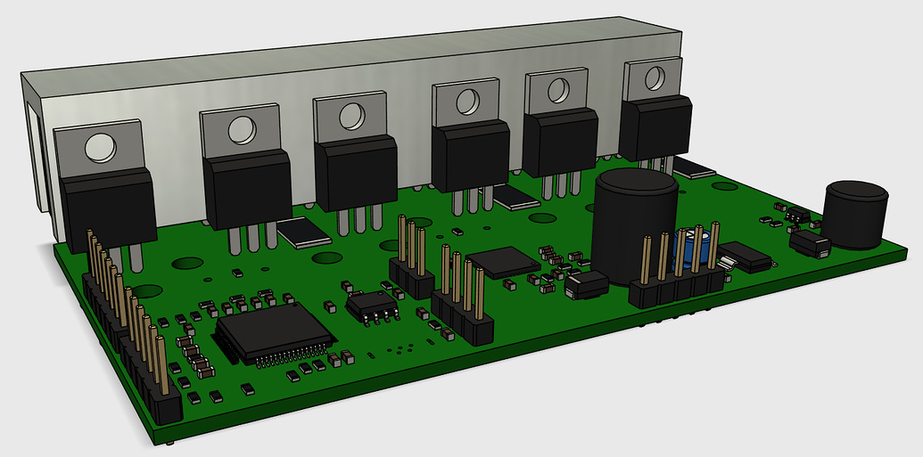

Totally agree! How you see mounting a heat sink with the two rows of fets? The outer row shouldn’t be an issue but the inner?
They make this sort of aluminum channel that would work. You can then couple the channel to other chunks of aluminum
You need slim fingers to add the nut on the inner fets thou :sweat_smile:
Yeah. I was thinking long tweezers and a magnetic tip screw driver inserted through the mounting holes of the front row. You would mount the back row first then the front.
