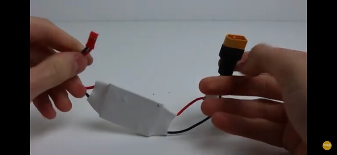

Step down converter question. Just realized the input wires look to be 20 Awg, if it’s being stepped down from my 48V battery to 5V for the LED lights, shouldn’t the input wires be 12 Awg or something beefier? I guess I don’t understand the use of a converter if the wires themselves can only handle so much voltage? Or maybe I’m confusing wire voltage limitation with current limitation?
All of those wires should be rated against arcing up to hundreds of volts. The low voltage side of the converter will see more amps, and may benefit from heavier gauges. What’s the power output of it?
I’m not sure of the power output. It’s just some LED lights for the perimeter of the board… Review below… I think I’m just confusing myself with all of the wiring!
