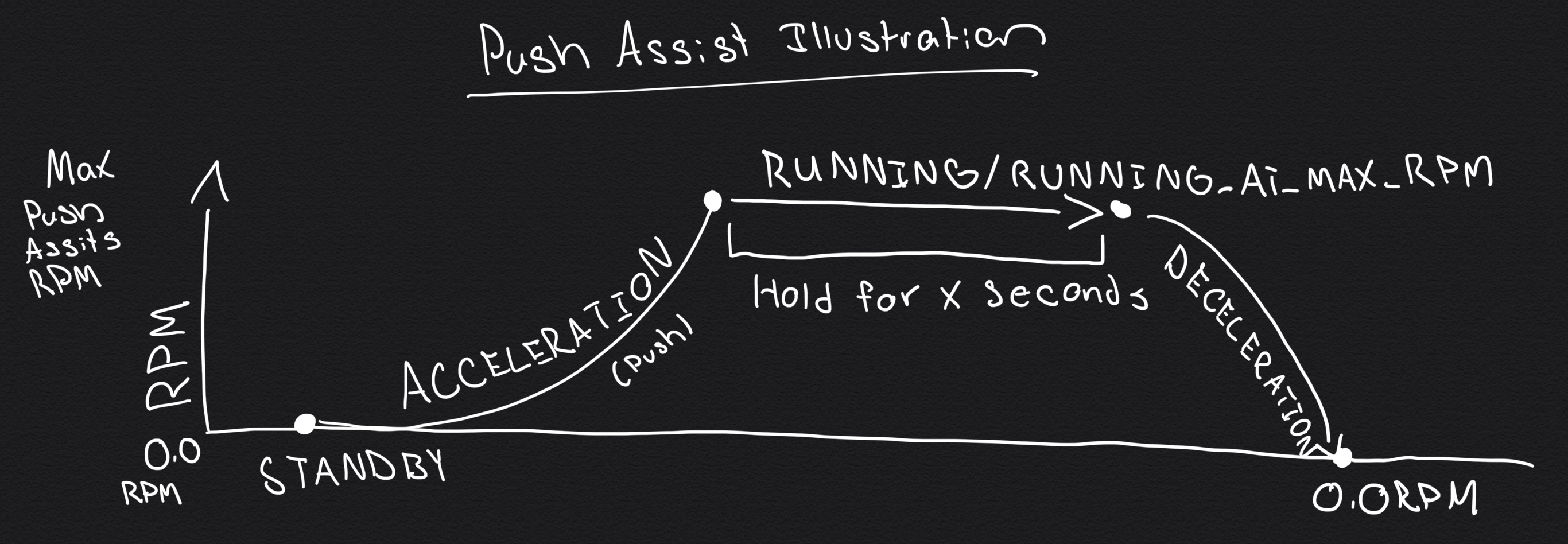

I was able to make a “proto” logic for how it might be implemented as a State Machine:
STATES:
  • STANDBY
  • RUNNING
  • RUNNING_AT_MAX_ERPM
  • DECELERATION
  • ACCELERATION
  • BRAKE
The board would start in STANDBY Mode awaiting for an acceleration (push) that goes over a set Minimum Standby ERPM.
In STANDBY:
If the board somehow reaches a certain speed, the Maximum Push Assist ERPM, then the board enters the RUNNING_AT_MAX_ERPM state.
For any speed under (but above the Minimum Standby ERPM) it enters the RUNNING state.
Before entering either state, the timer starts ( with a longer timer for RUNNING_AT_MAX_ERPM).
IN RUNNING | RUNNING_AT_MAX_ERPM:
In the RUNNING | RUNNING_AT_MAX_ERPM states, the timer is constantly check to see if the set time has expired.
if the timer expires than the board will switch to will switch to the DECELERATION state
In the event that an acceleration (push) occurs during this state, then the board will enter the ACCELERATION state.
IN ACCELERATION:
While in the ACCELERATION state, the board will reconfirm that and acceleration was made, and check to see if the RPM resulted from the acceleration was greater or equal to the Maximum Push Assist ERPM. If so then the board will start the timer and enter the RUNNING_AT_MAX_ERPM state.
For any RPM resulted under the Maximum Push Assist ERPM, then it will start a shorter time and enter the RUNNING state.
IN DECELERATION:
While in the DECELERATION state, the board will first check if the current RPM is at 0 (board has stopped) if so then no deceleration will occur and the board will enter the STANDBY state.
If the board ERPM if greater than 0, then the board will decelerate by a set Push Assist Decelerate ERPM value ( but before doing so it will check if it will decelerate past 0.0 RPM and if it does it well just set the speed to 0.0 RPM).
If it detects an acceleration during this state, then the board will enter the ACCELERATION state.
IN BRAKING:
If braking is detected (servo_val < 0.0), the the board will enter the BRAKE state and brake until the rpm is 0.0
I would implement this in app_ppm.c since that’s the most popular app_config (and the remote that I’m using).
Thoughts? If you find any logical errors or situations that can go wrong with this please point them out as it would be very much appreciated. I’m limited by this being my first time doing robotics related work, messing with the VESC codebase, and having no board near me to test this on.
TLDR Visuals:
EDIT: Changed DECELERATION state to only activate when the timer expires in RUNNING | RUNNING_AT_MAX_ERPM
how does it differenciate a push from going downhill?
Is there a remote/foot sensor invoved in this?
It doesn’t. :sweat_smile: I’m taking the closest implementation to Mellow’s (using how Vedder does Cruise Control ) so it will require a remote for downhill situations. As far as I looked, Mellow’s Endless Ride requires user to brake downhill or risk overshooting I think. Same case here kind of. Since it’s based on the Nunchuck’s implementation of Cruise Control , the same thing that happens to boards using Cruise Control downhill will happen here.
For a full accurate picture I would like it if someone with a VESC WAND could test CC going uphill and downhill so I know what behavior to expect
If you are cruising and hit a small uphill, will it start to decelerate you?
Great work all around and beautiful explanation
To be determined right now (need to work out how I sample for acceleration in the first place) ideally it should do the same thing that Vedder’s Cruise Control does when it hits a hill but that all depends on how I approach this. Will come back to you once I work this out.

Solid progress! Nice work
Is this to check for like someone foot braking? If so I’d leave this out. Looks like it’ll cause more issues than it’s worth.
