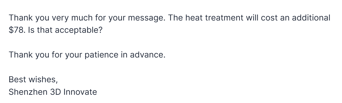

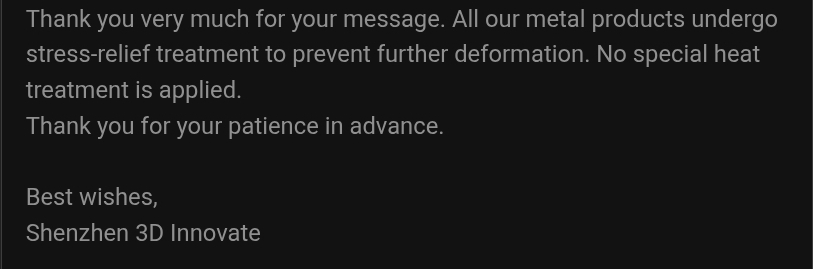

This was the reply when I asked them if the parts were heat treated.
This is the quote I got for additional hardening.
@Dinnye , the description is a bit confusing. This is the first time I’ve asked for additional hardening in Craftcloud. Even without additional hardening, they are a nightmare to drill and tap. My friend ordered a hardened set from in3dtec (you can select it as an option on that site). We are unable to tap them and our local machine shop said they would probably have to soften the metal to tap and then re-harden. Just based on experience so far, the extra hardening doesn’t seem necessary for my mod 1.1 herringbone gears. Will give it a shot if gears start breaking though.

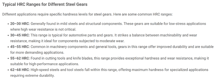

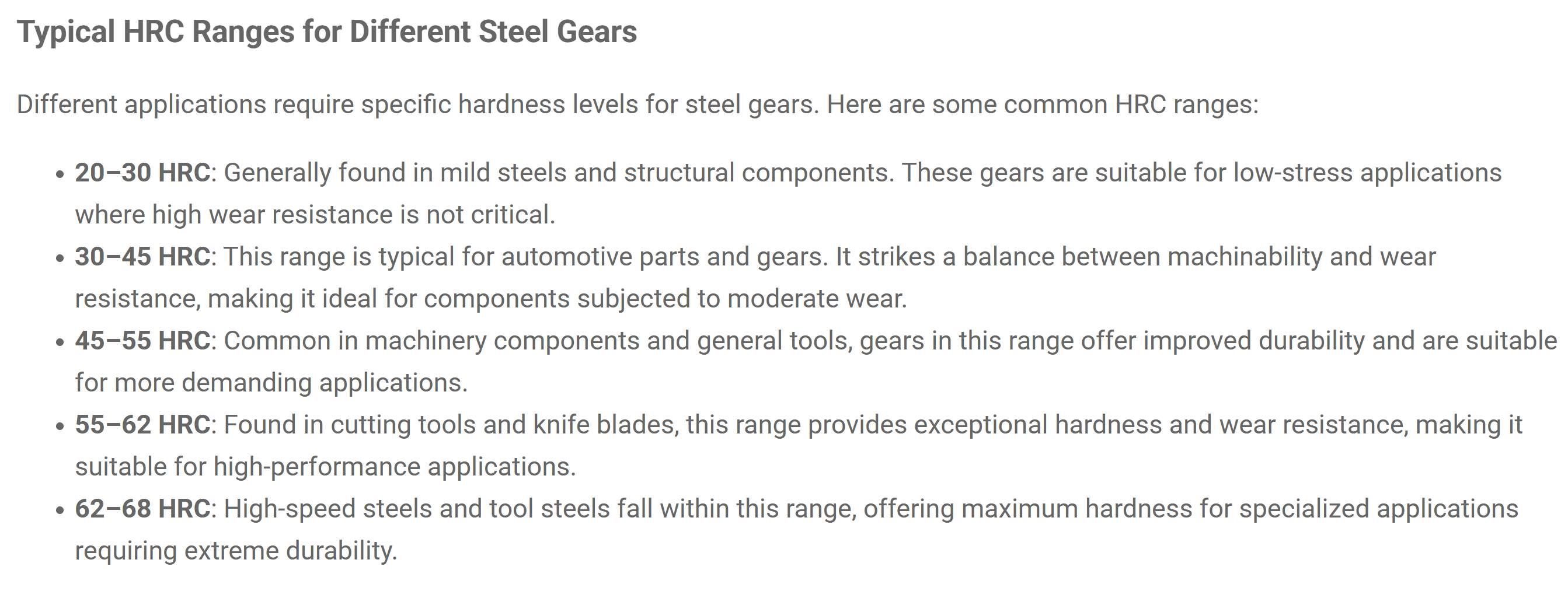

Edit to add - https://www.gears-manufacturer.com/blogs/is-higher-hrc-good-for-steel-gear.html
According to this site, the 35ish HRC we get without the additional aging process is used for gears and automotive applications.
Oh, good that we got that clarified.
I think I’ll do non-hardened for my prototypes and then abuse the hell out of them to see if we actually need the full-on hardening. Or maybe harden just the pinions. M300 still has amazing properties even without aging. I’m not worried at all about breaking the ones I’ll design, only slightly worried about wear. 35HRC should be enough though.

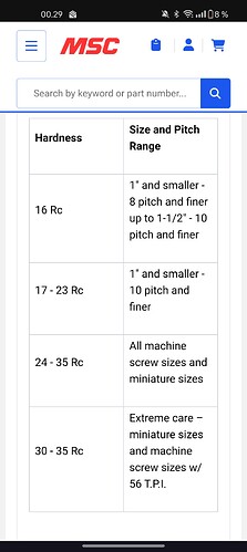

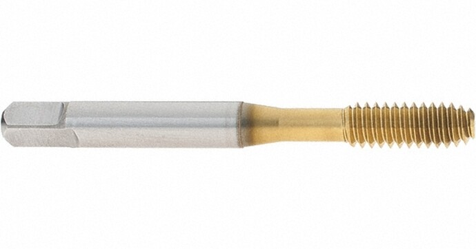

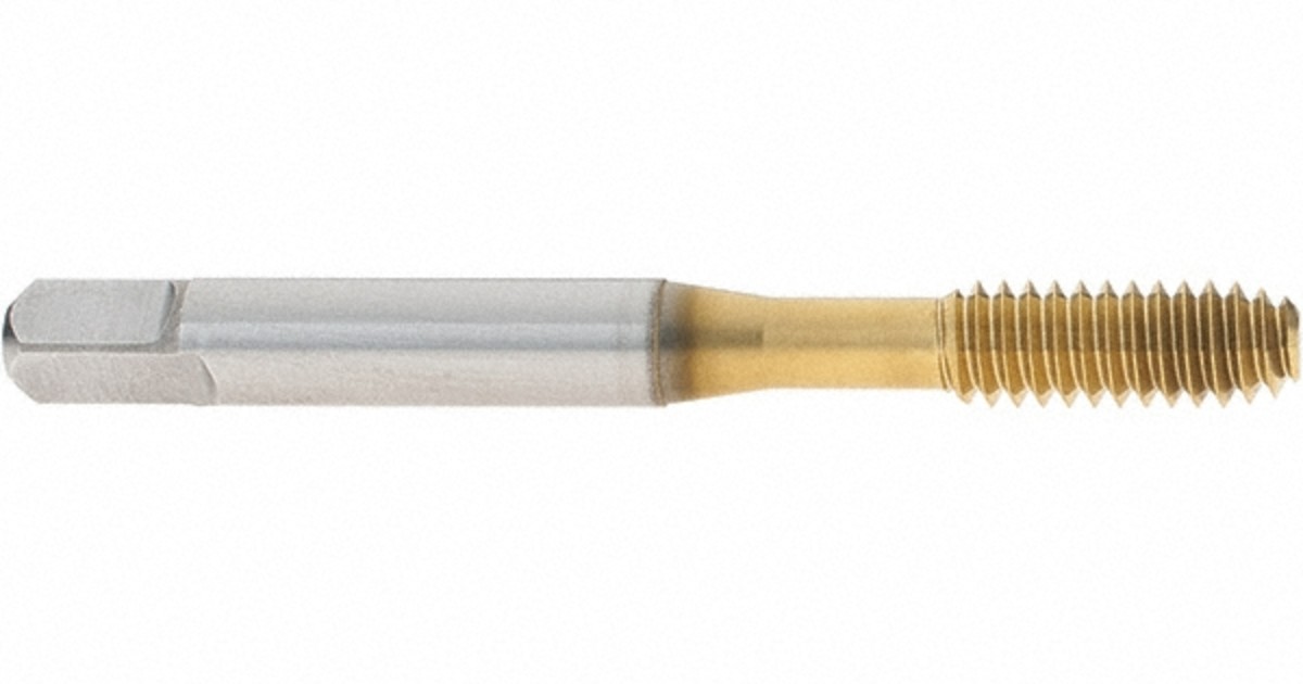

I wonder if a thread-forming tap would have more success than a thread-cutting tap, particularly in un-hardened m300.

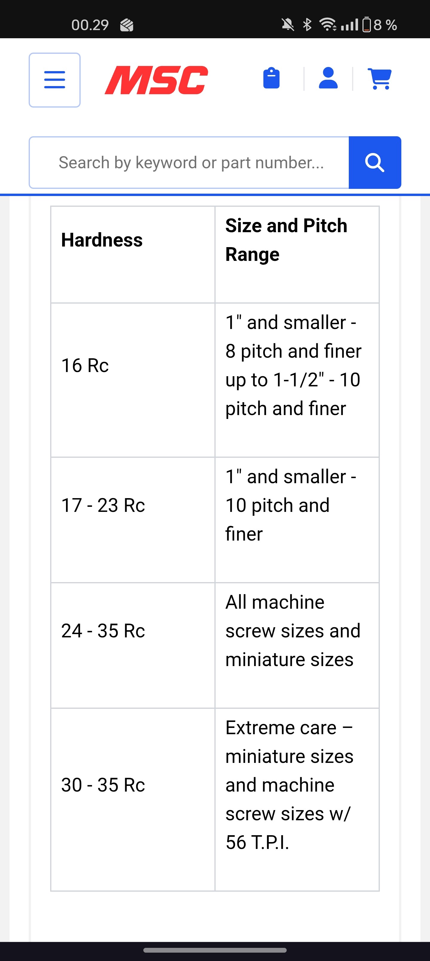

Doesn’t look like a great idea, un-hardened is still 35 HRC. M4 is ~36 TPI, it says max is ~56 TPI which is significantly smaller thread size, and even that requires extreme care
HSS-Co or HSS-E spiral point cutting taps should be just fine with TiAlN or ideally TiCN coating and some thick EP (extreme pressure) tapping fluid.

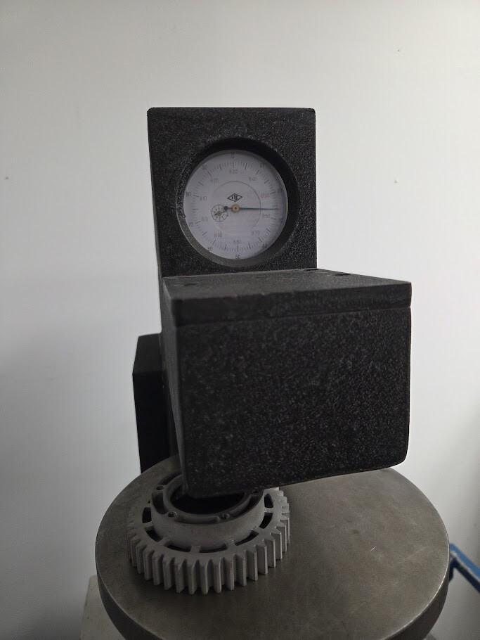

Rockwell testing of the maraging steel from Shenzen 3d came back at 26 HRC which is less than ideal. 30-35 HRC would be more appropriate for annealed and not hardened.
Hardening recommendation is 485°C for 4 hours and air cooling to room temp so I will be looking into accessing an oven this temp. Hopefully any potential shrinkage will not cause issues with the tapped threads.
Holy shit dude. I have it in writing from them that their parts are 30-35HRC. Happy to share the screenshot. You should reach out and give them your results.
