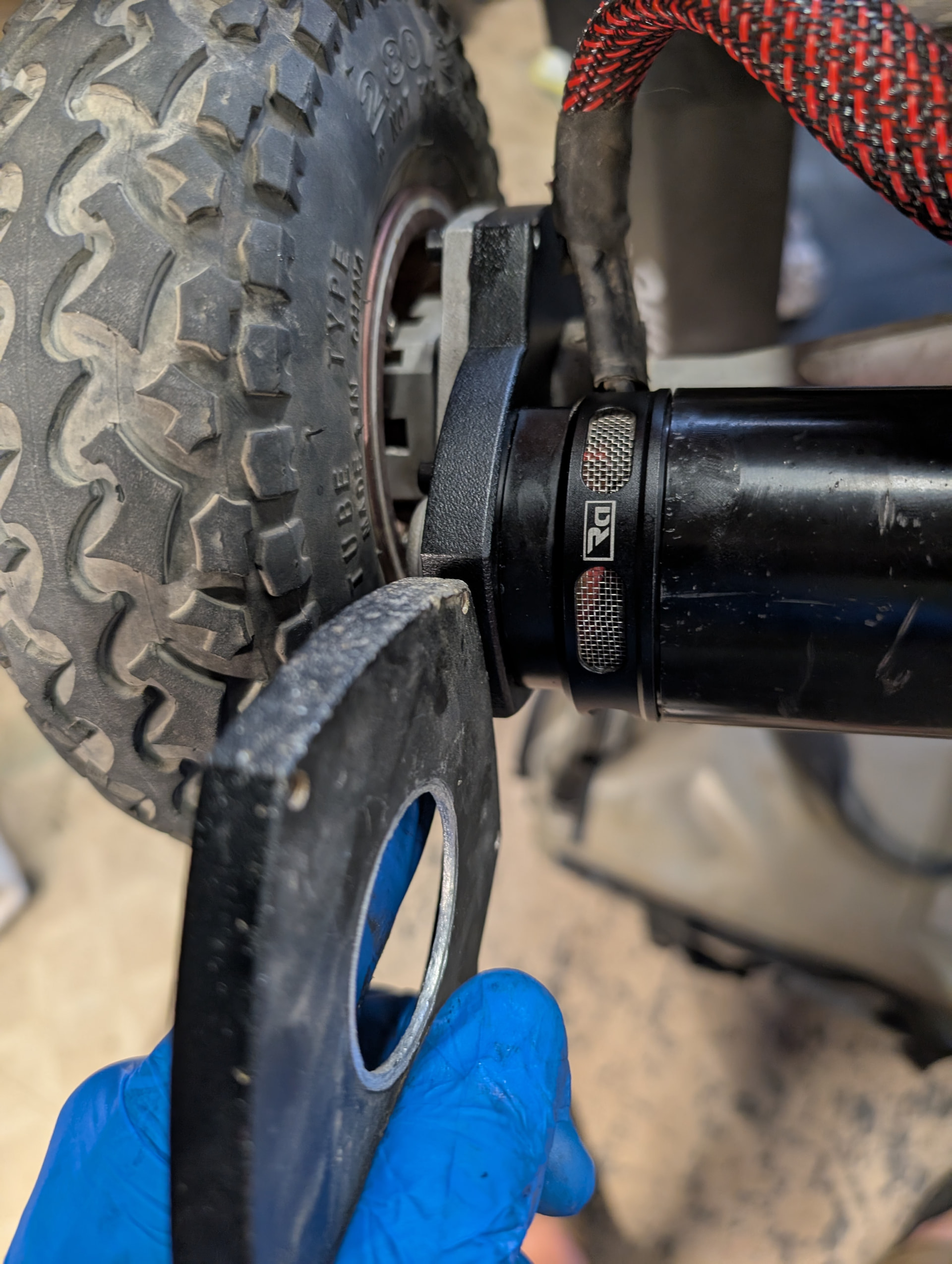

What I think is great about these drives

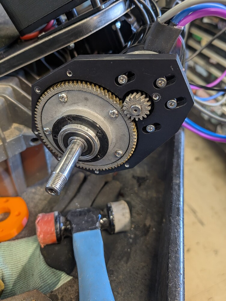

-Push fit adapters for hubs, easy flat fix if you carry a full spare. No hardware needed.
-Herringbones! Theses are a bitch to have machined, but effortlessly produced with SLM. Fuck axial thrust!
-Push fit adapter from hanger mount to gear housing. Eliminate some hardware and it make it easy to remove the entire drive from the truck to service it if you want to. Just might have to cut a couple tie wraps.
-Already mentioned, but zero unobtanium.
-Low profile. They hug the wheel and take minimal abuse. Guards will eventually be designed and printed just for fun.

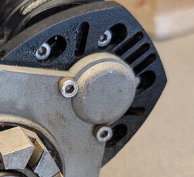

-Backlash is adjustable without opening the gear housing cover. Could be handy after a hard housing bash.

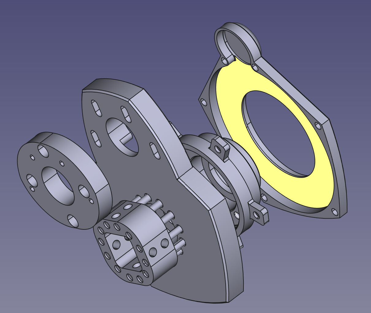

Current state of project (Including Files)
Description of Where I’m at

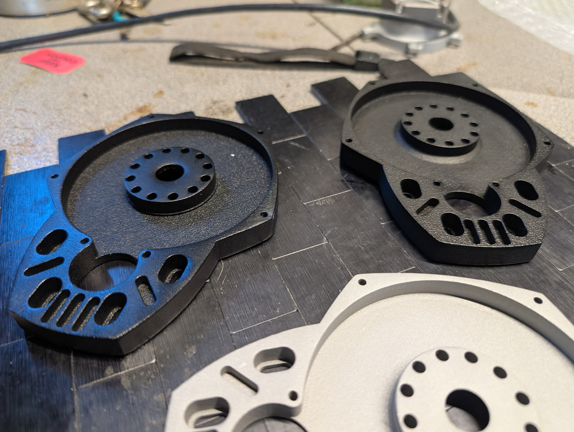

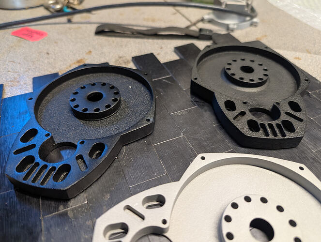

Since the back wall failed on the last set, I’ve printed three different solutions.
WE ARE NOT TESTING THESE BECAUSE THEY ARE JUST TOO HEAVY First and easiest, bottom right. Only thing that changed is material. SLM 6061 to SLM M300 Maraging Steel. I’ll be surprised if these break but they’re heavy as fuck, weighing 335 grams apiece, and that’s just the gear housing itself.
MATT IS TESTING THESE AS OF 10-24-26 Top Left, It’s the same drive, with the back wall thickness increased from 2mm to 4mm. Printed in 6061, then hardened and anodized. Weight - 156g This might be good enough.

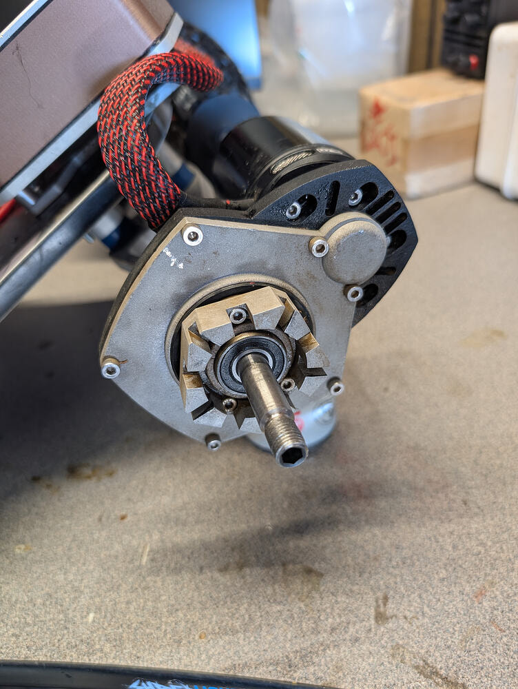

I AM CURRENTLY TESTING THIS VERSION AS OF 8-15-26 Top right, fat chamfer under the bearing stop and back wall increased to 4mm. Also printed in 6061, then hardened and anodized. Weight - 160g. I’m really rooting for this one
We’ll do our best to break them and post updates. It’s nice having two testers.

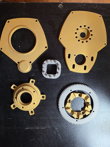

STEP
STEP files for the gears aren’t listed here. I can probably find them. Same with the push fit hub adapters. They are all listed in the STL file drop down. M300 Maraging Steel Parts are gears and truck adapters (other than option 1)
Option One All steel version printed with M300 Maraging Steel (have them tap everything for you)
Beer Drives Remastered All Steel PUSH FIT VERSION.step (1.3 MB)
Option two, only change is reinforced back wall to 4mm. Print in 6061 aluminum, hardened. Anodize what you want to. USE GEAR ADAPTER FROM OPTION 1
Beer Drives Remastered PUSH FIT VERSION.FCStd (1.3 MB)
Option three, gear housings have chamfer on bearing catch and back wall thickness increased to 4mm. Print in 6061 aluminum, hardened. Anodize what you want to. USE GEAR ADAPTER FROM OPTION 1
Beer Drives Remastered PUSH FIT VERSION 12mm Height Bearing Chamfer.step (1.0 MB)
STL (and FreeCad Files for the Gears)
Another note, rotary shaft seals are being used to seal the gear adapter where it protrudes from the cover. I’m not convinced that they are worth the money. I would suggest just printing a TPU seal. Will get around to making the file when everything is ironed out.
Gear Housing option one, everything the same, but hear housing is printed in M300 Maraging Steel. Have them tap for you then harden.
Beer Drives Remastered PUSH FIT VERSION FEMALE GEAR ADAPTER-Gear TubsBody.stl (1.4 MB)
Gear Housing option 2 just reinforced back wall printed in 6061 then hardened and anodized
Beer Drives Remastered PUSH FIT VERSION Gear Tubs 12mm HeightBody.stl (1.4 MB)
Gear Housing option 3 Chamfer Tubs printed in 6061 then hardened and anodized
Beer Drives Remastered PUSH FIT VERSION FEMALE GEAR ADAPTER 12mm Height Bearing Chamfer-Gear Tubs.stl (1.4 MB)
Truck Clamps for 22x22 or 20x20. The 20x20 clamps are a little tight but it doesn’t take much filing. Print them in M300 Maraging Steel and have them tap the M6 grub screw holes then harden. 704PH stainless would probably be fine too if rust is a concern.
22x22mm Version Beer Drives Remastered PUSH FIT VERSION-Truck Clamp.stl (1.4 MB)
20x20mm version Beer Drives Remastered DOUBLE DELTA SAUCE PUSH FIT VERSION-Truck Clamp.stl (1.4 MB)
Gear Adapter, printed in 6061 aluminum, hardened.
Beer Drives Remastered Gear Adapter 1mmH.stl (741.9 KB)
Gear Housing Cover 6061 or whatever you want. Nothing structural here. I’m tempted to try an ABS print after everything else is sorted.
Beer Drives Remastered Tub Cover Deeper Cuts.stl (1.1 MB)
Motor Puck - Butt crack goes toward the hanger. Printed in SLM 6061 aluminum. Ask for hardening.
Beer Drives Remastered -Motor Puck.stl (346.2 KB)
Push Fit Adapters. One is for MBS Rockstar XL, other for Trampa Phatlads. They have both been great.
Push Fit Hub Adapter 14mm H Phatlads.stl (286.4 KB)
MBS Rockstar Pro II XL Hub Push Fit Adapter (16mm Height).3mf (98.5 KB)
Gears, printed in SLM M300 Maraging Steel. Message the company ahead of time and ask if they can tap and then harden these for you. Save yourself some frustration. Shenzhen 3d will do this. Note, I haven’t used the 17t pinion version, but it’s on the bench and I don’t see why it wouldn’t work. You may need to do a bit of filing with these to get them over the motor shaft and keyway. Precision files and chainsaw sharpening files are awesome. This isn’t too hard to do and it’s better than a loose fit.

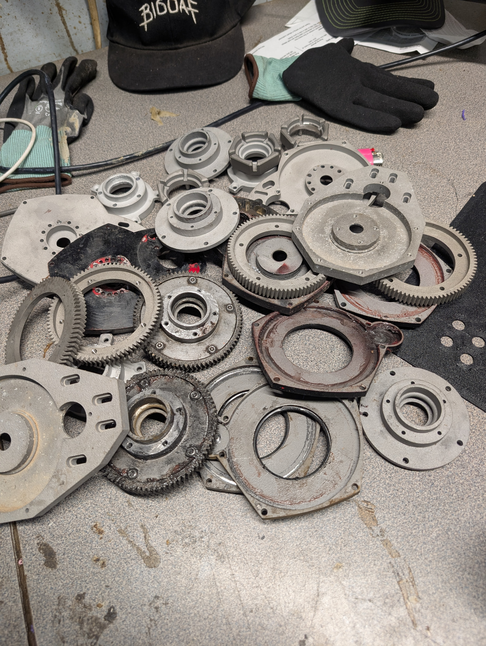

Failure Photos!
This is just a small sample of parts that were abandoned/ broken along the way. There was a 5 gallon bucket of shame building up but it was dumped in the recycle bin. I’ll add more fails as they accumulate!
I’m not there yet, but every prototype gets one step closer.

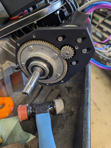

The gears themselves have been great. First set still running were put in service October 2025. The sets taken out of service were only due to housing design changes. Two sets (soon to be three) are currently retrofitted in Apex Jump Drives. Another set has been continually used to destroy the new housing designs.
The housings have been a bitch. I’m fully convinced that this can be done, but so far each failure has exposed another one to fix. I believe each of the three new prototypes will hold up but time will tell. Another rider is helping me test now which will be a huge help.

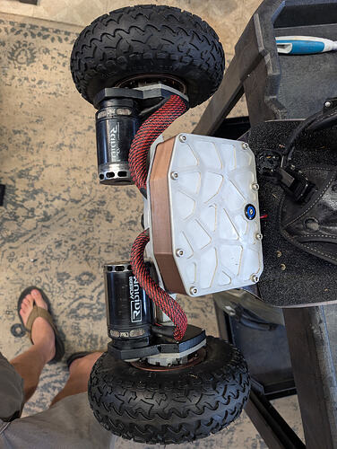

9 inch freshies :heart_eyes:
Yes! I love how the XL rims stretch them out.
